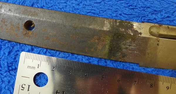

annen Posted December 7, 2014 Report Posted December 7, 2014 Hello NMB members! I’m hoping to get people’s thoughts on a blade I’ve inherited. It’s in pretty rough shape, but I am curious to learn as much as possible about it. I’m hoping to learn: - any leads on its origin (time period, school, region) - which terms correctly apply to its particulars (eg hamon), so I can be confident I’m reading the right things - whether it’s worth expending further resources on getting it examined in-person, polished properly, etc. Disclaimer: I’ve been reading the many excellent nihonto educational sites out there, but the blade is in poor condition and as a novice it’s hard to know when a given term applies just from online reading. So what follows might be laughably wrong, and I apologize in advance for any wrong uses of terms or confusions on my part. I appreciate the regulars of this forum being willing to share knowledge with absolute beginners. Here’s my best brief description of it, would welcome any comments or corrections if I’m wildly off. I'll post pictures below, and I will be visiting the house where the sword is later in the day so can get a few more pictures or measurements if that would be helpful. Blade: Measurements (all approximate) - Nagasa: 71cm / 28” - Sori: 2.5cm / 1.25” - Moto haba: 2.9cm - Saki haba: 2.2cm - Moto gasane: 8mm - Saki gasane: 5mm - Kissaki: 4.5cm - Shape: Shinogi zukuri, torii-zori (I think) - Mune: Iori-mune - Horimono: Bo-hi; maru-dome; forward end of hi is a rounded point (not sure of term for this shape) extending past the yokote (hisaki-agari) - Kissaki: O-kissaki? or “elongated chu”? It is about twice as long as it is wide. - Boshi: Not sure. Base of boshi is visible but turn-back is hard to see - see pics - Hamon: Not sure. Irregular wavy with some tiny islands or ghosts floating just above it at points (maybe gunome midare or some notare? toranha with choji? I am grasping at straws here.) - see pics - Hada: Really not sure! Hard to see because blade is scratched. At least at a handful of points it seems to be irregular wavy (maybe itame/mokume?) but more uniform "sparkles" are visible elsewhere. Nakago: - Length: 8.25” - Markings: Mumei, no date, no stamp, no markings that I could see - Mekugi-ana: One - Yasurime: Kiri (I think, maybe with some diagonal marks just under the habachi?) - Overall shape: Futsu - End shape: Kurijiri or Ha-agari kurijiri (rounded asymmetric) Koshirae The (buke zukuri) koshirae are all but destroyed - the saya is split, the tsuka has lost its wrap, and the tsuba, mekugi, menuki, kashira, and more are missing. But I’ll describe the remaining pieces in case they might offer some clues: - Habaki: One piece, copper-colored with dark and lighter color variations. It is worn smooth, but there are faint remnants of diagonal hatch marks on both sides (and some horizontal marks), plus a thin gold line on one side. - Saya: Wood, with black matte stipple-textured painted/lacquer exterior (ishime?); one empty rectangular space for kurikata. The bottom section of saya is wrapped in fabric and tape for protection, so I haven’t checked whether the kojiri is present. No other hardware or cord. - Koiguichi: Dark material (horn?) with black shiny (lacquer?) exterior coating, no ornamentation; detached from saya mouth. - Fuchi: Plain dark metal with matte uniform dot pattern (nanako shakudo), no ornamentation; front face has gold painted rim around copper-colored center; no markings on the inside - Seppa: One remains, copper-colored, with rough crosshatch file marks covering one side - Cord: Flat black cord, of braided fabric (silk?), is tied haphazardly around the tsuka to hold it together - not clear if tsuka-ito or sageo; has small metal clip (under 1 cm square) on cord at one point - Same: White, wrapped in the “channeled” style (i.e., not full wrap) Provenance We believe it was given to my great-grandfather, who was an American metallurgist and engineer who developed steel alloys for the auto industry. It would probably have been given to him sometime between 1910 and the 1930s, definitely no later than 1939. We have records of his doing experiments involving “Japanese ores” in the 1920s, so possibly a gift stemming from his buying ores or corresponding with someone in Japan about steel. We don’t think he ever traveled to Japan himself. So, after all that, I’m interested to hear any thoughts people here may have, about this sword's features or possible origin, and about whether it’s worth pursuing more examination/polishing/etc. Pictures to follow. Thank you! -Anne Quote
annen Posted December 7, 2014 Author Report Posted December 7, 2014 Some close-ups of the blade. Quote

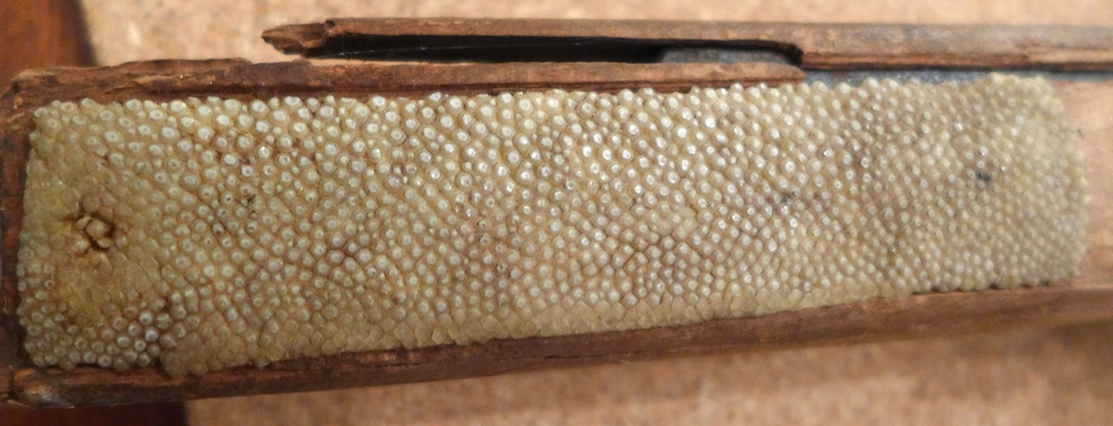

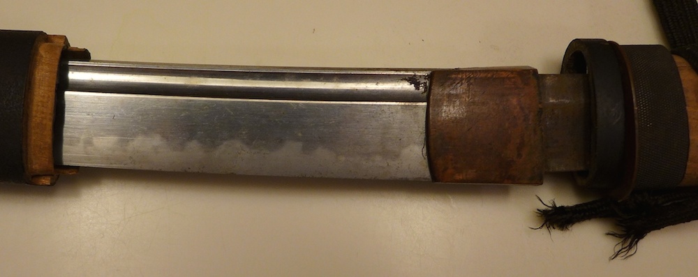

Brian Posted December 7, 2014 Report Posted December 7, 2014 Anne, Not nearly as bad condition as you make out. This one is far from terrible, and looks to be a very nice piece indeed. Ignoring the koshirae of course, and focussing on the blade, as is correct generally. Judging by the nice hamon and shape, and well cut groove, I think you have a decent sword there. Also, the quality of the remaining fuchi and especially the nanako quality makes me think this was a prized sword at one time. I think this is a definite candidate for restoration. At least needs to be checked out by someone, and a polish considered. It won't be cheap, but since the initial outlay was minimal, I would consider it if it were mine. Brian Quote
hxv Posted December 7, 2014 Report Posted December 7, 2014 I agree with Brian: nice sword in good condition. From the look of it, I am guessing shinshinto, made in the style of koto period. Regards, Hoanh Quote
annen Posted December 7, 2014 Author Report Posted December 7, 2014 Thank you both so much! I've only been researching this for a month or so, but I've grown fond of the sword so am very pleased to hear it seems like a piece worth further effort. If anyone has any other thoughts I'm all ears. Quote
Gunome Posted December 7, 2014 Report Posted December 7, 2014 Hello Your sword looks very interesting. Looks like a bizen koto. Koshirae is damaged, but blade seem healthy. Quote
leo Posted December 7, 2014 Report Posted December 7, 2014 Hi, I can only confirm the previous posts: blade shoud be polished and submitted to shinsa. It looks like a shinshinto remake of a Koto- Bizen Nanbokucho- period sword, like Omiya-school. Restoration of this koshirae will require some effort. I would stick with a shirasaya, but this is a personal decision. Best, Martin Quote
Jean Posted December 7, 2014 Report Posted December 7, 2014 Sebastien, Check the picture titled "mune side of the tang" and the Yasurime. Check the hamachi and see how crisp it is. Not older than late Shinshinto and perhap Meiji, taking into account the story of this blade. Very good candidate for polish Koto Bizen utsushi ( copy of Koto Bizen blade). As I use to say, it is my personal opinion and I share it with myself (but I could be wrong ) BTW Anne, very good pictures, all that were needed are there Quote
cabowen Posted December 7, 2014 Report Posted December 7, 2014 I agree with the above. This was a nice blade and koshirae. It is in desperate need of restoration in its present state. The blade reminds me of work by the Koyama Munetsugu group from the Shinshinto period. Please take good care of it... Quote
