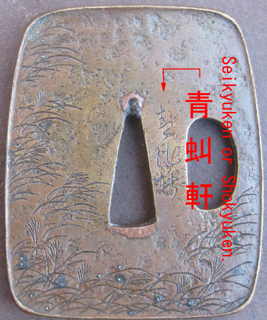

With a great deal of hope I tacked my first ‘grass’ script mei
Armed with my copy of Sesko’s Cursive script I tried to make some sense of this mei. After a couple of hours I found 吉 (Yoshi) which looks like the first character
The second may be 刀
The third maybe something like 孝
None of which makes any sense to me
So then went through all the mei starting with Yoshi in the Haynes Index but found nothing
I wasn’t sure of the three character mei. I know some smiths do have three characters but normally the third character would be something like carved, made etc
Ideally if some one can give me a few pointers so I can try to find these characters in Sesko’s book, maybe a couple of radicals?
Also on the same tsuba do you think the ‘holes’ on the moon are intentional/poor workmanship or general wear and tear?
The last tsuba was my recent purchase for Mariusz and although the chest handles are obvious has anyone any idea what the other sukashi represents
All I see is a sea horses head!!!
With thanks
Grev UK

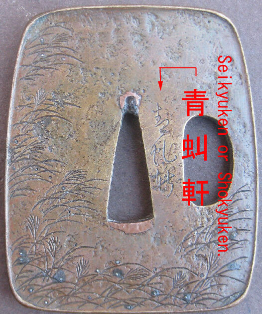

Your decipherment of the cursive script is completely wrong. ;)
Cursive script of the tsuba says 青 虯 軒 (Seikyuken/Shokyuken),this is an art name "Go".
虯 reads "mizuchi",same as 蛟

Anyone have any thoughts on the possible damage to the moon and the shape of the last tsuba image

As you will see that with Morita’s kept I found out the following
No 01 8strokes 青 SEI – SHŌ
青 Radical: 青 Parts: 二亠土月青
青 8 strokes - Sesko page 341
No 02 8 strokes 虯 KYU (mizuchi)
虯 Radical: 虫
Not found in Sesko’s book or in the Haynes Index
No 03 10 strokes 軒 KEN
軒 Radical: 車 Parts: 干車
軒 Radical: 車 7 strokes – Sesko page 321
From Morita:
Cursive script of the tsuba says 青 虯 軒 Seikyuken or Shokyuken is an art name "Go"
I can not find any makers in Haynes for the two variations of mei
Can anyone help me to track down this maker?
Also if the second character is in Sesko’s book which page is it on?
For me this is a good learning exercise
Grev UK
