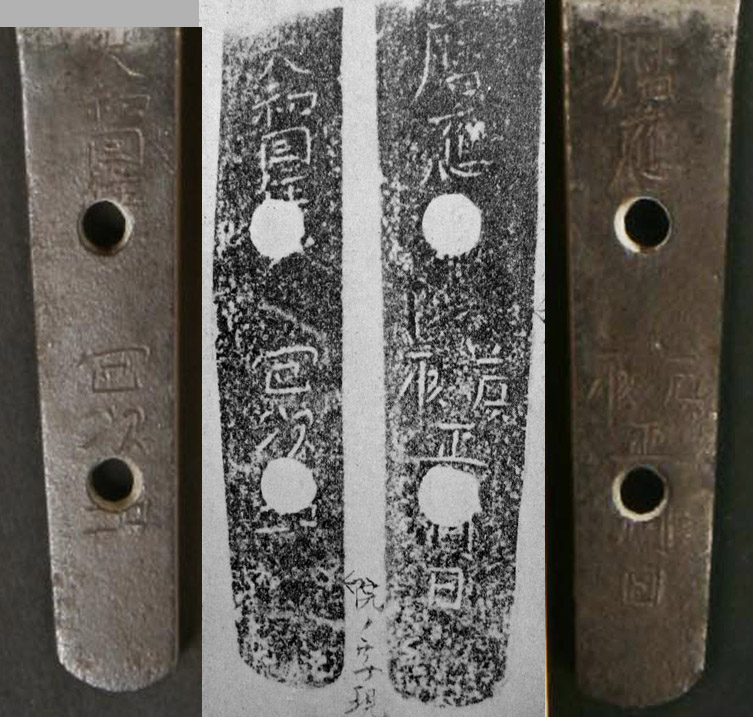

Christian Chaffee Posted December 12, 2014 Author Report Posted December 12, 2014 Hi Hamfish, I never said it was a missing treasure. I just said I have a tanto, and an oshigata of it's tang was found in a book published on Japanese swords in 1935... which is all true. Until I have a complete translation, I don't know exactly what the book says. This will be known soon, and I'll post it here. If you do not see any similarity between the oshigata and the tang on my tanto....... look again, as no two sword tangs are alike. Christian Quote
Dr Fox Posted December 12, 2014 Report Posted December 12, 2014 Christian Chaffee said: If you do not see any similarity between the oshigata and the tang on my tanto....... look again, as no two sword tangs are alike. Christian Christian With all due respects, and I need help here, because I think I must be wrong! Before your post above, I was actually for a comparison learning doing just that a 'comparison'. And I could not convince myself, that the mei on the two examples did exactly match. Also has a camera angle changed the nakagojiri? Put me right please someone. Quote
NihontoSeeker Posted December 12, 2014 Report Posted December 12, 2014 Those are to different to be the same. Reuben Quote
Robert Mormile Posted December 12, 2014 Report Posted December 12, 2014 All: I believe they are the same sword. Oshigata are never an exact replications of the nakago. Paper often shifts slightly when oshigata are being created and depending on how each of the angles of the edges are certain areas can be diminished or accentuated. Look closely at some of the rust spots and pock marks on various areas of the nakago. (if I had time now I would modify the photo myself but…) there are significant correlations in these areas. Also, as the size of the oshigata and photo are slightly different there is sort of an optical illusion. Definitely the same blade. Robert Quote
Brian Posted December 12, 2014 Report Posted December 12, 2014 I agree with Robert. Unless the signer copied that exact oshigata, it is the same blade imho. Variances due to pressure, paper movement, oversizing the ana etc etc. Brian Quote
leo Posted December 12, 2014 Report Posted December 12, 2014 Definitely the same blade. Due to the technique of that time the 2 oshigata images do not have the same size and proportion. The left image is warped, too. Then oshigata always look mor 2-dimensional than a photo, the ana look larger etc. I adapted the photos to the different sizes of the oshigata which should make it clear to everybody. Best, Martin Quote
Jean Posted December 12, 2014 Report Posted December 12, 2014 Robert, It is possible but in this case it is one of the worst published oshigata I have seen. Seems that the blade has switched on left side. A picture of the ura side would be welcome as the Oshigata seems correctly drawn. Edit to add Martin, You should explain me what you mean by "due to the technique of that time...". The technique applied should have been the same on both sides. Even the kuri jiri seems wrong. Quote
leo Posted December 12, 2014 Report Posted December 12, 2014 Jean, maybe a misunderstanding. I meant the graphic equipment of the layout people/printers who obviously tried to match 2 warped and missized photos of the oshigata. No macs and no photoshop in 1929 :lol: Best Martin Quote
leo Posted December 12, 2014 Report Posted December 12, 2014 Now I found the term: The "photomontage" was unprofessional! Martin Quote

Jean Posted December 12, 2014 Report Posted December 12, 2014 Ok Martin, I understand what you meant. The photographer was far from professional. Quote

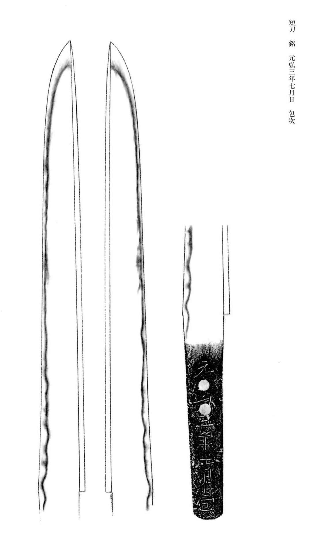

Christian Chaffee Posted December 19, 2014 Author Report Posted December 19, 2014 Hi Darcy,Chris,and Markus, Thanks for the translations of the sayagaki. The comment that it is a very rare reference piece, shows that Tanobe did recognize it as out of the ordinary, which is consistent with it being chosen to be included in the 1935 book. It goes to show... even the blind chicken finds the grain. To Darcy: You mentioned: "there are two signed Juyo that have gone to him. One is a signed and dated tanto.". How can I get images of the signed and dated tanto that went juyo, and do you know what year this was awarded? Thanks for your time, and sharing knowledge. Let me know if I can ever help you out when it comes to California and American art. Christian Quote
Darcy Posted December 19, 2014 Report Posted December 19, 2014 It passed in Juyo session 40. It's interesting in that the signature seems to come after the date on the same side. The tanto is very slightly suriage and the bottom bit of the tsugu is cut off. Or so it looks to me, I think the setsumei says it is ubu though. So maybe he has just scrunched the last character in. Quote
