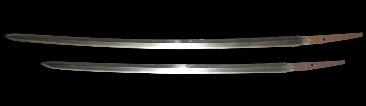

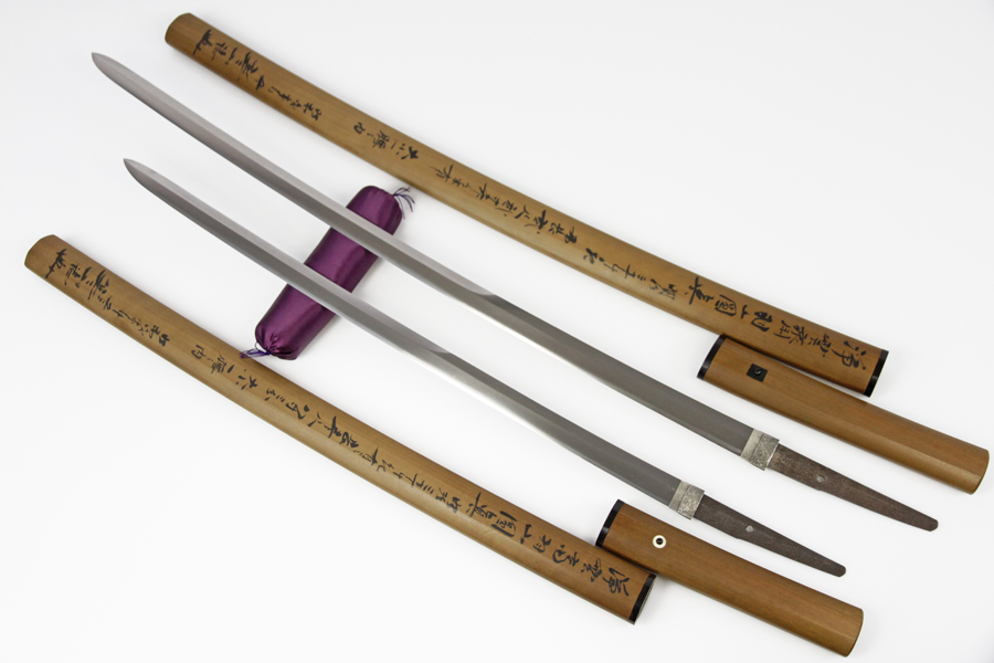

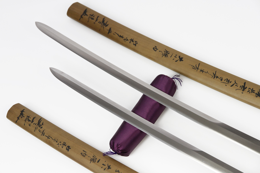

Nickupero Posted November 30, 2014 Report Posted November 30, 2014 Just got my hands on a Dai-Sho from Hayama Enshin, both are dated 1898 AD, full mei is Jōunsai Hayama Enshin Kore o Tsukuru. Started taking some pictures and I'm very intrigued by this set. Meiji work and later is not my area of focus on so I can't say I've had many examples in the past. I know Enshin liked to make these style swords but how rare would a Dai-Sho set be? Was this common work for him? I understand that this would fall between the middle of his career, right? Any more info or comments about his smith are welcome. Dai: 66.7 cm Sho: 55.5 cm Quote
cabowen Posted December 1, 2014 Report Posted December 1, 2014 Hayama Enshin worked in that grey area right after the Haito Rei. He was one of a few smiths that kept the craft going despite limited demand and very severe financial hardship. He is known for his use of western steel and his tight, almost awataguchi-like hada. He made mostly archaic shaped swords. These two are done in perhaps his most commonly made sugata. He had a few students, and there is a nidai I believe. His work is very distinctive, usually muji with suguha hamon done in an archaic sugata. He is said to have been from the Koyama Munetsugu Suzuki Masao group and his early work is similar to the work of that group, that is, Soden-Bizen. See here http://www.tsuruginoya.com/mn1_3/a00089.html for an example... edit: correction made.... Quote

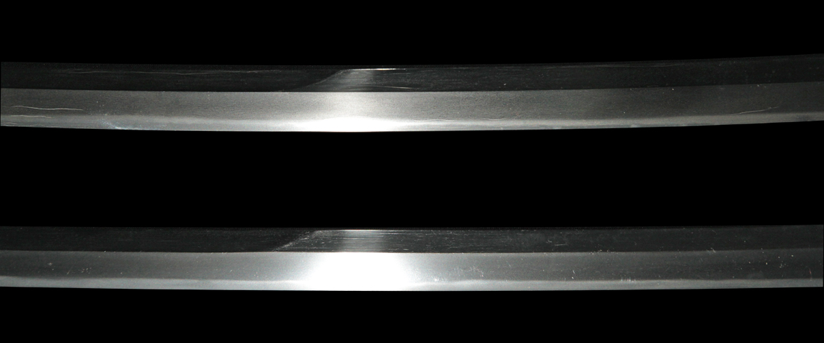

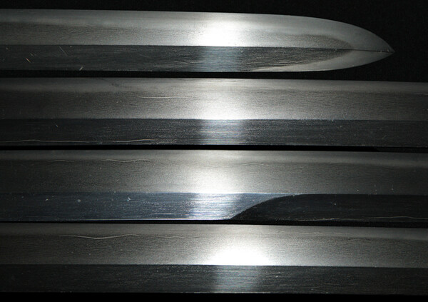

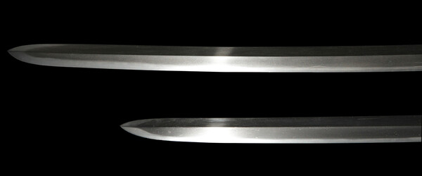

Ken-Hawaii Posted December 1, 2014 Report Posted December 1, 2014 Nick, are my eyes crossed from too much pre-holiday cheer, or do these blades not have yokote or kissaki? Ken Quote
Tcat Posted December 1, 2014 Report Posted December 1, 2014 Very interesting pair of blades Nick, thanks for sharing. The joke has been cracked before but one wouldn't want to start messing around doing iai with these forgetting what they are and what they are noto.. Quote or do these blades not have yokote or kissaki? Ken, no yokote on moroha zukuri aka kogarasu maru zukuri blades that I have seen. I wonder if one has ever been made with a "ken" style yokote... You raise a good "point" though. Perhaps someone can enlighten me as to where the kissaki technically begins on such a blade. (enough puns for the day I think...) Quote

Brian Posted December 1, 2014 Report Posted December 1, 2014 What a beautiful pair, love the shape. The "Kogarasu Maru" style is one of the more stunning ones imho. First pair I have seen and would love to see more pics of the workmanship and features. Brian Quote
Geraint Posted December 1, 2014 Report Posted December 1, 2014 Wow! Nick I love these, what a treat to see them. I love the nakago sugata. I'm sure you have already seen this but here is a tanto by him. http://www.kanshoan.com/english/swords/h46_enshin.html All the best Quote
Eric H Posted December 1, 2014 Report Posted December 1, 2014 His roots go back to the Kiyomaro school, a peculiarity is his nakago in kijimomo shape. UK Sword Register No. 51 Eric UK SR, No. 51.pdfFetching info... Quote
Fuuten Posted December 1, 2014 Report Posted December 1, 2014 Wow thank you for showing. They really fit nicely together. Quote

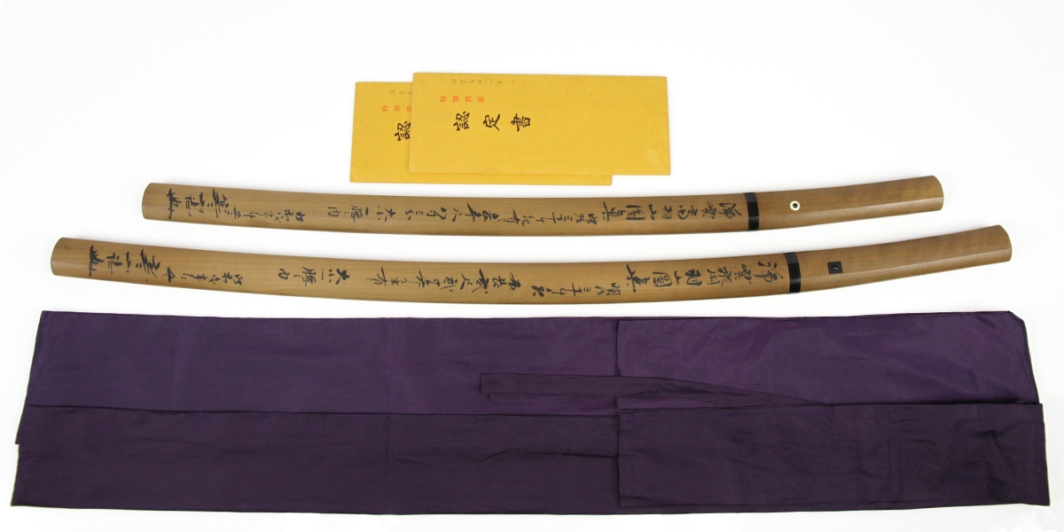

Darcy Posted December 1, 2014 Report Posted December 1, 2014 Very interesting swords, I have not seen a wakizashi in this shape before either. One thing of note that joins up with previous daisho discussions here is that the swords would appear to be an assembled daisho on the part of some collector sometime in the past. The shirasaya are made a bit differently, and the papers are numbered one apart in sequence. This would seem to imply that the owner submitted them at the same time and they did not receive daisho token papers but came back papered individually. Regardless, an interesting and unusual set. Quote

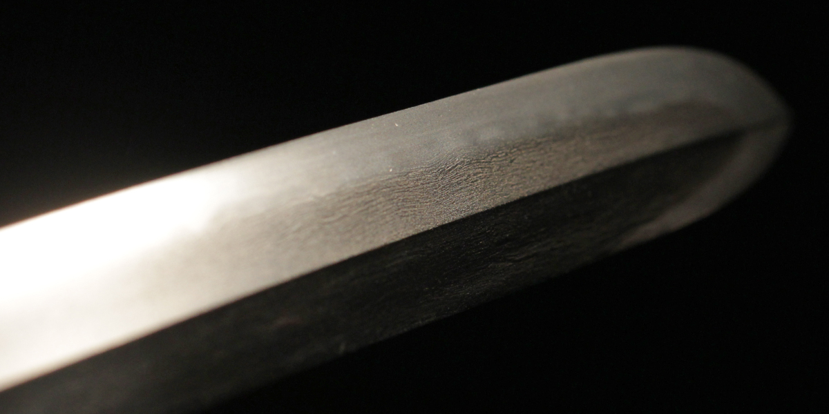

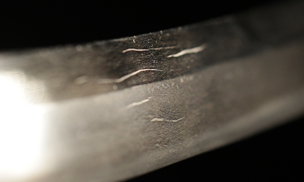

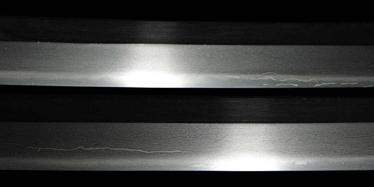

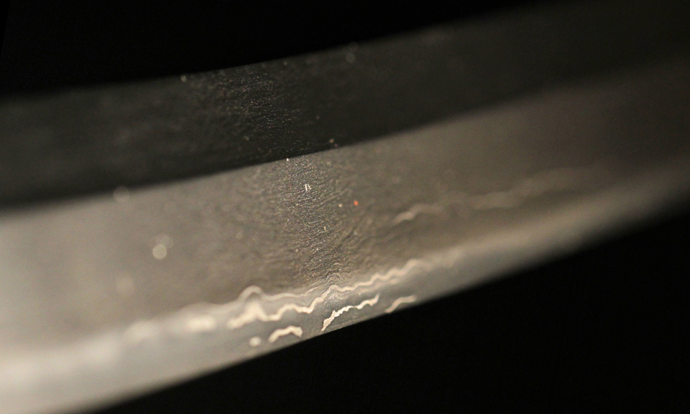

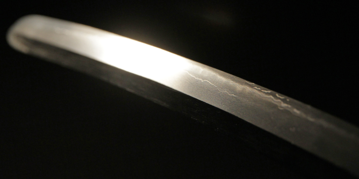

Nickupero Posted December 2, 2014 Author Report Posted December 2, 2014 Wow a lot of comments, thank you for everyone who gave their input. Thank you Chris and Eric for the info regarding Enshin. Darcy raises a good point, and I think its an interesting situation, both blades are extremely similar but are dated 9 months apart in 1898AD, maybe commissioned by the same owner at a later date, maybe not? The Shirasaya's look darn close aside from the horn around the mekuhi-ana (forget the name), I had a look close up and I have to say there might be a chance that the Dai received the new rectangular finishing (I've had those white round ones crack and fall off), the reason I say this is under close observation there is an air gap when looking inside the hole where the deeper white horn could have previously existed, maybe its me being overly optimistic. Under popular demand here are some more pictures of the blade, some very interesting hataraki don't mistake it for Kizu, both very healthy pieces. Quote

seattle1 Posted December 2, 2014 Report Posted December 2, 2014 Hello: While Hayama Enshin is best known for his Awataguchi-like jihada, from the most recent posts of these swords it seems that the utsushi model for the jihada was Yamato. That would be more in keeping with the general sugata of the swords, given its Yamato derivation. Interesting pair indeed. Arnold F. Quote
