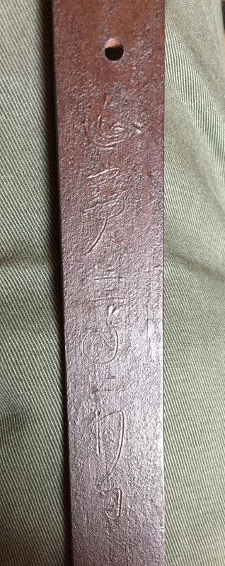

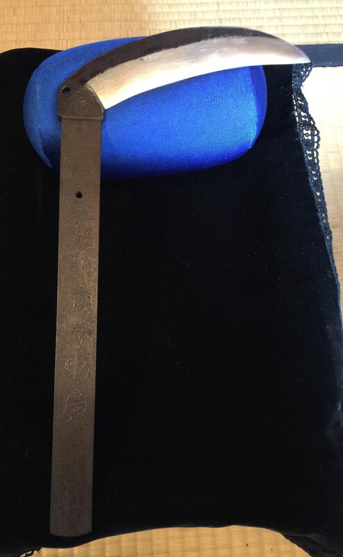

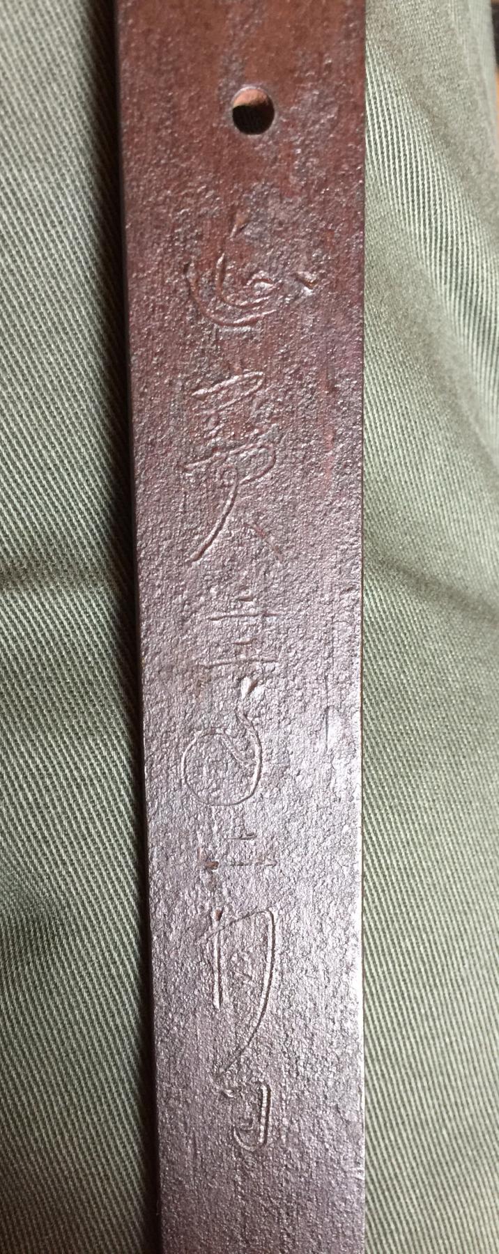

Bugyotsuji Posted May 20, 2017 Author Report Posted May 20, 2017 Quick update on today's sickle. It has been giving me a tingle all day, from the moment I set eyes on it. There was a bit of a bidding war, but I think people could see I was going to ride this one wherever it took me. Follow the inspiration! Hit the books this evening, and after nearly three hours of cross-checking it looks like 津田越前の守助廣 延宝二二年二月日 (can't find the spoiler option), which is much earlier Shinto than I was expecting. The final key will be to make sure it is not gimei, ie to see if the hataraki and Mei are typical of his work, in others' opinions. He started using flowery rounded script at the beginning of Enpo. I have checked against Fujishiro and the signature looks good for the date, so it's either fine as is, or a very good forgery. But since the Japanese don't treat Kama seriously, why would someone bother to fake such a Mei? Sounds like I am trying to convince myself? Just trying to keep all options open! Who, me, prejudiced? 4 Quote

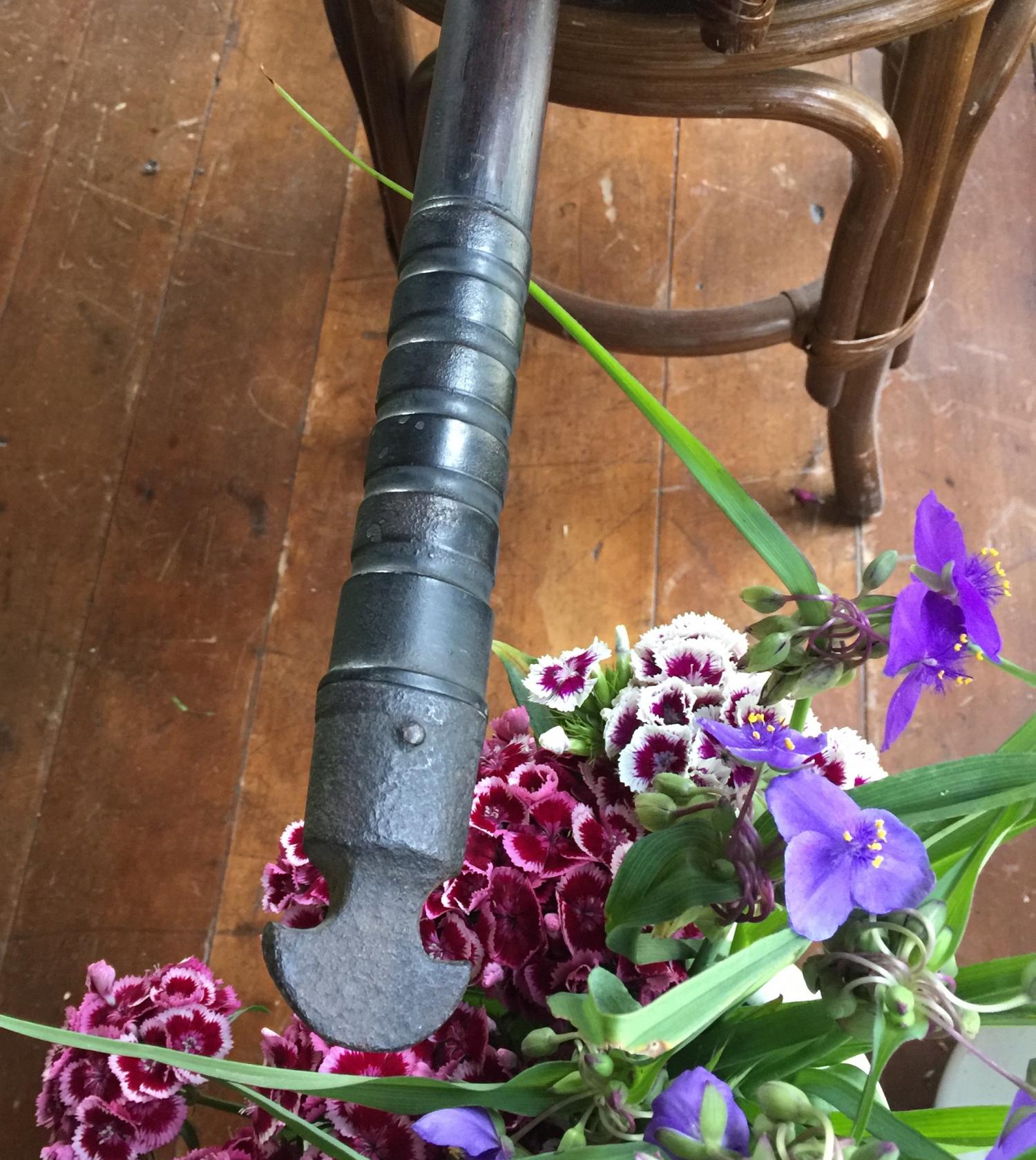

Bugyotsuji Posted May 21, 2017 Author Report Posted May 21, 2017 Overall 164cm. Blade edge 11cm, (14cm front to back). Red lacquer saya, and iron ishizuki. Pole and fittings all slim elliptical in cross-section. 2 Quote
Bugyotsuji Posted May 21, 2017 Author Report Posted May 21, 2017 The saya is kept on with a mekugi through the hole in the back of the blade. There is a further proper mekugi through the haft and nakago. 2 Quote
Bugyotsuji Posted May 21, 2017 Author Report Posted May 21, 2017 The blade itself polished below the shinogi line is in need of some TLC but it has several areas of interest in it. 2 Quote
Bugyotsuji Posted May 21, 2017 Author Report Posted May 21, 2017 Finally the Mei. Not for the faint hearted, and not easy to get the shots. Quote
Brian Posted May 21, 2017 Report Posted May 21, 2017 Damn, that is nice Piers! Congrats. Clearly well made and nicely mounted. Unusual too. I would consider a polish if I were you...would be stunning in full polish and probably not break the bank? 1 Quote

Bugyotsuji Posted May 22, 2017 Author Report Posted May 22, 2017 One source says this prolific smith made 1,700 swords in his working life; the big Meikan quotes rumours of 1,670. The latter number (as a date) coincides roughly with the early Edo period (Enpo) when he was active, but he only lived to 45 years of age. Even starting at 15 he would have had to have made more than 50 blades a year... ie one a week for 30 years; how could this be? At the age of 38 he switched styles of Mei, starting a rounded form that someone had taught him. That was in Enpo 3. This kama is dated Enpo 4, so at 39 yrs old, and within a year of initiating his famous squiggly script. Six years before his death. From overwork? Talking of squiggles, there is one at the top of each side of the nakago. Pre-pre-Raphaelite, avant garde-ish... Known as the Yokozuna of the West, he ranked with Kotetsu in fame. Toramba clashing waves hamon were said to have been invented by him. Can we see any examples in this little blade, I wonder? Quote
