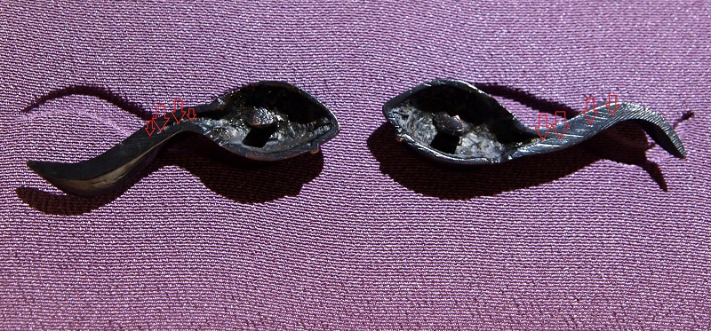

I don't expect you will agree with me. I am just saying what I see. There is especially one construction detail which determines the making method. It was already mentioned, but it would look differently if it was formed from a sheet of metal.
I don't want to argue with anybody. But if these pieces will go to shinsa and will be returned back with the same conclusion, then should be documented that somebody said it.

I agree with Kevin would love to read a rationale for the cast reproduction call. I was thinking the tails were solid shakudo but I can see the seam between the layers of the shakudo plate used to make the menuki once Ford pointed it out correcting me. I am also not looking for a flight only a educational exchange of ideas to advance everyone understanding of kinko tosogu. Having Mike Y. take a look at Tampa show would be a good idea before they are submitted for NBTHK shinsa. :)
I personally think those are the same pair. Even finishing filing marks are the same. You are of course entitled to your opinion, but it is better given with detailed explanations. I am sure (and hope) that Ford will give his too.

I am sorry if you don't see it, but to teach such experienced NMB squad how to look at menuki construction seems to me be inadequate according my humble experience.

I can't agree more with Brian. If someone can provide conclusive evidence via good quaily photos with some type of written explaination in terms of logical reasoning I will change my current mindset. Roman is unwilling to provide this so I opening up discussion for other people to reply.
Am I missing an additional set of photos? I don't see any other menuki provided for comparison, maybe it's something on my end.
I think the best "evidence" for this discussion is well- and evenly-lit macro photography of the underside of these menuki. If we can find the elusive "line" along the tail that shows how the metal is pushed together in the uchidashi technique, we should have our answer. EDIT: Sorry David, I just went back in the discussion and noticed that you found it. Any chance you can capture it in a photo?
Frankly though, I think there is enough structure present to confirm this as-is, and these are certainly better-made than typical repro menuki. As always though, it's a challenge to make assertions like with only photographs on the internet and no in-hand examination. :)
When I look at a 400% image of the backside of these menuki there are some very telling characteristics. I see no seam, I seen certain edges that are rounded and spelter in crevasses. What does this indicate? John
I believe Roman was referring to David's comment that the tails were solid. As this initial misapprehension has now been corrected and David has confirmed that the tails are in fact formed out of sheet metal squashed together, as I described, perhaps Roman would care to reasses his position.

Home from work I don't collect menuki as my day job nor do I make them. :badgrin: Here is a photo in a bit higher resolution 800 X 373 showing the seam highlighted by red arrows (tips pointing at the seam line) from the sheet of shakudo being hammered in to fill the volume of the tail. It is clearer on one menuki then the other because of lighting issues. The back surface was then filed by the artist in a horizontal direction. Ford has in the passed commented that this filing of the back surface of the menuki is done in a horizontal direction as part of the finishing process to make the back side flat this is done before the pins are added as the final step.
When I look at a 400% image of the backside of these menuki there are some very telling characteristics. I seen certain edges that are rounded and spelter in crevasses.
I am a bit concerned you are magnifying such a scaled down image. When I export them from the RAW format to JPEG I scale them down to 640 X 299 resolution from a full resolution of 3813 X 1782 after cropping so that they fit well on the screen when posting. Some of what you are seeing is I am sure an artifact such as noise and distortions from the extreme magnification. No edges are rounded at all on the backside of the menuke. It is flat as all menuki I have seen. All you are seeing with "spelter" is noise or a reflections of light from the glossy but rough shakudo surface of the inside surface of the menuki. The inside surface of the menuki are rough because they are not polish as the surface of menuki are which was an attempt by the artist to replicate the texture of tadpole skin which looks smooth.
