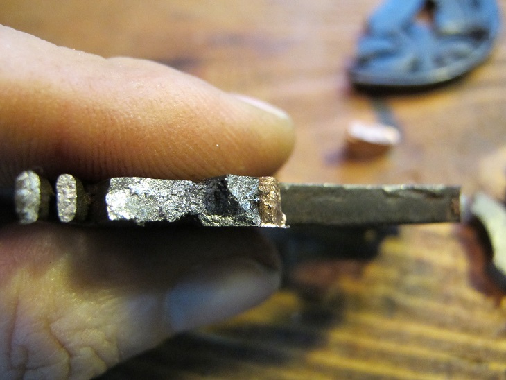

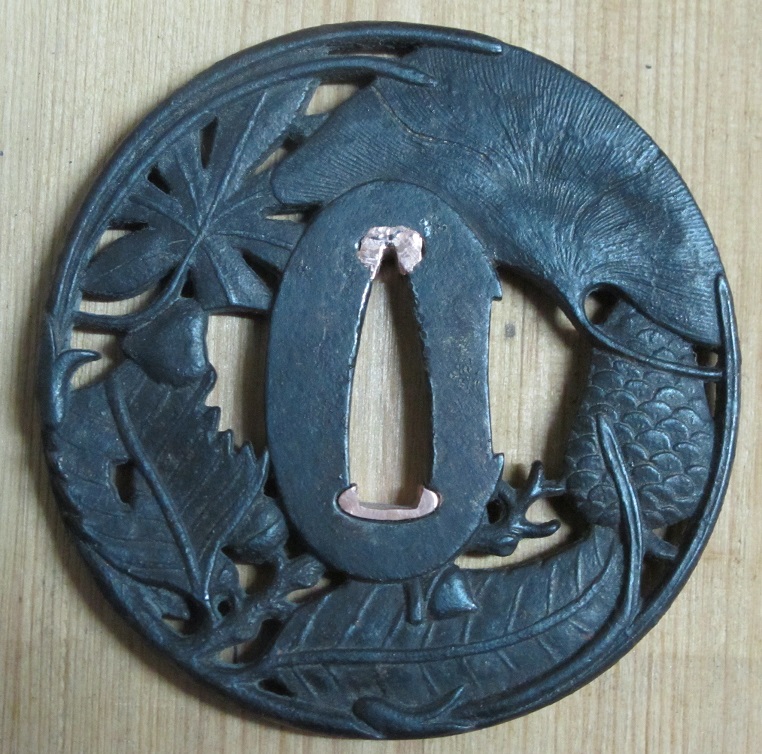

Obviously, your call on what you do with it but I'll post these pictures of mine that show the problems with cast tsuba.
This one was an obvious cast that I broke with a single, light hit with a hammer.
This one was part of a daisho set that a friend bought on ebay. In the pictures, they looked good.
In hand, I thought them cast but they were finished very well with no casting flashes anywhere. I was asked to add sekigane to them so I warned him that they might not survive. One survived, one burst apart when I started to peen the copper sekigane into place. As you can see, the grain size in the broken piece is very large, hence very brittle.
The 'survivor' -
The 'splitter'(for Monty Python fans) -
That said, I have a modern cast tsuba that withstood some serious abuse with a hammer and is solid.
Modern cast steel will take the punishment needed to be a useable tsuba.
Telling the difference without a destructive hammer test?
That's the question...
Interesting pics Lee, and very informative.
Yes, that tsuba is cast, and modern. Not a good one...I would look for a replacement that fits.
