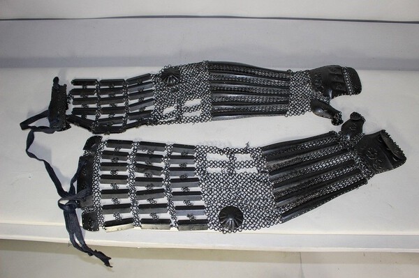

falconj Posted September 29, 2014 Report Posted September 29, 2014 hi all, there is a small area of light rust that has developed on the fine chain mail on one of the sleeve guards from a suit of armour I have, this could possibly from being stored incorrectly. To try to contain this, should I ( after taking steps to the protecting of the fabric under and beside the chain mail ) spray or brush on some form of rust removal or rust preventative the likes of "CRC" or similar to the effected area? any advice welcome thanks regards John Quote
kusunokimasahige Posted September 29, 2014 Report Posted September 29, 2014 It is probably due to the demise of urushi lacquer on the small rings of the chainmail. Do you have a picture of it ? In Roman re-enactment, with chainmail which is not painted, we regularly put a chainmail in a plastic bag filled with coarse building sand and then start shaking the bag for a considerable time. It gets rid of the rust and afterwards we shake the sand off and oil it. This however would not be advisable with Japanese mail of course. The best thing to do is to remove the chain mail from the fabric of the Kote sleeves first. Be sure to have photos or drawings of the attachment points so you can restitch the mail back in place. (Now whether you would want to do this on an original Edo period suit of armor is another thing altogether). When the mail of the Kote is removed, you try brushing away all active rust with a soft to medium brush so as not to damage the lacquer coat remaining. Then you can still oil it lightly but be sure not to overdo it because oil of course can stain the brocade of the sleeves or if they are made from hemp cloth that fabric. What really should be done is relaquering the chainmail (at least the parts where the lacquer is gone). But that can (in my opinion if you use Urushi) only be done by an armor restorer like for instance Dave Thatcher who is a member here. Alsi Ian Bottomley could help with information in this case. Hope that helps ! KM Here is an image of a modern piece of removed armor which only needs to be reattached to a sleeve (the same goes in general for Haidate and Suneate) : Quote
IanB Posted September 29, 2014 Report Posted September 29, 2014 John, I really don't think you should take the metalwork off the iyeji - that involves taking off the lining to sewn the metalwork back and then the hassle of resewing the lining. Far simpler is obtain a short-haired stencil brush and gently brush off as much loose rust as you can, being careful not to break any stitching or rubbing the fabric - especially if it is silk (hemp is far more robust). Hold a piece of gauze or netting tightly down over the area and then use the smallest nozzle of a vacuum cleaner to suck off any residual rust. Finally using the same brush, apply an inert wax such as microcystalline wax to the mail, again being careful about the stitches and fabric. It should look a heck of a lot better and should inhibit any further rusting. Ian Bottomley 1 Quote

falconj Posted October 1, 2014 Author Report Posted October 1, 2014 sorry about the slow reply people, and many thanks for the info you have posted, but I have only just been able to take some photo's of the rusty areas , hope the photos are good enough regards John Quote
IanB Posted October 1, 2014 Report Posted October 1, 2014 John, That doesn't look too bad. Good brushing and waxing will make that look ten times better. Nice quality mail by the way. Ian Bottomley Quote
falconj Posted October 1, 2014 Author Report Posted October 1, 2014 thanks Ian and all, so maybe a toothbrush or similar and a vacuum cleaner on the go at the same time sucking any rust, gunk away? regards John Quote
