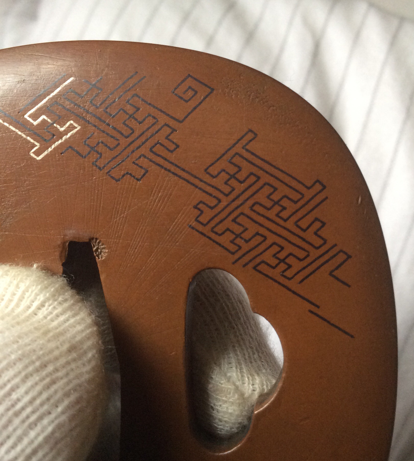

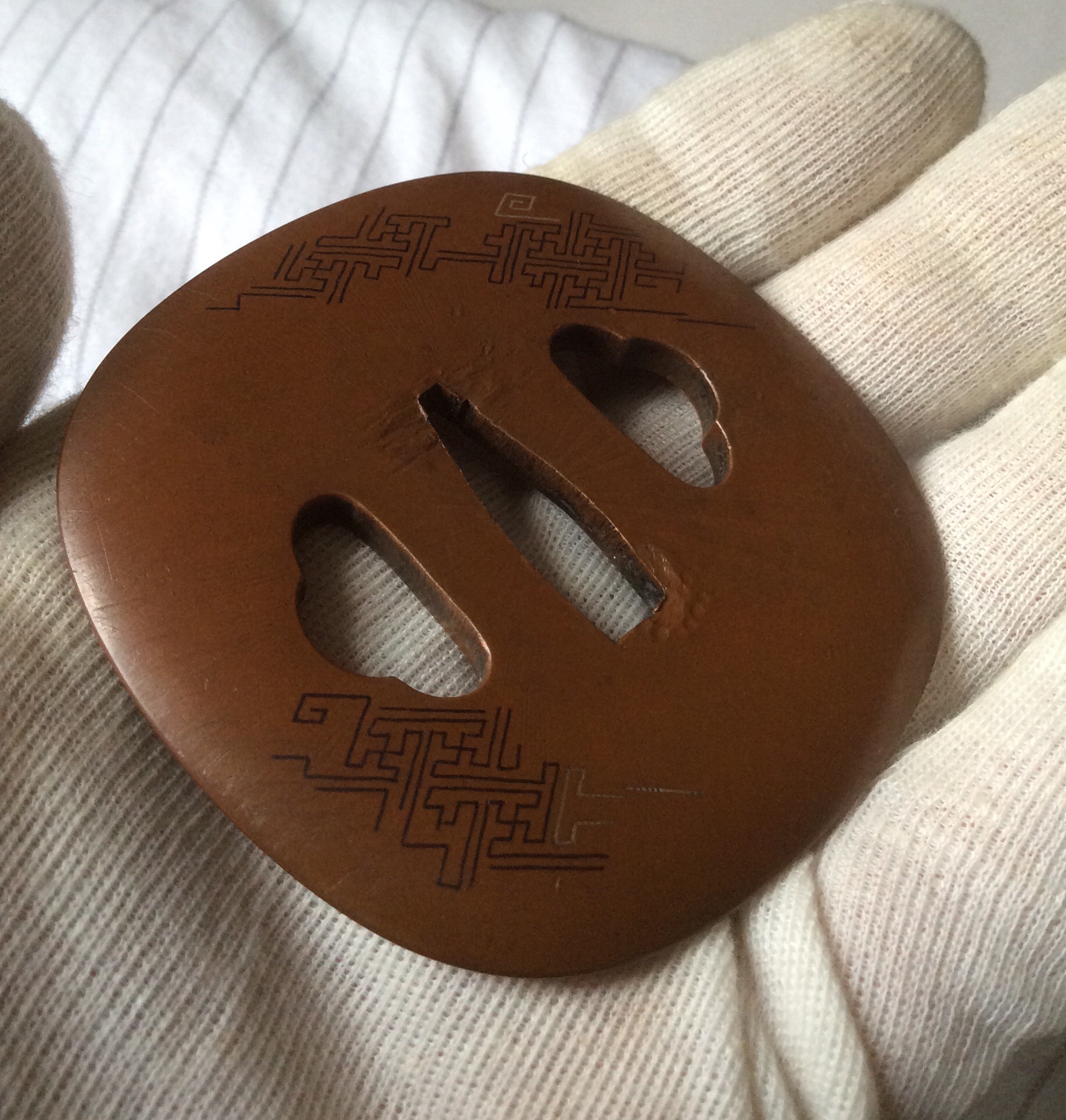

Thought yesterdays kantei was good fun and thought Id add one of my own.
This one is distinctly go stone in profile (thicker in the middle) and in addition to its shakudo and silver inlay has finely carved amida yasuri.
Its 7cm high x 6.9cm wide x 0.48cm thick at the centre.
Let me know your thoughts or questions
Kind regards
Michael

Only one person nailed it - Higo Nishigaki more specifically the second master Shigesaku (1639-1717) The very tastefully placed inlaid pattern is called Sayagata, a crest design originally found on silk. This example shows some wear and would most likely have been originally fitted with a shakudo fukurin.
The second master also studied under the Goto school and his work is often very refined. Unfortunately my photos do not do it justice as the amida yasuri are very finely carved.
The aori gata shape and the matching hitsu ana are more typically Higo in style.
