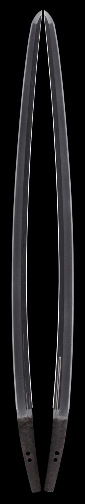

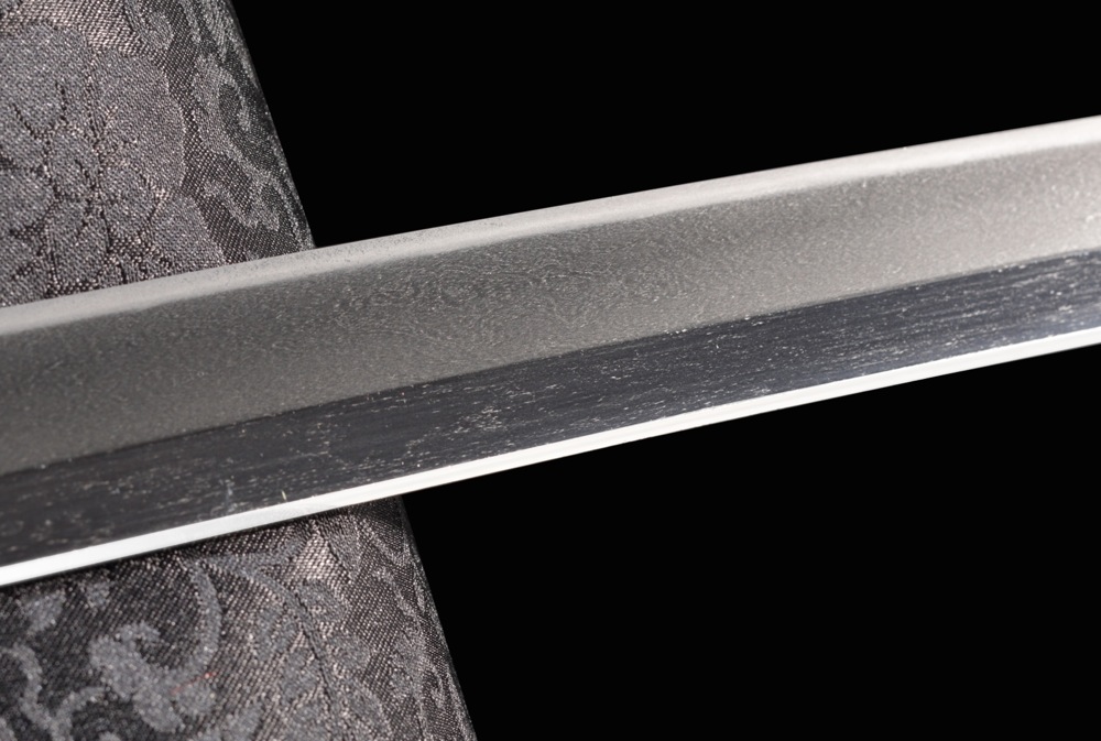

Marius Posted September 24, 2014 Report Posted September 24, 2014 Gentlemen, I haven't researched this subject yet, but I want to get my starting points here. Kodachi - these were comparatively short swords worn edge down like regular tachi. That much is sure. Questions are: - what was their purpose? - were they worn by fighting men? - were they worn by courtiers? - how long/thick/boad were they? I ask these questions because I am lucky enough to own a kodachi (and no, it is not a shortened tachi) attributed to Chikushi Ryokai. An excellent Yamashiro sword, BTW. The sugata is delicate, almost diminutive, and graceful. The blade is very slender, but seems not tired. It appaears almost ubu, with some minor machi okuri. It has nashiji hada, utsuri and a hamon in ko-nie (suguha). Pictures are attached. What is your opinion about kodachi (not necessarily this sword)? I will try to take some pics in which this delicate sword is next to an ordinary daito. Thanks for your time :-) Quote

Marius Posted September 25, 2014 Author Report Posted September 25, 2014 Jean, Thank you :-) I have done it, but the only thing in this discussion that I have found meaningful (regarding the term kodachi) was Guido's statement: "A Kodachi is kind of a scaled down Tachi." I seem to remember that the opposite opinion was brought forward on another occasion Of course I know that it is difficult to determine what a kodachi was, exactly. The name suggests a small tachi, i.e. a sword worn edge down. But are there any sources which confirm that short, diminutive tachi were worn, too, perhaps in civilian/court life? Regarding my blade, its measurements are: Nagasa: 56.8 cm (1 shaku 8 sun 7 bu 4 rin), sori: 1.3 cm (4 bu 2 rin), motohaba: (width at base) : 2.43cm sakihaba (thickness at top) : 1.39 cm This is a very slender sword. Quote

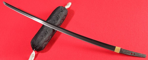

Eric H Posted September 25, 2014 Report Posted September 25, 2014 "A Kodachi is kind of a scaled down Tachi." Quote

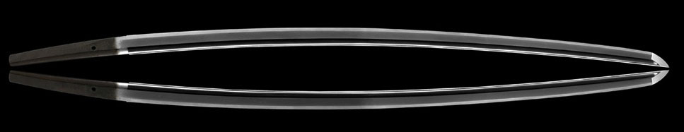

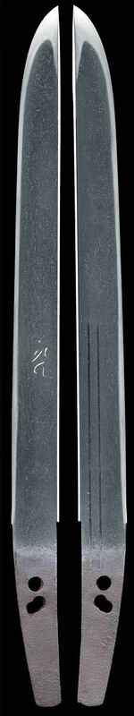

Marius Posted September 25, 2014 Author Report Posted September 25, 2014 Thank you Guido and Eric, this is very kind of you Looking at this sword, I was thinking - an extremely carefully made sword for a courtier. It is so short and light, that it wouldn't have been cumbersome to use wither in the palace or in the ox-cart. NBTHK's attribution is Chikushi Ryokai, so it would be Nambokucho (or later), provided that the NBTHK is correct (not for me to judge, of course)... It is a Yamashiro tradition blade, for sure. Very slender, elegant and with very good steel (loads of ji-nie, etc). Eric - this pic is great, thanks :-) Attached is a picture which shows the hada and utsuri on this sword. Quote

Marius Posted September 25, 2014 Author Report Posted September 25, 2014 Ian, very interesting, thank you :-) Yes, diminutive is the word, but also refined. I can obviously speak only about the blade, as the sword has no koshirae. I have seen only few genpuku swords, so I cannot draw any conclusions, but yes, they were not particularly well made (not bad, but definitely not refined). This blade is very well forged, which, I hope, can be seen in the pictures. Paul, Why the NBTHK thought this sword to be Chikushi (Tsukushi) Ryokai? Probably due to the konie-deki suguha and somewhat limited hataraki (although I have to look closer to examine it in detail). I guess one should expect more activities in earlier Ryokai swords. Also I have to have a look at some oshigata of Ryokai swords. Thanks for the pic of the Norikuni. One more thing about this kodachi - the patina on the nakago is excellent and deep, neither dry nor excessively lustrous. It seems like the hi could be original to the blade - they are polished down and start in accordance with what seems the original length of the sword (my take is it is suriage and machi okuri by 4 cm at the most). The habaki is gold plated, and a very high quality work. Somene has cherishied this sword, which is not surprising, as it has the elegance of an early Kyo-mono. I may be just dreaming, of course Quote

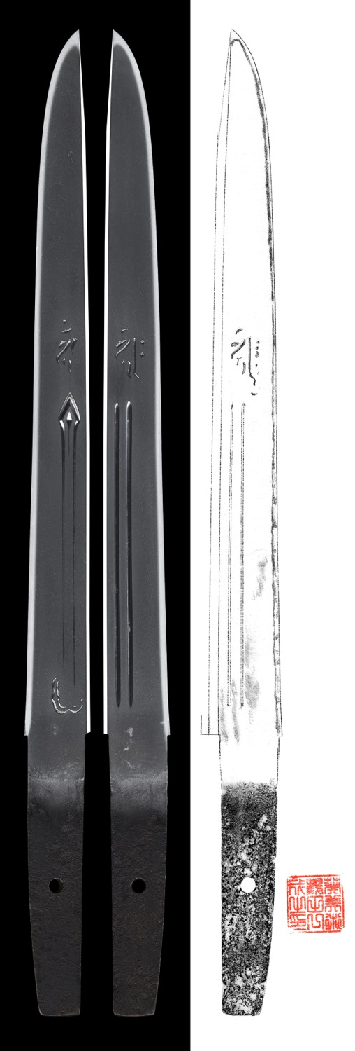

Marius Posted September 25, 2014 Author Report Posted September 25, 2014 Thank you Guido The hada on your Tsukushi Ryokai seems more pronounced (o-hada?), while it is pretty fine in my kodachi. This is of course nothing I could build upon, given my paltry knowledge, but I think it is worth noting - it seems the Tsyukushi Ryokai smiths worked in several styles. Also, there is a Ryo Hisanobu tanto on Aoi, here is the link, and I am attaching a picture too, as these links do not last: http://www.aoijapan.com/tanto-mumei-unsigned(ryo-hisanobu) Quote

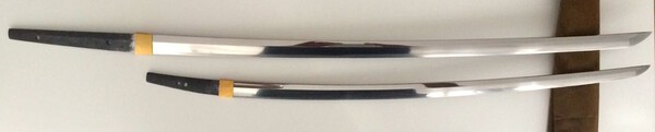

Marius Posted September 25, 2014 Author Report Posted September 25, 2014 Gents, Returnig to the kodachi problem... I have taken a pic of this Tsukushi Ryokai kodachi alongside an osuriage Tegai blade. The Tegai is ordinary katana size. Here are the measurements of both swords: ....................katana................kodachi nagasa:...... 69.2 cm .............. 56.8 cm sori: .......... 1.1 cm ................ 1.3 cm motohaba:. 2.95 cm .............. 2.43 cm sakihaba:... 1.97 cm .............. 1.39 cm Hopefully that will give all an idea how delicate this kodachi blade is. Quote
