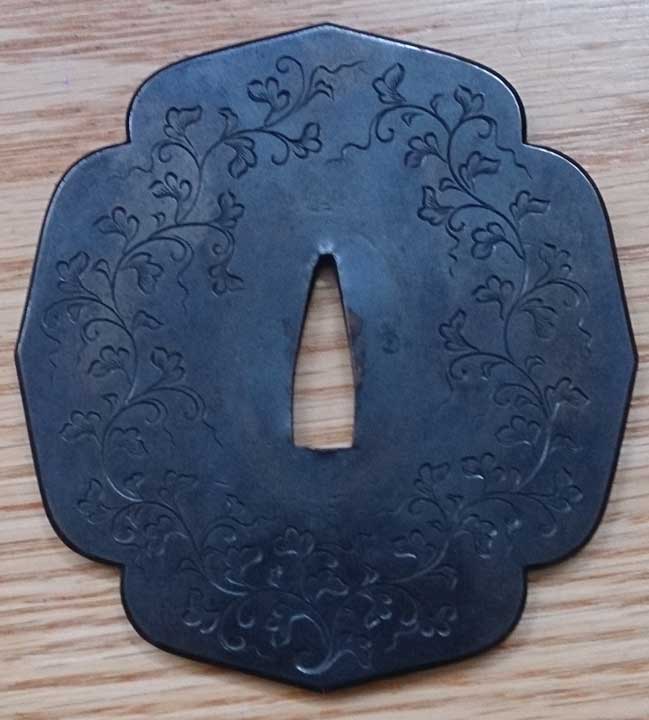

Uechi Posted September 23, 2014 Report Posted September 23, 2014 I've seen many tsuba with one Hitsu Ana either kogai or kozuka but not a lot without any holes. Is this a reflection of an older or younger generation of tsuba, hitsu ana coming later or earlier in history?. I'd be interested if anyone knows a time frame when hitsu ana became common place or the opposite when tsuba were without any if such a thing exists? Quote

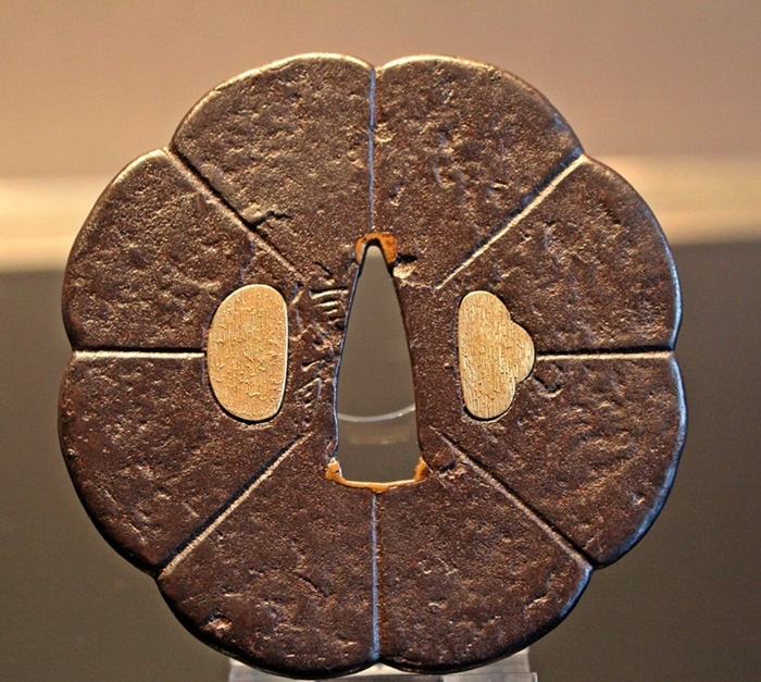

b.hennick Posted September 23, 2014 Report Posted September 23, 2014 Hi Jeffrey: Here is a shakudo tachi tsuba without any Hitsu ana: Quote

Uechi Posted September 24, 2014 Author Report Posted September 24, 2014 Bought on E-Bay would expect mid to late Edo Quote
sabi Posted September 24, 2014 Report Posted September 24, 2014 I would agree and tilt towards late. Is that a shakudo mimi i see? Quote

Uechi Posted September 24, 2014 Author Report Posted September 24, 2014 I would agree and tilt towards late. Is that a shakudo mimi i see? Yes that is Shakudo mimi Quote

Kurikata Posted September 24, 2014 Report Posted September 24, 2014 Very late Edo or Meiji..... Quote
christianmalterre Posted September 25, 2014 Report Posted September 25, 2014 also many times you do find Tsuba,which formerly had ben intended with openings... -which but got artificially replugged again.... (matter of taste,stylism and wear-especially in Edo era) (here the plugs are reset in pure gold) there´s no fix rule here in general... Christian Quote
