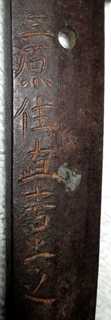

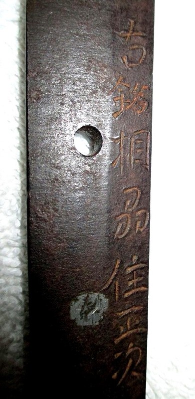

Ron STL Posted September 15, 2014 Report Posted September 15, 2014 After digging through my books, I remain confused with how this sword is signed. These photos are all I have, but they are hopefully clear enough to understand. The tachi side is clear enough: Mihara ju Naoyoshi (saku?) kore. On katana side: ko (?) Soshu (I think) ju Masatsugu. I wonder if this is a sword by the two smiths, or perhaps what I can't understand refers to Masatsugu cutting down the sword? I thought the Ko something was a town, but that doesn't seem correct. Hopefully somebody can explain what's going on here. Again, these two mei photos are all I have. No photos of the entire nakago or sword are with me. Thanks in advance, guys! Ron STL Quote
Gabriel L Posted September 15, 2014 Report Posted September 15, 2014 I can at least confirm that 刕 is a somewhat uncommon way of writing shū, so 相刕 should indeed be Sōshū. I've only ever seen this kanji used for Noshū before myself, interesting. I'm not sure that the first kanji on the sashi-omote is ko 古. To me it looks a bit more like sa 左 or similar. The left radical of the second kanji seems to be kin/kane 金 but I don't recognize the whole kanji. Will be interested to see what people dig up, I don't have the time to look further at the moment. Quote
Peter Bleed Posted September 15, 2014 Report Posted September 15, 2014 Doesn't it say "ko mei" - as in "old signature"? P Quote
Gabriel L Posted September 15, 2014 Report Posted September 15, 2014 Peter Bleed said: Doesn't it say "ko mei" - as in "old signature"?P 古銘 Looks pretty good to me! Guess my 左 interpretation was off. And this explains the overall meibun. Quote
Peter Bleed Posted September 15, 2014 Report Posted September 15, 2014 Sure!. It says that the old signature was Sho shu Masatsuge and that it was shortened by Naoyoshi. Cool! Quote
Ron STL Posted September 15, 2014 Author Report Posted September 15, 2014 Peter, you're da man! That "mei" kanji just didn't register with me, inscribed as it is on a nakago. Sounds like it could be an interesting sword. I'm expecting to see it in-hand in a day or two. Now to see who Soshu Masatsugu was... Ron STL Quote

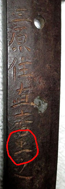

k morita Posted September 15, 2014 Report Posted September 15, 2014 Hi, Ron, I think it's a Kiritsuke mei as Jean posted. Would you take a close-up pic inside of a red circle? If a kanji in a red circle is a kaniji " 上 " , the character means cutting down/"suriage" /shortened blade. Naoyoshi shortened the blade. Quote
Ron STL Posted September 15, 2014 Author Report Posted September 15, 2014 Thanks Morita san, that exactly as the kanji is made. So I think the nakago of this sword is definitely understood now. From what I could find out from my books, neither the original smith Masatsugu or Naoyoshi, who shortened this smith were well known. Tomorrow, I will have the sword in my hands to see what quality there is in the sword. Meanwhile, I hope somebody can direct me to that earlier posting of this sword, either here or privately. That would be interesting! Ron STL Quote

John A Stuart Posted September 16, 2014 Report Posted September 16, 2014 I have a sword with the same kanji in the kiritsukemei. 於武劦江戸照吉上之 Oite Bushu Edo Teruyoshi ageru kore. John Quote
