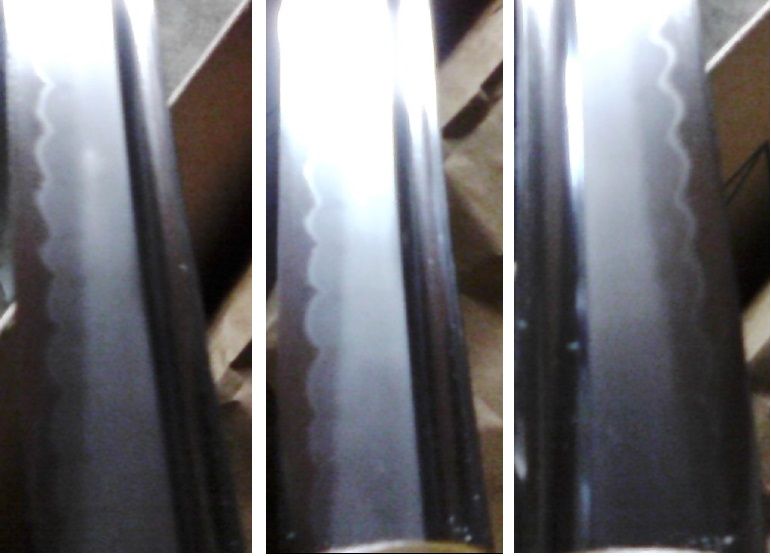

Jorgensen Posted September 9, 2014 Report Posted September 9, 2014 The other day I was presented a very beautiful 1300cth hira-zukuri katana blade in superb polish and noticed a clearly visible 45 degree line at the beginning of the hamon. Quickly remembering what I have read in several books its a sign of retempered blade and considered a fatal flaw. I told this to the owner of the blade and he pulled out Connoisseurs book from the shelves and the book support this. But - the blade is ubu and have HOZON paper and I was wondering how this is possible, if its a fatal flaw. It suddenly crossed my mind that I have seen this before when talking about utsuri and found what I have read before here: http://www.ksky.ne.jp/~sumie99/utsuri.html. After seeing this blade and the HOZON papers, I have no doubt that I think Mizukage should be (in this case) considered as Utsuri. SO - I would like to ask you - what do you think? is Mizukage signs of a retempered and a flaw - or is it Utsuri?? Quote
Mark Posted September 9, 2014 Report Posted September 9, 2014 is the blade signed or attributed? Are you sure it is ubu and not suriage? What maker/school? Some makers are known for mizukage but it is a concern. Can you post a picture of the sword in question? Quote

Jorgensen Posted September 9, 2014 Author Report Posted September 9, 2014 APOLOGIES!!! ... Not hira-zukuri... my bad - had a melt-down! Nagasa is 63 cm and has shape of Nagamaki shape without yokote. The blade is attributed to Shimada school. I have asked about it here: viewtopic.php?f=15&t=19993 I do not have more pictures than this by now. Quote

nihonto1001 Posted September 9, 2014 Report Posted September 9, 2014 Mizukage in and of itself is not a flaw. It is a condition that happens when the blade is quenched. Thus, if the blade is ubu, it may not be an indicator of saiha (retemper), which is considered a reason to not paper a sword. Though similar, I don't think it should be considered the same as utsuri. If your sword is naginata naoshi, and not drastically shortened, the mizukage may not indicate saiha. Quote

Jorgensen Posted September 9, 2014 Author Report Posted September 9, 2014 The blade may perhaps be from 1500's or 1400's. The papers dont tell. Its just the information that was given to my friend from the seller of the blade and the seller has from where he bought the blade. My intention was not to debate the school og age of this blade, but to debate that what is written in books are considering mizukage as sign of retember and as fatal flaw and others say this is wrong and consider mizukage as a kind of utsuri that is brought out at the original tempering process of the blade. Are the books misleading in this subject? So far I think yes. Quote
nagamaki - Franco Posted September 9, 2014 Report Posted September 9, 2014 By chance is this the blade http://www.nihonto.com.au/html/shimada_1.html ? Quote
Mark Posted September 9, 2014 Report Posted September 9, 2014 but to debate if a mizukage belongs on the blade or is a sign of retemper we need to identify the sword. If it were a Kunihiro or his school then it may be a kantei point for his work, same with some other groups and schools. To just say here is a sword with mizukage, is it a flaw or utsuri without knowing what we are discussing seems difficult. can you post some clear pictures of the whole sword and a close up of the mizukage so we can see what we are discussing? Quote
Darcy Posted September 9, 2014 Report Posted September 9, 2014 Mizukage is a sign of the last heat hardening (tempering). The issue is when the sword appears to be suriage but the hamon appears to be original due to mizukage. This is what causes the conclusion of it being a retemper... since you can't be suriage but also show an original hamon at the machi without the hamon being reworked. If the machi is ubu (ish) then there is no issue with mizukage. Quote
Nihonto Chicken Posted September 9, 2014 Report Posted September 9, 2014 Mizukage in and of itself is not a flaw. It is a condition that happens when the blade is quenched. Thus, if the blade is ubu, it may not be an indicator of saiha (retemper), which is considered a reason to not paper a sword. Though similar, I don't think it should be considered the same as utsuri. Just for a giggle as an aside, here are some pics of my Showa Shoshinshi Fukumoto Kumemune (same mei as on page 40 of Yumoto) showing an original mizukage, definitely not a saiha. I obtained this piece in rusty original wavy wartime polish, and, using a Lohman kit, repolished it, ironing out the waves. The finish polish wasn't quite as successful as the foundation, but was still decent enough to expose the mizukage, including an island of yubashiri on the tachi ura side (see upper end of first pic). Sorry for the poor cell phone shots, but they're good enough to show the mizukage: Note also the dark points coming off the gunome peaks, pointing toward the shinogi. I don't know that I've ever seen this before or an explanation thereof. Somewhat neat for a ho-hum Showato, eh? Quote
cabowen Posted September 10, 2014 Report Posted September 10, 2014 Mizu-kage (literally Water shadow) usually forms along the line of the air/water boundary when the sword is quenched, at the angle the blade is inserted into the water. If the blade is placed deeper into the water tank so that the air/water interface is into the nakago, then it won't be visible in the polished blade. It has nothing to do with tempering, which is a different process, called yaki-modoshi, done after the original hardening, at a much lower temperature, to primarily relieve residual stress from the quench. Mizu-kage can be a sign of saiha (rehardening) but it doesn't necessarily indicate saiha. As mentioned, some smiths are known to have a visible mizu-kage. When it is visible, you must consider it along with other characteristics to determine if it is original or due to saiha. Quote
Jorgensen Posted September 10, 2014 Author Report Posted September 10, 2014 By chance is this the blade http://www.nihonto.com.au/html/shimada_1.html ? Yes, this is actually the blade! None of us did know blade have had been for sale here in the past. The pictures are really bad though. Quote
