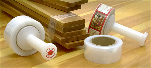

b.hennick Posted September 7, 2014 Report Posted September 7, 2014 Instead of rubber bands try pallet Tape it is a clear plastic that sticks to itself. You can make it very tight. I also use it to secure bubble wrap around a sword. Quote
cabowen Posted September 7, 2014 Report Posted September 7, 2014 That's a great tip Barry, though I wonder if once it is tight, will it continue to apply pressure or will it "creep"? It's not a very elastic material, is it???? My sayashi always made these giant rubber bands from used inner tubes. One advantage of the rubber bands is they are reusable but for a one-off, not important.... Quote
b.hennick Posted September 7, 2014 Report Posted September 7, 2014 I have used it to hold things that I have glued on many occasions without problems. It sticks to itself but is not sticky. It leaves no residue. Quote
cabowen Posted September 7, 2014 Report Posted September 7, 2014 b.hennick said: I have used it to hold things that I have glued on many occasions without problems. It sticks to itself but is not sticky. It leaves no residue. Quote
DanC Posted September 7, 2014 Report Posted September 7, 2014 For anyone confused, I am pretty sure Barry is refering to the plastic packing/shipping wrap (which is like a narrow roll of saran wrap) and not any type of box tape (which has an adhesive applied to it). In order to use packing wrap, you need to keep tension on it and stretched as you wrap it around the object, so I am not sure if it would be difficult to keep the shirasaya seams aligned while doing this. Personally, I would go with the rubber bands in a couple passes, switching ends with each band and working toward the center. Apply a few on the first pass to hold the seams in place, adjusting as needed, then apply a whole bunch on the second pass so there is as even pressure along the seams as possible. Quote

Clement Posted September 7, 2014 Author Report Posted September 7, 2014 I'm talking about cleaning the inside of a shirasaya indeed. So, in few words, one should : - steam the juncture until the glue soften - open it and clean with alcohol or file if necessary (http://www.namikawa-ltd.com/product/122) - make new rice glue following this : http://www.wikihow.com/Make-Rice-Glue - put it back together with pallet tape (saran wrap is ok ?) - how long we have to wait until the glue dries ? Do i miss something ? Quote
cabowen Posted September 7, 2014 Report Posted September 7, 2014 I don't think saran wrap is going to put the correct tension on the saya. The pallet wrap is a bit different- it has more stretch and holds the tension. The rest looks pretty good. I would give the glue a few days to completely dry, depending on the humidity. Quote
DanC Posted September 7, 2014 Report Posted September 7, 2014 Clem said: - put it back together with pallet tape (saran wrap is ok ?) Not tape, pallet wrap. Tape implies an adhesive, so using the term could be confusing to boards members not familiar with English context. I say this based on my frustration when others use Japanese terms where the context is confusing. Personally, I would still opt for a bag of elastic bands, I have a hard enough time putting saran wrap on top of a bowl. Quote

b.hennick Posted September 7, 2014 Report Posted September 7, 2014 Here is an image of the stuff I get from Lee valley Tools: Some Dollar stores sell a similar product! Quote

Clement Posted September 8, 2014 Author Report Posted September 8, 2014 I think i got the same wrap in french version : http://www.leroymerlin.fr/v3/p/produits ... aft-e26090 Thank you all for your valuable informations Quote
