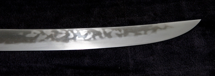

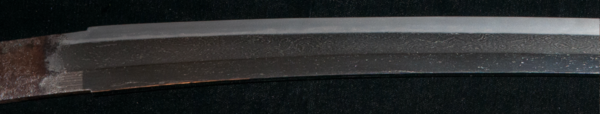

Surfson Posted February 10, 2018 Author Report Posted February 10, 2018 I am reviving this older thread since I have finally gotten around to posting some photos after polish. The blade is awaiting shinsa in Japan. The thread itself has been interesting, and went into a long debate about muneyaki and koto schools. This is the time to get your guesses in as to what school or maker it will paper to, so have at it. Cheers, Bob 5 Quote
TheGermanBastard Posted February 11, 2018 Report Posted February 11, 2018 Nice find! It polished quite well. Quote
PNSSHOGUN Posted February 11, 2018 Report Posted February 11, 2018 I will take a stab with Uda school. Quote
Kronos Posted February 11, 2018 Report Posted February 11, 2018 Is there utsuri and do you have a good photo of the boshi? It polished very nicely no matter what it papers to. Quote
Surfson Posted February 11, 2018 Author Report Posted February 11, 2018 Uda was mentioned earlier in the thread as a possibility, so you are not alone John. James, I haven't received it back yet, so I don't know. That would be nice if there is! Quote
Kronos Posted February 11, 2018 Report Posted February 11, 2018 In the absence of more info I'm going to have to agree with the NTHK and say ko-mihara dating to the end of nambokucho/oei. There's many similarities to oei bizen smiths/kozori working in an osafune- mono suguha of late kamakura like kagemitsu. However there's simply too much nagare/masame. Quote
Surfson Posted February 13, 2018 Author Report Posted February 13, 2018 Thanks James. Remember that it is over 31 inches and the mekugi ana is a full four inches from the machi, suggesting that it was mounted as a tachi. Also, the NTHK gave a call of Ko-mihara, putting it at late kamakura, early nambokucho. We shall see what the NBTHK comes up with... Quote
Kronos Posted February 13, 2018 Report Posted February 13, 2018 Yes, almost certainly a Tachi but they were still common up to Oei and while they were most common around 72-75cm from what I've seen from this era a good percentage with 78-80cm+. This papered Toshimtsu from 1399 was the first example I found but certainly over 31" before suriage. Also p162 and p384 of Markus' Koto Kantei Zenshu from a brief scroll shows a couple more though most seem to of been shortened. Ko-Mihara lasted up until the start of muromachi from what I've read so anything 1300-1400ish could be considered not having seen the NTHK papers whether they specify a date. I'm just going off other schools really as to sugata putting it later. Although I guess for ko-mihara it could just as easily be late Kamakura. Kantei from photo's is not easy unless it's a bit obvious as there's so much info gained in hand and especially suguha like this is one of the hardest imho. Did Mishina-Sensei give an opinion? As I'd trust him more than almost anyone else. Quote
