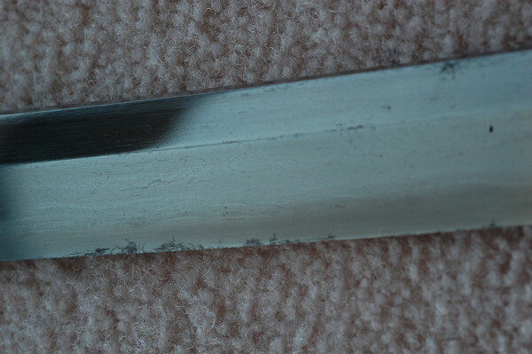

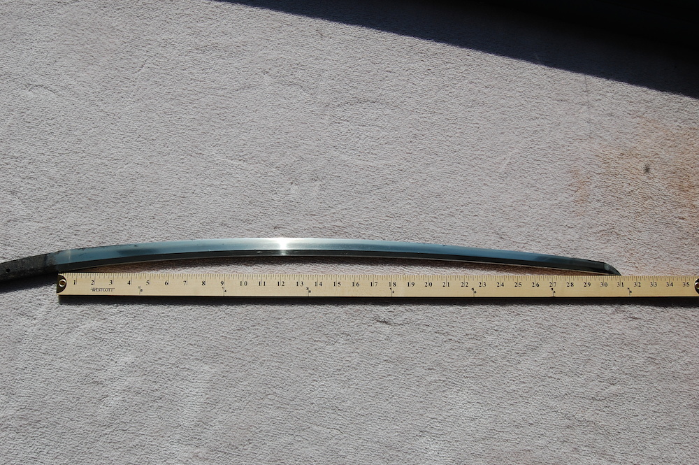

Surfson Posted September 1, 2014 Report Posted September 1, 2014 This is the other sword that I just bought. My powers of kantei, especially of old mumei blades, are not well developed; my powers of photography are even worse. So with those complete and full disclosures, here goes. The blade is mumei, appears to be ubu, has one hole and is quite long - 79.3cm/31.25". It has funbari (don't want to start up the debate about what that is - I am referring to rapid tapering of the motohaba in the first 4-6 inches of the blade). It also has significant tapering of both the kasane (thickness) and the width (from motohaba to sakihaba). It has a deep koshizori and is fairly straight in the monouchi. The hamon is what I would call notare and the hada is mokume, including in the shinogi ji. Based on the shape and condition, including significant old rust in the nakago, it looks to me like it could be a kamakura tachi. But maybe I'm just experiencing some wishful thinking here. So I would love to hear the opinions and commentary of any and all. I am posting a few of my bad photos and have many more if there are certain features you would like to see. Cheers, Bob Quote

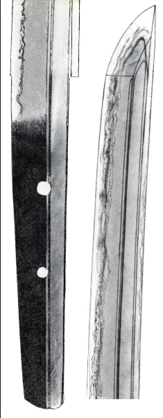

Lance Posted September 1, 2014 Report Posted September 1, 2014 Looks to be masame hada and a wide shinogi, maybe Yamato school? Below's a pic from a Yamato Hoshu school sword to compare Looks like a nice find, hope this is of some use, I'm sure someone will provide more or correct info if I'm mistaken about school. http://www.sho-shin.com/yam12.htm Regards, Lance Quote
Surfson Posted September 1, 2014 Author Report Posted September 1, 2014 It's a good suggestion, Lance. The shinogi seems to be fairly high, which I understand is a feature of Yamato blades. I couldn't take good pictures of the hamon, but there appears to be a mix of masame and mokume. Cheers, bob Quote

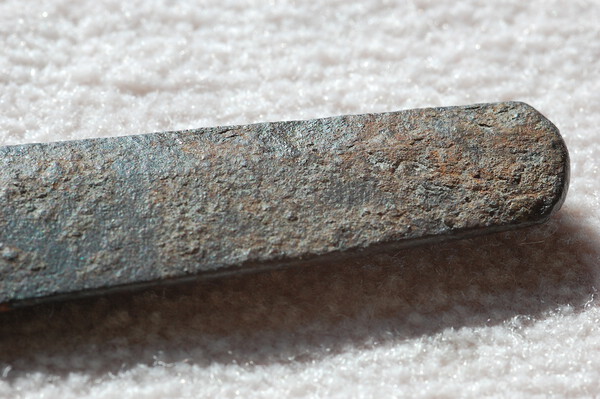

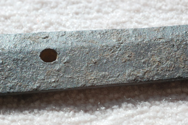

cabowen Posted September 1, 2014 Report Posted September 1, 2014 Ubu, one meguki-ana, well shaped, with an even, unpitted surface, crisp edges, etc., makes me think it isn't Kamakura old. Again, certainly there may be the exception, but in general, from what I can see in the photos, it doesn't give me the impression that it is that old. I believe there was a period in Muromachi when the older tachi style was in vogue, was it not? Of course, it could be an old Kamakura Yamato blade that sat in a temple for 700 years....Shinsa would be a good idea....I'm just throwing out impressions based on your photos...certainly not a definitive answer... Quote

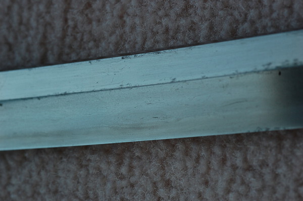

Surfson Posted September 1, 2014 Author Report Posted September 1, 2014 Well this is fun Chris. I did fully disclose my weak photography skills. Do any of these photos lead you to reconsider? Cheers, Bob Quote
cabowen Posted September 1, 2014 Report Posted September 1, 2014 No, not at all. They show a lot what looks like the type of rust that forms from high levels of humidity rather quickly, rather than the slow, deep, dark kind of rust that we see on really old blades. This rust bubbles up and has a red cast, forming a rough surface...I have a WWII Nagamitsu here that must have had the tsuka dipped in water at some point as the end of the nakago looks just like this. Look how sharp the edges and the rust are- also the mekugi-ana. Really old blades are usually worn quite smooth. Quote
Surfson Posted September 1, 2014 Author Report Posted September 1, 2014 Thanks Chris. Well, I think that shinsa may be in order before sending this one to Japan. It is very rare to find ubu koto so long, whether it's muromachi or earlier. Cheers, Bob Quote
