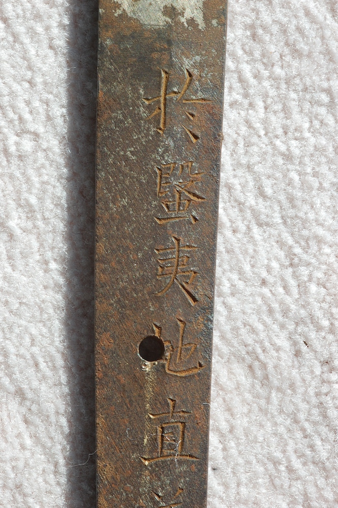

Surfson Posted August 31, 2014 Report Posted August 31, 2014 Hi All. Just bought a small collection from the daughter of the GI that brought them back. Two of the blades are of particular interest. I will post separately on the other. This one appears to be some sort of temple sword. It is very long - over 88cm/34.5". It appears to have never been polished, as the entire blade is "ububa", and I can't tell if it has a tempered edge or not. The mei is giving me some difficulty. It is signed Naoyoshi Kitau kore, and the first part of the mei seems to have a character similar to (ni) oite, but slightly different. The next three kanji might be a place, but I haven't been able to make it out. The date is Genji one I believe, or 1864. The mounts are also very interesting. The saya appears to be completely wrapped in baileen, or possibly some sort of wicker like material. The tsuba is a puffy leather over wood. To me, it seems to be a proper sword that has never been polished, but I am curious as to whether it is made in the traditional way. Any feedback on the location and or the sword would be greatly appreciated. Cheers, Bob Quote
cabowen Posted August 31, 2014 Report Posted August 31, 2014 Normally the mei is not cut until after the edge is hardened but it wouldn't surprise me if it was made for some type of offering, kabuki, or other such use, that it might not be hardened. I would bet it is hardened but I know of one other large blade (2"+ wide, wakizashi) signed by a Sukesada that was never hardened and probably made for display or some other non-use... Very interesting sword though...There are two shinshinto Naoyoshi in the Meikan. One from Dewa, one from Mikawa. Quote
k morita Posted August 31, 2014 Report Posted August 31, 2014 Great find!! Oh,rare sword made in Ezo (now day Hokkaido prefecture) ,late Edo period.(This sword is not Ainu sword.) mei is Naoyoshi. Maybe Naotane school. Quote
cabowen Posted August 31, 2014 Report Posted August 31, 2014 The MIkawa smith moved to Hokkaido late in life. He was from the Naotane group. Quote
Surfson Posted August 31, 2014 Author Report Posted August 31, 2014 Thanks to both Chris and Morita senseis. Morita Sensei, do you think that this sword is worthy of restoration? I can't tell if it has been tempered, but to my eye it looks very well forged and finished. Also, can you please translate the upper kanji? The fourth one looks to me like Chi from Chika and the first one looks like a strange version of ni oite. The third one looks like hina or hira or ebisu (in Koop and Inada). Unfortunately, I can't put the first four kanji together. Is it a place in Ezo? Cheers, Bob Quote

k morita Posted September 1, 2014 Report Posted September 1, 2014 The MIkawa smith moved to Hokkaido late in life. He was from the Naotane group. Chris, Exactly! you are right. Robert, Ezochi means Hokkaido prefecture. Quote

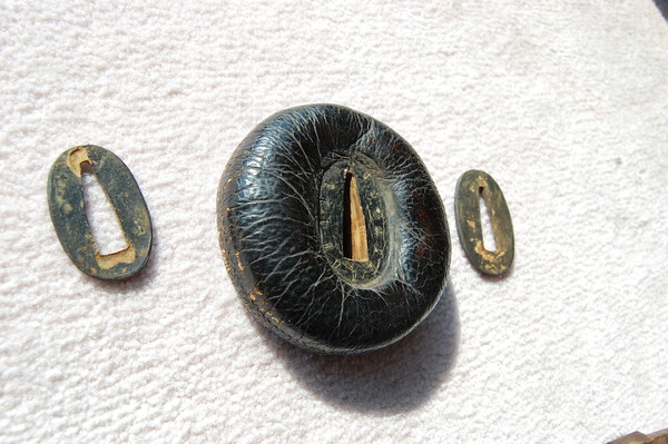

Baka Gaijin Posted September 2, 2014 Report Posted September 2, 2014 Good morning Thomas., My feeling is that this is a really rare example of a practical training Koshirae. I was first thinking something like Tennen Rishin Ryu or full on Jigen Ryu. I noticed particularly the ferrule reinforcement at the area from Kurikata to Koiguchi. Then because of the leather padding on a wooden tsuba, I wondered if it was primarily a receiving sword. The striking sword being a Bokuto. Which kind of shoots my Jigen Ryu theory down as the concept of blocking is anathema. Perhaps one of the Itto ryu variations? Hokushin Itto Ryu could be a contender as that was known from Aizu and Northwards. Could it have been owned by one of the Shinsengumi Bad Boys gone North? The last statement was a shameless attempt at obtaining a Manga/Anime Otaku 101 credit..... Back to rationality, we know from the writings of Tesshu Yamaoka, Uyeshiba Morihei and Takeda Sokaku that specialised training weapons such as extra heavy Bokuto for Tanren training or Iron bars for So-Jutsu were used: I'd like to see more pictures of the entire Koshirae. Cheers Quote

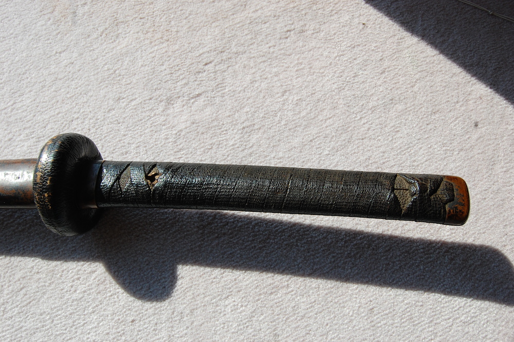

Surfson Posted September 3, 2014 Author Report Posted September 3, 2014 I am enjoying this discussion, because it is going into an area in which I am naive. Malcolm, here are a few that I already took. Let me know additional features that would be informative. It's interesting to me that it doesn't have a kurikata, indicating that it was probably not carried or worn. Also, the saya wrap, which looks like baileen to me, appears to have been coated near the kojiri, perhaps to stem some wear. Cheers, Bob Quote
Baka Gaijin Posted September 4, 2014 Report Posted September 4, 2014 Good morning all., Thank you Robert, for posting more images of the Koshirae, it really is an interesting item. The absence of a Kurikata does not mean it could not be worn in a training environment. The tightness of the Obi and Hakama Himo determine whether a saya slips or not, the Kurikata has very little to do with it. The saya wrap looks like a split grass or some vegetable fibre which has been bound very tightly around the saya and laquered. Ages ago Tsuruta san had a sword in his Iai section which had similar wrap over Kojiri and Kashira, as I recall he described the Koshirae as late Edo, specifically for Iai training. The Koshirae looks like it was meant for some serious useage. Again thank you for posting the extra images. Cheers Quote
Surfson Posted September 4, 2014 Author Report Posted September 4, 2014 Malcolm, I believe these to be the original koshirae for this blade, and the blade is dated 1856. Based on the near total lack of wear on the tsuka, I find it hard to believe that it was used for some sort of training. In addition, the padded tsuba would be worn as well I would think if the blade was repeatedly struck by an opponents practice sword. If it is a practice sword, I don't think that it was used much. Have you ever seen this type of koshirae in the past? Cheers, Bob Quote
Baka Gaijin Posted September 4, 2014 Report Posted September 4, 2014 Good afternoon Robert., Is it a full wrap same or is there a join line on the omote side? If it's a full wrap, it suggests that someone cared that the tsuka would be strong The thickness of the tsuba reminds me of the type used in Maniwa Nen Ryu: http://blog.goo.ne.jp/isyota/e/9b8907ff ... 8108a01e87 https://www.flickr.com/photos/oroshi/8958080504/ I have never seen a Koshirae like this before, perhaps one of our senior members has. Cheers Quote
Surfson Posted September 5, 2014 Author Report Posted September 5, 2014 Hi Malcolm. The same has a join on the omote. I suppose that I am a senior member (at least chronologically, not based on expertise), and I have never seen koshirae like this! I hope that somebody recognizes it. Cheers, Bob Quote
cisco-san Posted September 8, 2014 Report Posted September 8, 2014 maybe interesting (from Markus´s book): Naoyoshi (直義), Keiō (慶応, 1865-1868), Mikawa – „Ganryūshin Naoyoshi“ (眼龍心直吉), „Senshinshi Naoyoshi“ (泉心子直吉), „Mikawa Koromo-shi Yamaguchi Tetsuyata Minamoto Naoyoshi“ (三河拳母士山口徹弥太源直義), „Senshinshi Naoyoshi“ (泉心子直義), „Matsumae Fukuyama no kenkō Senshinshi Minamoto Naoyoshi kore o tsukuru“ (松前福山剣工泉心子源直義造之), civilian name „Yamaguchi Tetsuyata“ (山口徹弥太), according to transmission the son of the 6th gen. Naomichi (直道), he was born in Owari province and studied under Hamabe Toshizane (寿実) and Taikei Naotane (大慶直胤), at the time of his studies he signed his name with the characters (直吉) and lived in Edo´s Nezu district (根津), then during the Ka´ei era (嘉永, 1848-1854) he was hired by the Matsuae family which ruled the Matsumae fief (松前藩) on Hokkaidō of the same name, with this he moved to Urakawa (浦河) to the Hidaka district (日高国浦河) on the southern end of Hokkaidō, there he died at the age of 74, he used the gō „Ganryūshin“ (眼龍心) and „Senshinshi“ (泉心子) and also worked in Koromo (拳母) in Mikawa province, we know date signature from the Ka´ei to the Keiō era, early workes signed with „Naoyoshi“ (直吉) are interpreted in the style of the Hamabe school, i.e. in chōji-midare, later works which are signed with „Naoyoshi“ (直義) have mostly a borad mihaba and show a gunome-midare in nie-deki Quote
Surfson Posted September 10, 2014 Author Report Posted September 10, 2014 Thanks Klaus. This fits with what was suggested earlier and the Ezochi signature, indicating it was made in Hokkaido. I suppose if it does have a hamon it will be a broad midare gonome. Cheers, Bob Quote
