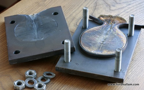

Ford Hallam Posted August 28, 2014 Report Posted August 28, 2014 John, sorry to confuse you. Simply put, detailed casting steel items like the Nanban pieces we're discussing would not have been technically possible until at least the latter half of the 20th century. In small scale workshops perhaps even more recently. As I've tried to explain, the technology simply didn't exist. No confusion really, if it's cast iron/steel (and who's analysed these pieces?) it's post Showa by a long shot. My point about the plethora of cast fakes being to demonstrate exactly how distorted this subject is, that so many who are making deductions about manufacture are so ignorant of the practicalities of real iron or steel casting and are also unwittingly adding to the subject these irrelevant modern fakes. I would add that in my own experience I've learned that many scrupulous students of tsuba have examined Nanban tsuba and interpreted various marks of their making as being proof of casting which I can't see in the same way. To reiterate my central point; Quote I don't believe there is any evidence that the technology required to cast such complex forms as many of the Nanban type tsuba exhibit existed in Edo period Japan, or anywhere for that matter. No one has even attempted to describe how this form of manufacture might have been accomplished using the same sort of processes that tea kettle casters might have used ( simple gravity feed of the molten iron in to a hot mould) nor has anyone found any literary evidence nor archeological artefacts that might suggest this was possible. I maintain that if a steel tsuba is shown to be cast then it's a modern fake or copy. Quote

Ford Hallam Posted August 29, 2014 Report Posted August 29, 2014 Morning John can't say I understand what steam might do in terms of improving a casting. The issue is really one of very specific technical problems. As flexible rubber moulds were not available we have to start with a carved wax model. Jewellers waxes today are amazingly well made to allow for remarkable detail and finnesse but in the past artists had to use a far soften composition of bees wax and rosin. There are limitations as to what you could do with the stuff, baring in mind the wax model is later melted out. Then we have to consider the mould itself. What refractory material could be so delicately worked into the interstices such as those we see on many Nanban tsuba? Plaster of Paris wasn't available. Bronze and tea kettle casting used a system of built up successive layers of various mixtures of clays, chopped straw and finely ground charcoal powder. And bare in mind the need to apply to the wax model a runner to allow the molten metal to be pored in, and various additional feeder runners to make sure the metal gets everywhere and sprues to allow for air and gas to escape so that there would be no trapped air pockets. And then the final problem to overcome is that of actually getting the molten iron/steel to flow fully and without what are called cold shuts (basically tiny hesitations in the flow of metal that causes a imperfect fill. A bit like adding wet cement to an already dry surface, it tends to crack off eventually) . The standard approach was simply to rely on gravity to draw the metal down to fill the mould. And you can easily imagine what a maze of potential air traps a complex composition of tendrils would present. With modern practices this might be overcome by the use of very controlled centrifugal casting. The moment the molten metal enters the mould it is spun thereby flinging the metal hard into the mould, or, more reliably and typically nowadays the use of a vacuum chamber around the mould. As the metal enters the mould the vacuum is released which sucks all the air out of the mould and instantly sucks the molten metal in to take it's place. Vacuum casting on a small scale for use in small workshops was only developed in the early '80's. the 1980's There's a good explanation here;http://www.bronzecasting.co.uk/5_kiln_cast/vaccasting_10.html Edward J Blackley, in the UK, produce very fine cast replacement parts for antique pistol restoration. But this sort of thing simply wasn't available anywhere until about 30 years ago. Of course there may be a way that cast tsuba in steel were made back in the Edo period.... Quote
