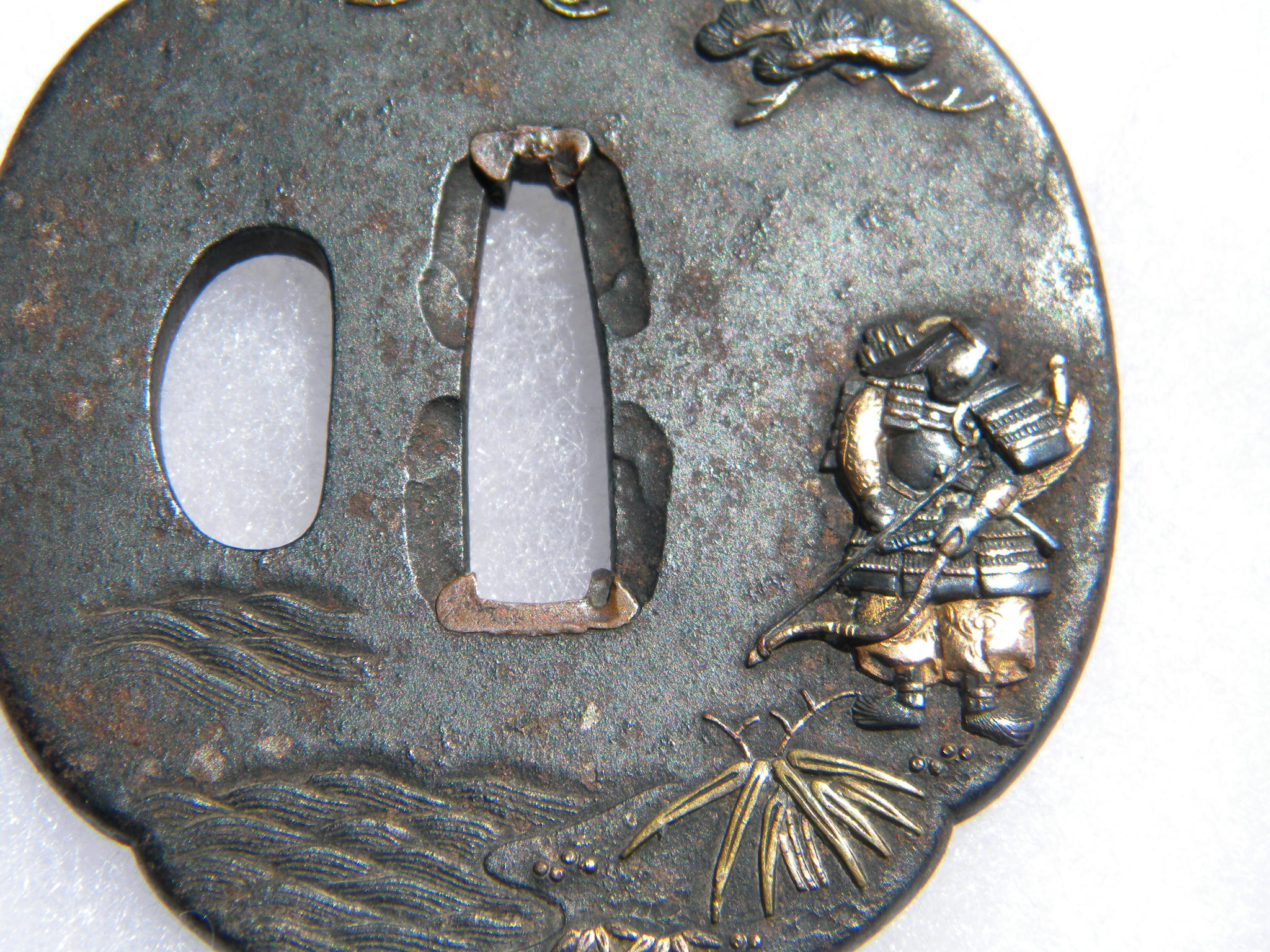

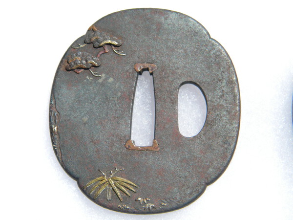

I have gotten a hold of a few tsuba recently two of the more interesting are these. My question is am I way off base thinking that the samurai themed piece can be labeled Ko-Nara? Very detailed piece, unfortunately the samurai's face has been rubbed. Is this something that may be repaired?

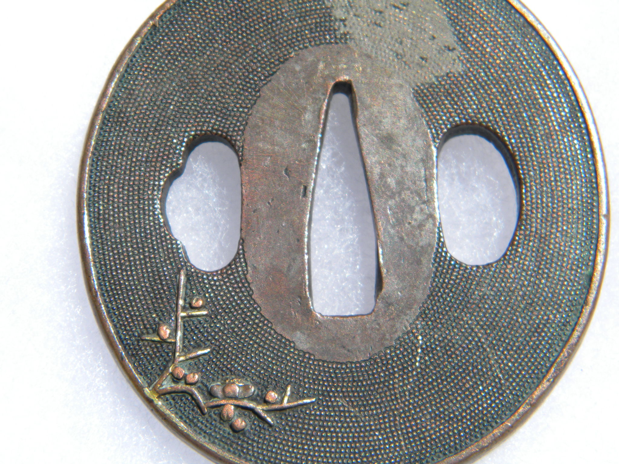

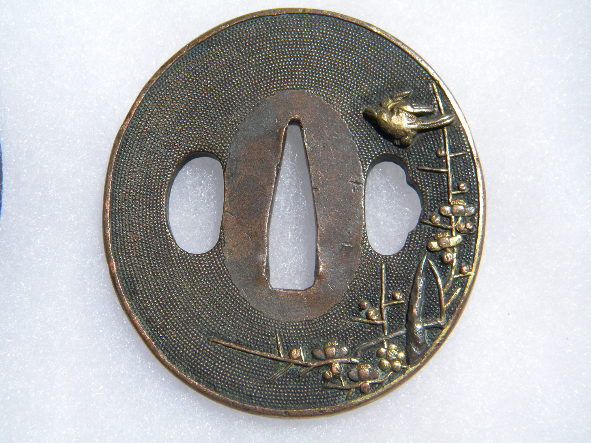

The brassy one I could not find anything as a comparable in my few books or on any of tsuba sale/reference sites. Copper rim with gold wash, but the tsuba is a odd metal brassy mix I guess. Great detail, but also bird's breast has been rubbed a bit.

Hi Bob,
For your first tsuba I would go with Nara school and drop this "Ko" business. :lol: I will let someone else one NMB handle your second tsuba.
Hi Bob.
As you will gather from David S the second isn't going to set the world on fire but I'm not so sure it's a modern cast, I think it is a well worn and probably mistreated one. You can't do it much harm so I would try really hot water and soap to remove the crud first off. If David N is right then you will end up with a shiny piece of junk, :D On the other hand give it some time and see what happens to the decoration, it might turn out OK but not a keeper.

Fellas,
Thank you very much for all the input on both Tsuba. Tsuba study is just about as difficult and diverse as the study of blades enough to make the eyes water in front of the computer or waking up with a black and white referance book next to you in the sack. If I find some time at home I'll do a Jim Gilbert on the stove to try and get rid of the old tag mark. The Coppery one I think looks nice held in hand, and does not seem to be a fake, but what do I know. Hopefully I can get to CHicago next year and trade some tsuba's for a decent gunto.

Gentlemen,
On #2, am I way out in left field with Hirata Hikozo? There are some similarities here especially the comment "copper plate will have yamagane fukurin" which is what this has in my amateur opinion.

Hi Bob.
So far out you are in the bleachers. (Does that make sense?) Have a look at Hirata Hikozo tsuba and get a feel for them. This one is not a good fit when you see them, hard to use a written description. Are you sure that the edge of your tsuba has a fukurin or is it a part of the plate? Can't tell from the photos.

Gentlemen,
Hi Bob,
Left field!? I don't think you're even in the right solar system. :lol: How many Hirata Hikozo examples are display on the Shibuiswords website? Can you make any type of a serious judgment without seeing photographic examples of want is discussed in the text. Taking the text from Shibuiswords and having Ito sensei book or a medium size collection of Hirata Hikozo examples to examine in hand might be a way to go. I know from personal experience that any serious judgment and leaning is only done with the pieces in your hand. The second best way is to have books with extremely good color photographs. The Ito sensei book on the Higo schools is a good example as well as the many KTK catalogs, and a few other publications.
To put this in sword terms it would be like examining just a written list of the characteristics of a Masamune Nihonto and thinking the Gendaito you have was a undiscovered masterpiece of Masamune. Hirata Hikozo is at the level of Masamune when it comes to tosogu.
