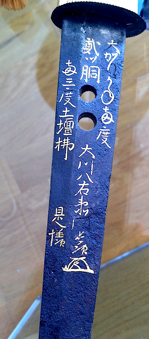

Viper6924 Posted August 9, 2014 Report Posted August 9, 2014 After I´ve finished Mr Seskos latest book about tameshigiri my interest for this intriguing yet terrifying practise was woken. A friend has a sword with a tameshi-mei thats recently been up for discussion at another fantastic forum So far we have gotten a date: 26:th of July 1655. Would love to get some more of this translation sorted, just for the satisfaction of knowing whats behind the kanjis. There are some amazing "translators" here, so any further help would be greatly appreciated. Thanks guys! Jan Quote

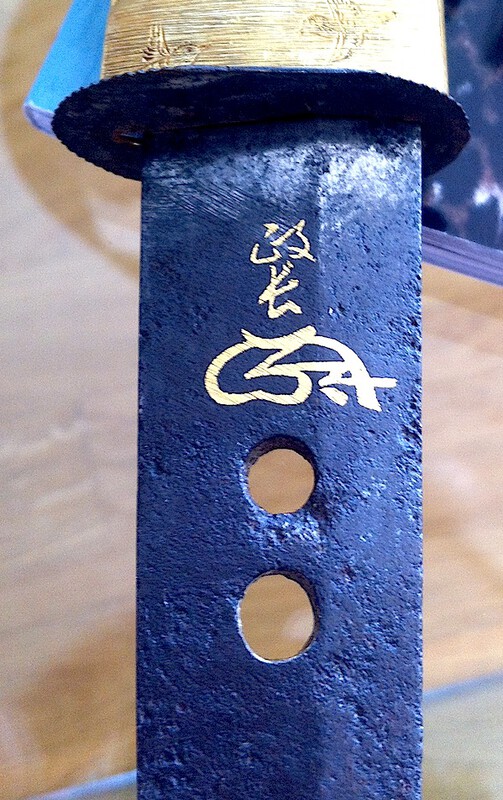

Anthony de Vos Posted August 9, 2014 Report Posted August 9, 2014 Hi! According to Piers; "The style of writing for Naga 長 is written in the same way within Masanaga + Kao near the seppa, and also on the other side for the cutter Nagatsugu 長次... so in my mind, added to the fairly clear rendering of Tsugu 次, this makes the cutter Nagatsugu." So, this would be Ôkawa Hachiemon Nagatsugu (大河八右衛門長次 (元和Genna~寛Kanei). I saw in some reference that he worked a couple of years past 1655 so i could be possible. Ogawa Hachiro´emon Shigeharu (小川八郎右衛門重治(寛永 Kanei~寛文Kambun) has also been suggested earlier. Anyone that can translate what kind of cutting test was actually performed? Regards, Anthony Quote
Anthony de Vos Posted August 9, 2014 Report Posted August 9, 2014 Hi! Gabriel, thanks for the clarification redarding the date, great info. Anthony Quote
IanB Posted August 9, 2014 Report Posted August 9, 2014 Anthony, Under the seppa it says 'two bodies' - futatsu do. Ian bottomley Quote
Anthony de Vos Posted August 9, 2014 Report Posted August 9, 2014 Hi! Thanks Ian! Under the futatsu do, there is the mei of the cutter. That leaves the first row with 2 sets of kanji and the third row of kanjis, the mystery unveils..thanx guys. Anthony Quote
Anthony de Vos Posted August 12, 2014 Report Posted August 12, 2014 Hi! Anyone having any ideas regarding the meaning of the kanjis in row 1 and 3? Any suggestions would be most welcome and appriciated. Regards, Anthony Quote
Anthony de Vos Posted August 13, 2014 Report Posted August 13, 2014 Hi! Considering the lack of response this seems to be a tricky one. I wonder if it is the writing style or the actual kanjis that create the difficulties... I have a go... 大=Great or senior か り が ね 両=both shoulders 度=Three times 弐=two ツ=futatso (counter for the hito-futa-mi counting system) 胴=body Could it be that the sword cut through 2 bodies at the shoulders and it was performed 3 times? Regards, Anthony Quote
Markus Posted August 13, 2014 Report Posted August 13, 2014 The part on the right reads: o-kesa ryodo (大袈裟両度, "cut two times at o-kesa") The part in the middle reads: futatsu-do (貮ッ胴, "cut through two bodies") And the part on the left reads: ryosando dotan-barai (両三度土壇拂, "[cut] two or three times into the ground [i.e. entirely through the target]"). To the left of the cutting tester's name we read: kore o tamesu (是様, "tested by"). The tester, Okawa Nagatsugu, had already been identified. But I don't know who Masanaga was whose name is found with kao on the ura side. Quote

Anthony de Vos Posted August 13, 2014 Report Posted August 13, 2014 Hi! Regarding Masanaga, on the Usagiya home page by the Kashima sisters, one can read; "The inscription says, it was tested again and again by two people, Urano Masanaga and Tomita Yaichizaemon Shigetsuna. They cut three piled bodies, two piled bodies, and one body using one hand only. They performed cutting test on various parts of the bodies. They cut a total of 25 bodies." http://www.ksky.ne.jp/~sumie99/sharpness.html Maybe this is our guy? Markus you mention him on page 175 and 176. Could this be the second extant tameshi mei including Masanaga, implying two test cutters was at work at the same time on this sword? And now we also see Masanagas kao for the first time? Regarding this particular cut, It must be an o-kesa on two bodies lying down, tied together, in order to be able to also cut in the ground. See Marcus book page 137 or 139. I agree Jean, my next will be the sword smith bible, by Markus. Anthony Quote
