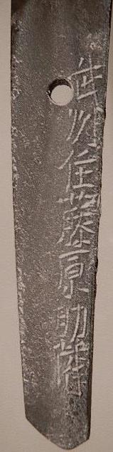

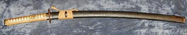

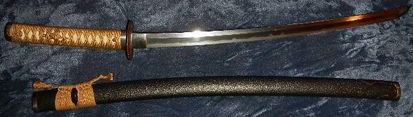

Thought I would wade into the conversation here with a neat Wakizashi. It was forged by Fujiwara Sukechika of Nambantetsu. The blade was ever so slightly longer than standard wakizashi length (it was not my sword so i don't remember exactly how long), but the saya is more the reason I am mentioning it. Outwardly, it was of Katana length. Initially, I thought that perhaps it was a mismatched pair, but seeing that the saya needed to be restored (it was in bad shape), it needed to be taken apart and cleaned. It turned out that while long on the outside, it was carved to match the length of the blade on the inside.
This led me to make one of two conclusions. One, that It was a Merchant's sword, OR, and far cooler, that It may have belonged to a Ninja. Having studied Genbukan Ninjutsu with Tanemura Sensei in Japan, I learned that it was common place for the Ninja to carry a sword that was shorter than it looked, giving them a half second drop on an opponent.
Just food for thought.

Edit: Forgot to mention, but you can see, the tsuka is a bit longer than usual as well.
