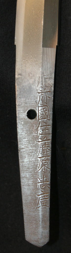

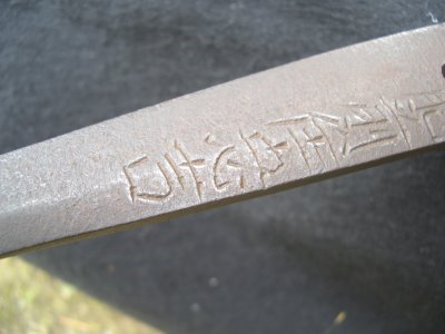

isidro305 Posted August 1, 2014 Report Posted August 1, 2014 hi I recent buy this wakizashi nagasa 46cm collector of tadayoshi can help I serch but can find this mei all can see have kuni and this one not, is this a fake or genune tadayoshi Isidro.
cabowen Posted August 1, 2014 Report Posted August 1, 2014 Need a better picture of the signature but my first impression is fake.

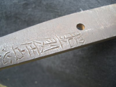

isidro305 Posted August 1, 2014 Author Report Posted August 1, 2014 this only I have sword coming from Japan 1
Travis Clarke Posted August 1, 2014 Report Posted August 1, 2014 Hi Isidro, After you receive the sword and you have it in hand, you should post some pictures of the entire nakago, including the nakago jiri and the entire signature. Some close up pictures of the kissaki as well as the boshi. Some overall blade pictures and some close ups of the hamon and jihada. Some clear pictures will help. I'm sure there is a thread on here about photographing nihonto. I'll post a link if I can find it. Take care and good luck with your sword.

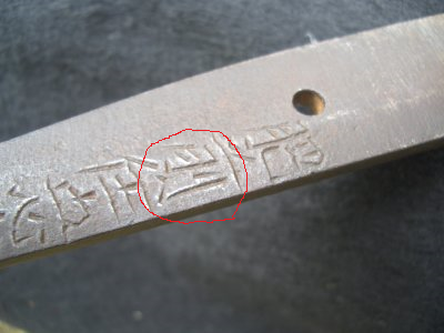

Ed Harbulak Posted August 1, 2014 Report Posted August 1, 2014 I'm sorry Isidro, but the mei on your Tadayoshi is most certainly gimei. The easiest way to know is to look at the second character "zen" in Hizen. That is NOT the way the Tadayoshi/Tadahiro school wrote that particular kanji.
Alex A Posted August 2, 2014 Report Posted August 2, 2014 Hi Isidro, agree with Ed. Infact, nothing seems to look right when compared to other examples in Fujishiros, have a look on the net for comparison.
Ed Harbulak Posted August 2, 2014 Report Posted August 2, 2014 Hi Isidoro and Alex, I should have given a more detailed explanation as to why the "zen" kanji in Hizen makes the Tadayoshi mei on Isidoro's blade wrong or gimei. The 8th stroke in "zen", that's the short line just to the left of the far right vertical stroke is actually located to the right, or outside edge, of the far right vertical slope in genuine Tadayoshi/Tadahiro signatures. On Isidoro's blade, that stroke should be on the far right, outside edge of the "zen" kanji if it's a genuine mainline Tadayoshi/Tadahiro signature. Alex, the way the mainline Tadayoshi school wrote "zen" is correctly shown in the middle photo you included below Isidoro's blade. However, the final photograph, if it's of a Tadayoshi mainline smith, is correctly written in Japanese, but wrong compared to the way the Tadayoshi school wrote it. That means the photograph of the third mei, if it's from a mainline Tadayoshi smith is also gimei. Writing Hizen the way it's shown in textbooks is NOT the way the Tadayoshi school wrote it. The "zen" kanji is one of the quickest ways to differentiate between a genuine and gimei Tadayoshi or Tadahiro signature as it's the character that seems to be most often wrong on gimei blades. Of course "zen" can be written correctly the way the Tadayoshi school wrote it and still be gimei, so the entire mei as well as the workmanship of the blade has to be considered. In the case of Isidoro's blade, not only is the "zen" kanji wrong for the school, but the rest of the mei is very poorly written compared to genuine Tadayoshi school signatures.
Alex A Posted August 2, 2014 Report Posted August 2, 2014 Hi Ed, i had a quick look through Fujishiros this afternoon. The zen in the 3rd picture is from page 120, plate 3, Hizen Kuni Junin Fujiwara Tadayoshi.
Ed Harbulak Posted August 2, 2014 Report Posted August 2, 2014 Hi Alex, If you read the English translation in Fujishiro for page 120 of the Japanese text, it says the signature of your last photo is that of Tosa no Kami Tadayoshi who is thought to be the younger brother of the Shodai Tadayoshi. I guess I never noticed his method of writing Hizen before, but of all the Tadayoshi, Tadahiro mei I've seen in for example Roger Robertshaw's book on the School of Tadayoshi, the "zen" kanji has the 8th stroke on the far right rather than where it belongs. I do recall that some of the other smiths in the Tadayoshi school didn't always follow the same writing method as the mainline Tadayoshi and Tadahiro smiths. But, as always, especially when it comes to nihonto, there are exceptions. I guess Tosa no Kami Tadayoshi is one of those exceptions. Anyway, thanks for pointing out the difference.
Alex A Posted August 2, 2014 Report Posted August 2, 2014 Hi Ed, it did catch me out too, one day hopefully, i will come across something in this hobby thats straightforward. :?
mywei Posted August 2, 2014 Report Posted August 2, 2014 definitely looks wonky afaik, Tadayoshi never signed just 'Hizen ju Tadayoshi' without the kuni? for reference http://www.hizento.com/history.htm#SHODAI%20TADAYOSHI

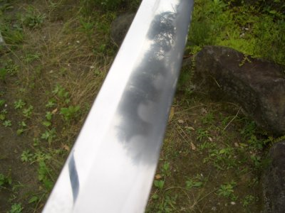

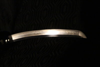

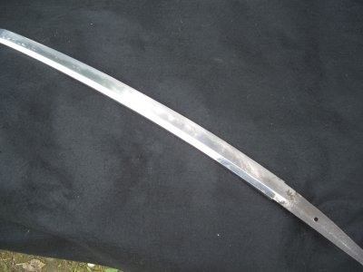

isidro305 Posted August 5, 2014 Author Report Posted August 5, 2014 thanks for all comment i receive my waki today the hamon is beautiful my firs blade in nice condition :D i suspect gmei because the price $700 but i don't care gmei or true looks a nice smith skill in mi little experience, was difficult to make this picture i have a canon t4 and 24-105 f4 L IS any comment of what possible school Isidro.

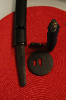

isidro305 Posted August 5, 2014 Author Report Posted August 5, 2014 more pict of the koshirae i never see this tsuba, nakago hole 2 big i need change for small
Widowmaker Posted August 5, 2014 Report Posted August 5, 2014 I usually notice the signature in the two following forms: One is "肥前国住人忠吉作" Another is "肥前国忠吉作" But "肥前住忠吉" is the first time.
Darcy Posted August 9, 2014 Report Posted August 9, 2014 There are no Juyo signed in this form by Tadayoshi. Fujishiro marks none either. There are some "Hizen Ju Minamoto Yoshihiro" and Munetsugu but they seem to use the family name after the Ju.

omidaijo Posted October 12, 2015 Report Posted October 12, 2015 Hi Everyone, Sitting here in LAX airport, bored to tears and rambling on ........... First of all the mei in question is clearly gimei and way off. 200% sure. Don't even go there on a dai-mei. A lot of the gimei kind of look like Tosa signatures, but as I have said before, ever seen two Tosa signatures that are the same? Secondly any talk of dai-mei is pure speculation when it comes to waki-hizen smiths like Hirosada etc, signing for the mainline, and incredibly hard to prove. I am sure they did it, but I kind of gave up going that route as it is impossible to stay on top of it, to research it (a lot of the old scholars were looking at gimei half the time I am sure), and drives you mad trying to work it all out. Father son is a bit easier (eg 3rd for the 2nd, 4th for the 2nd etc) but still a minefield and an area not trod by the NBTHK as far as I know --- ever seen a Tadayoshi sword with recent NBTHK papers saying Dai-mei xxxxx? I do not recall ever seeing a paper saying as much, so the NBTHK don't even go there as far as I know. Eguchi postulates that Tosa no Kami was actually Munetsugu, the head Priest, taking the then famous Tadayoshi name in 1624, forcing Shodai Tadayoshi to take the name Tadahiro. Tosa was unlikely related to Shodai Tadayoshi considering the evolution of the School and the fact the Shodai was orphaned at an early age, and adopted into the forges by the Nabeshima. Maybe Tosa was related, but there are just some things that you can't prove, and you end up beating your head against a wall just to relieve the stress ! The scruffy "Masahiro Dai" mei in my book .... yup, after 16 years I kind of think it is probably gimei.....it sold a long time back and I think it would be unlikely to paper today (mind you, the new NBTHK is unlikely to paper anything questionable these days!).. but not sure at the end of the day. My opinion on a few areas has changed over the years ...... one thing is never say "never" because this School was throwing tons of swords/naginata/yari out every week it seems. Got to ask where they got all the steel from (black ships?? Nagasaki etc?). I managed to pick up a paperd Leaf Yari by the Shodai earlier this year, and a small yari (almost nanone size) by the 9th gen....the latter probably used for killing wild Geijin hamsters. To clarify, I have never seen a diamond chisel stroke in the top of Hiro other than those attributed to the Shodai (and Gimei). ie The Nidai didn't do it at all. Not only that, even when he made a dai-mei for the Shodai he didn't use the diamond......If I could figure out how to easily attach an oshigata, I could show you a Nidai Dai-Mei for the Shodai circa 1632.... Lee?? Now if you really want to go somewhere interesting, go to the early 8th gen days when he was 12 years old and took over the school. That's when a lot of the gimei appeared I am sure --- and from the School itself! I have a sword dated 1819 with a goji mei (failed papers of course). Yoshikawa pinked a sword I have with a Hizen kuni Tadayoshi goji mei, saying "later Hizen School copy of the earlier Shodai" .......his reasoning based on the horimono being too shallow. A word of warning .... there are still fabulous gimei coming out of Japan --- I know I bought a couple in the last year or so that failed papers ! So be careful. Once you sit down with them for a week you can kind of see why they failed, but it takes a while for the penny to drop.... one or two I still don't know why they failed papers after years of looking at them. Ok I will be arrogant and say the NBTHK got it wrong ....... :-) The only way is to line up swords by each master side by side, then see where the sword in question fits.......even then it will be hard because they made so many different pieces, and there are so many fakes out there. So if anybody wants to buy the whole School and more to try this out, let me know!! Armour .....thats the future. No-one worries about gimei or dai-mei... just appreciates the workmanship and beauty. And its easier to mail around the world :-) I will go back to my hole now. Cheers, Roger 5
