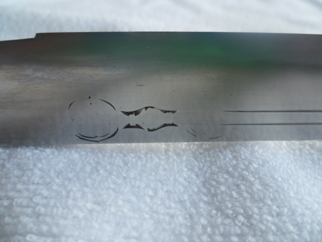

Cheers Gabriel, your write up as been very helpful, id been planning on learning something about Horimono. I have a wakizashi from the late Nanbokucho period, the horimono as diminished with polishing over the years and did have me curious. I had the horimono down as Suken previously, but i believe Hoken or Sankoken is the correct term.
Yes, you can clearly see the remains of the sanko/kongō-tsuka (vajra hilt), which would make this an example of the hōken (treasure sword) / chiken (wisdom sword) / sanko-ken (trident vajra sword) / kongō-ken (vajra sword). Take your pick as to which term you like best, they all apply. ;)

Interesting investigation, hopefully will inspire further look at horimono meanings. I have a (project) ken which I purchased from another member awhile back and I've wondered over the meaning of the horimono on it, now I know! An interesting feature of this knife is that the "ken" horimono is clearly present on one side, a similar image on the other is "missing" the pointed end. For some time I thought that it had just worn away from polishing over the years, but on close observation it appears to me that it was done this way deliberately. Below are a couple of not so hot pictures, but hopefully show the features in question well enough. Any ideas on the two parallel lines without a point?

Hi Michael
It's a bit like Christian Iconography and the attributes of the Saints.
These usually relate to Fudo No Myo - o
The two parallel horimono are referred to as Goma Bashi and represent metal chopsticks which are used in Shinto and some Buddhist Ceremonies such as the O-Goma Fire ritual which is still practiced daily at Naritasan Shinshoji Temple.
Naritasan Shinshoji Temple is dedicated the Fudo no Myo - o.
