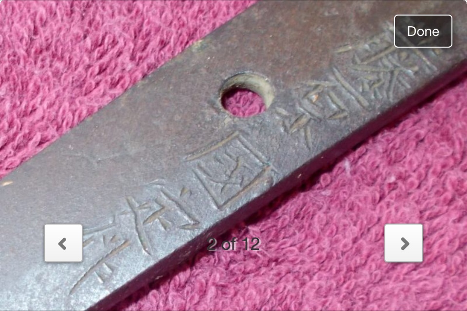

Heringsdorf Posted July 23, 2014 Report Posted July 23, 2014 Hello, I'm new to the forum, and need some advice and guidance on a wakizashi I'm interested in. The nakago is signed "Fujiwara Kunisada saku" I think. It's dated "Keicho 2 .....? Year 8month a lucky day" What is the opinion of the experts in this forum on the mei and the overall blade? Thank you very much. Quote
hxv Posted July 23, 2014 Report Posted July 23, 2014 I believe it's gimei for several reasons: 1. In 1592, when the sword was purportedly made, Oya Kunisada was at best 2-3 years old. 2. His work has very nice, even ji nie and his hamon is nie deki. I don't see nie on this sword. 3. The mei is not his recorded mei, and see #1. Regards, Hoanh Quote
Heringsdorf Posted July 23, 2014 Author Report Posted July 23, 2014 Thank you for the reply. I thought the date was 1597. Keicho 2 But even then, Kunisada would have been only 7-8 years old. Max B. Quote
hxv Posted July 23, 2014 Report Posted July 23, 2014 My apologies. Again, in 1597, he was under 10 years of age. Regards, Hoanh Quote
Gunome Posted July 23, 2014 Report Posted July 23, 2014 Hello, What Kunisada are you talking about ? The only I have with these kanji "藤原國定" is kawachi daijō fujiwara kunisada that worked around kanbun, so about 60 years after keicho ?! Thanks Quote
hxv Posted July 23, 2014 Report Posted July 23, 2014 The only Kunisada in the neighborhood of this time frame I can think of is Izumi no Kami Kunisada, father/teacher of Inoue Shinkai. Even then, it's about 10-15 years before his time. Hoanh Quote
Heringsdorf Posted July 23, 2014 Author Report Posted July 23, 2014 So it's probably a total fake? Quote
Heringsdorf Posted July 23, 2014 Author Report Posted July 23, 2014 I also wonder on the date side what the kanji after no (2) and before nen means? Max Quote
KarlPeterSmith Posted November 30, 2015 Report Posted November 30, 2015 1596 is your start date (And I'm only seeing the last character of the 2 year date given in the 2nd pic of the above post #1) which looks like an 'E' above an 'lX') just so you know my starting point. ('Mr hxv' in post#2 states it is 1592 but... that's impossible going on the characters on your blade which would be looking like an '1/X' above a 'TK', and they don't look close to anything like that.) PLUS... you need to add more years... minimum of +2 (Ni) due to the following '=' symbol. Taking it to 1597... hey...the date Tadayoshi and Munenaga were at Umetada Myoju's forge with Kunisada(d.1660)... maybe 1597 And the 'year' symbol resembles that of samurai sword-maker Horikawa KUNIHIRO (d.1615)... who taught KUNISADA before his nephew KUNITOMO (d.1660) took over the tutoring of Kunisada. Will this NEWS cheer you up? I actually haven't learnt (Stems and Signs) [characters beneath the year symbol] ...but the Horse (Midzunoye) character is there.. 9th Month? Or a miswritten Horse character... Quote
