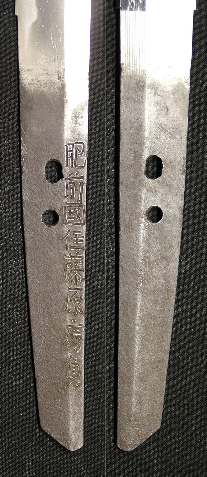

harvg Posted July 27, 2014 Author Report Posted July 27, 2014 Found a couple examples of Hizen nakago, that are very close to my example ....thoughts? harvg Quote
hxv Posted July 27, 2014 Report Posted July 27, 2014 Harvg, Gimei, IMHO. A quick search on the web gives me this sword, http://www.japaneseswordsocietyofcanada ... cs.html#3., by the same smith and papered. Can you compare/contrast your sword with this papered sword (and therein lies the answer)? Regards, Hoanh Quote

hxv Posted July 27, 2014 Report Posted July 27, 2014 Harvg, IMHO, a simple gimei/shoshin answer does not enrich one's knowledge, but knowing the path to the answer is immeasureably helpful. Independent of your Hizento expert, let's explore one path. Starting with the papered sword which link I posted, can you list similarities and differences your see, based on the nakago, with your own sword? After you make a list, we can take the next step. Regards, Hoanh Quote
harvg Posted July 27, 2014 Author Report Posted July 27, 2014 Hi Hoanh, similarities of the link you posted: the shape of the nakago is the same (same curve and taper), there is no pic of the point in your example, but I have found multiple Hizento examples with the same offset straight point. The yasurime on yours is straight, as opposed to mine being angled towards the blade, but again I have found multiple Hizento blades with the same yasurime as mine. With regards to the kanji of the Mei, I am very intrigued by the "Kane" kanji. While my sword has a larger arced radical, in the Kane kanji, overall it's the same variation of the Kane character as the papered one you link to. I personally have yet to find another "Kane" smith, that uses this variation. Harvg Quote
hxv Posted July 27, 2014 Report Posted July 27, 2014 Harvg, That's a good start, with the similarities & differences you compiled. Here are some of my observations: 1. As Bazza and Brian already mentioned, the way the kanji are chiseled are so different. IMHO, they cannot be chiseled by the same hands. I don't means just the Kane kanji. All of them are chiseled very differently. 2. The papered sword is signed tachi mei, and your sword is signed katana mei. I assume both swords are katana length. 3. The mekugi ana of the papered sword touches the bottom right of the Kuni kanji, whereas the mekugi ana on your sword is entirely above the Kuni kanji. 4. The mei on the papered sword does not have the Ju kanji, whereas yours does. Points 1 through 4 above are very important, make-or-break differences, not minor nitpicking issues. It's important to also realize that while you can find different yasurime and different nakago jiri on Hizento by different Hizen smiths, each smith has a specific and consistent way for yasurime, nakago jiri, mei placement relative to the mekugi ana, and mei chisel and syntax that don't change that drastically over time. On the mei syntax, unless at some point, they receive a new title or move to a different province, the mei syntax tends to remain unchanged over the years. The goals of my posts are: 1. to give you a little bit of info and some possible questions to ask your Hizento expert when he arrives at an opinion, and 2. to form your own opinion. I hope you receive them as a constructive and educational dialog. Happy collecting! Regards, Hoanh Quote
harvg Posted July 27, 2014 Author Report Posted July 27, 2014 Thank you Hoanh for the insight. The biggest problem is that there is not multiple papered references for this smith for comparisons, as this papered tachi is the only one I have seen. This smith was active for 15 years, did he personally chisel all his sword? Hawley lists his Mei as having 13 kanji...the papered tachi has 11, mine has 12. The extra kanji would, if Mei is legit, explain the difference in the mekugi Ana placement. Just a thought.....if my sword is legit (and I realize that is a big if) and it was the only papered example.....would everyone be saying that the tachi is Gimei? Harvg P.S. My opinions really are just from my observations, I really have no idea what I'm talking about! Quote
Ian B3HR2UH Posted July 29, 2014 Report Posted July 29, 2014 Hi Harvg , there are oshigata of ubu Yamato daijo Kanehiro nakagos in Kanzan Oshigata and Hizento Shiko . Both are signed tachimei . The chances of a genuine Hizen daito being signed katana mei is pretty slim although they do exist. Both tangs end in kuri jiri . Your nakago ending is wrong . Hizen mei are in my experience beautifully cut . In my subjective view yours isn't One is signed Hizen kuni ju and the other Hizen kuni Yamato ( ie one has ju in the mei the other doesnt ) I havent attempted to compare the way the characters are cut but the Kane looks way off to me Sorry but my conclusion is that it is Gimei . Ian Brooks Quote
