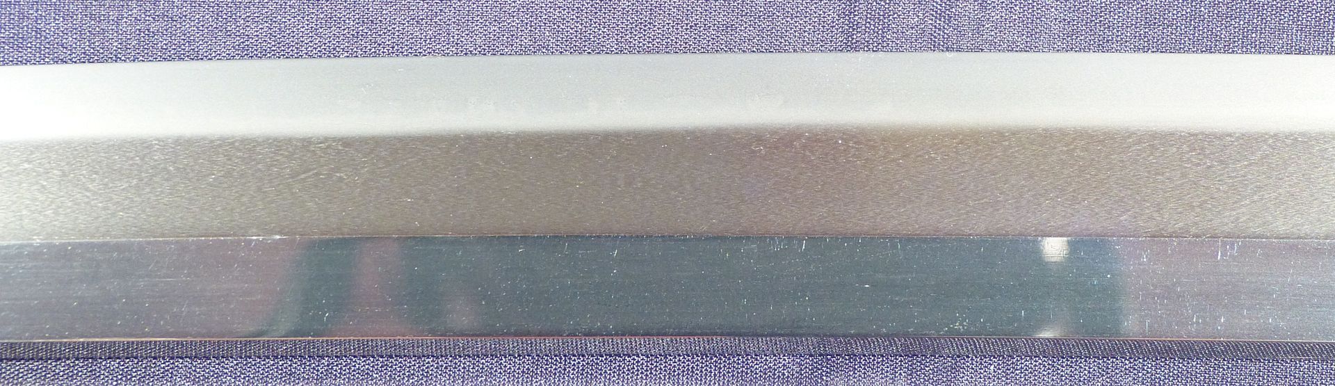

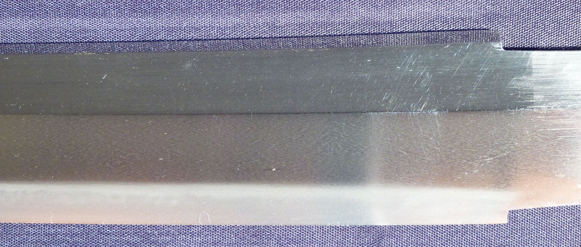

stephan_hiller Posted July 17, 2014 Report Posted July 17, 2014 A few weeks ago I acquired this nice gendaito from Muto Hidehiro and would be happy to get your opinion on that blade as well as further information on Hidehiro. This is what I have gathered so far about the blade and the smith but would be happy for anything not yet covered. Could someone send me a scan of page 100 of Ono Gendai Toko Meikan. I have been told that there are some more information about this smith but do not yet have this Meikan. Ok, here are the facts: Nagasa: 67,6 cm / 26.63” Nagako: 21,5 cm / 8.5” Moto-haba : 3.4 cm / 1.34” Saki-haba : 2.2 cm / 0.87” Moto-kasane : 0.7 cm / 0.3” Saki-kasane: 0.5 cm / 0.2“ Sori: 1,6 cm / 0.63“ Mune: Ihori Jihada: Very tight Ko-Itame Hada which reminds us of the konuka hada of the Hizen tradition Hamon: Suguha with ashi Boshi: O-maru Kissaki: Rather large chu-kissaki Activity: Nioi, Ashi Nakago: Ubu Mekugi-ana: 1 Nakago-jiri: Haagari Yasuri-mei: Kesho Mei: CHIKUGO NO KAMI MUTO HIDEHIRO SHOWA NIJU NEN NI GATSU (February 1945) Koshirae: Shirasaya Habaki: Solid silver habaki with cat scratch design Origiami: NBTHK Tokubetsu Kicho paper from 1979 Muto Hidehiro is a gendai smith who worked during and after the war. His real name was Muto Hideyoshi and he lived in Fukuoka ken Ogawa shi. Hidehiro was born in Mei 24 (1891), he started making swords for the army in Showa 14 and re-started in Showa 32. He has won several prizes including the Army Gunto Skills Encouragement prize. After the war he used Hizen style suguba. During WWII period he worked as a Rikugun Jumei Tosho(RJT). His blades were marked with a star stamp and have a very sharp pointy hamon almost nokogiri (saw teeth pattern), but more irregular. The hamon consists of clear nioi. He is on page 100 of Ono Gendai Toko Meikan 1971. He descends from 8th gen Hizen Tadayoshi - 1st Gen is Muto Shinano no Kami Hisahiro (his father) - 2nd gen then is Muto Hidehiro His yasurimei is kiri in WWII but sujikai after the war, with kesho. He died in 1989 Stephan Quote
stephan_hiller Posted July 17, 2014 Author Report Posted July 17, 2014 ... and some more Stephan Quote

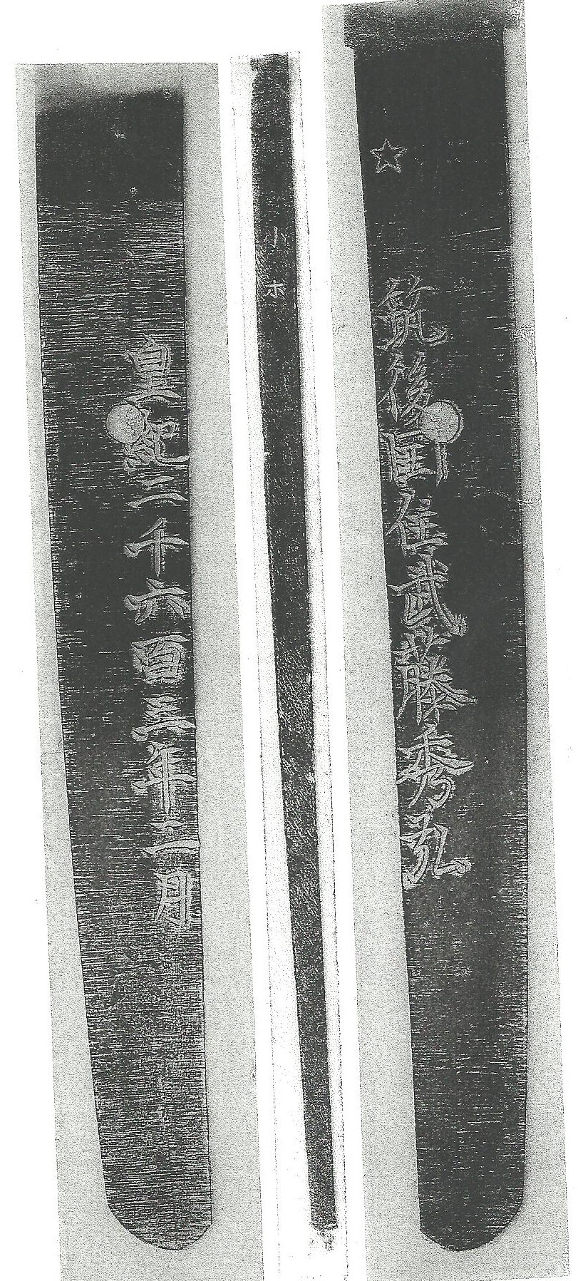

george trotter Posted July 18, 2014 Report Posted July 18, 2014 Hi Stephen, I used to own a blade by Muto Hidehiro. Mine was the one described as "nokogiri" hamon. Most of his work appears to be like yours, essentially Hizen style. There are a couple of points to note: 1. His mei is more formal in his earlier work (see pic). 2. His yasurimei are kiri in his earlier work at least to 1943 (see pic) 3. if you look, he seems to always cut his machi deep below the top shinogi ji line, and his hamachi is deep also. This seems to be a feature of his work. Your mei and ysurimei appear in 1945 and are identical blade/ mei/ yasuri as shown in Ono 1971, so it looks like he "evolved' in mei and yasuri from mine in the earlier war period into yours in the late and postwar period (unless mine is completely out of character?). Considering his ancestry is Hizen, it is probable that my nokogiri/mei is an "oddity" to his normal suguba/cursive style. His lineage is 8th Hizen Tadayoshi - 1st gen Muto Shinano no Kami Hisahiro - 2nd Gen Muto Hisahiro - this man. He is given as working in the style of 1st Hizen Tadayoshi. I hope this helps (wish I still had mine). Quote
stephan_hiller Posted July 18, 2014 Author Report Posted July 18, 2014 Hi guys, many thanks for the information and opinions. I think Hidehiro is one of these "unknown" gems with a lot of potential. If someone is interested Aoi-Art currently has an auction for another Hidehiro here: http://www.aoijapan.com/katana-chikugo- ... u-hidehiro Although I am tempted to bid on that one I don't want to risk having trouble with my wife. She already "approved" 4 blades in the last 6 months :-) @ Joe: Yes, I have read that story when I googled for Muto Hidehiro and from your descriptions I also knew that my new acquision was originally yours. I think you had the kissaki slightly reshaped by Bob Benson. @ George: Many thanks for your information and scan. I will add that to my records. One final question. I know that the Tokubetsu Kicho papers that came along with the blade is an "old" paper but I wonder if they issued these papers for still living smiths. The paper was issued in 1979 but Hidehiro died in 1989. AFAIK the NBTHK only issues papers for already deceased smiths. Is that generally correct or only correct for the "new" papers? Thanks, Stephan Quote
