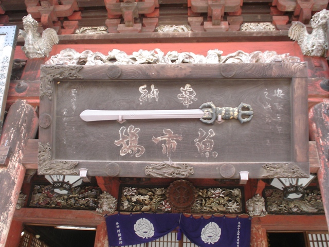

Baka Gaijin Posted July 11, 2014 Report Posted July 11, 2014 Hi Ken, If you check out Naritasan Shinshoji Temple in Narita City, Chiba Ken, you will discover it is packed full of Ken, Ken. Hundreds of them in the gardens standing sentinel and on the various Statues of Fudo no Myo-o that are to be found there. I have a votive Ema board, which is dated to 1890, which depicts two Ken, Ken. Also check out Kurikara with John Maki Evans (Who seriously studied esoteric practices for a number of years in Japan): http://books.google.co.uk/books?id=yGIB ... gy&f=false Cheers
Ken-Hawaii Posted July 11, 2014 Author Report Posted July 11, 2014 Very cool, Malcolm! Thanks for that info! Ken
Baka Gaijin Posted July 11, 2014 Report Posted July 11, 2014 No Problem Ken, Do you see the size of the Ken in picture four by comparison to the staircase which is just beside it. It's quite idyllic, turn 90 degrees left and there is a pond full of Carp and Turtles with a trickling fountain. Bring back some memories of Japan???
Jon MB Posted July 11, 2014 Report Posted July 11, 2014 Notice the grip of each ken in the pictures is made up of a vajra, or thunderbolt. Short ken with these grips are still sometimes used in demon subduing rituals in Mongolia and Tibet. Ritual bells with vajra handles are very common in temples there too. Here is a short article about vajra in Japan, Kongo Vajra. http://www.kyohaku.go.jp/eng/dictio/kinkou/mikkyo.html

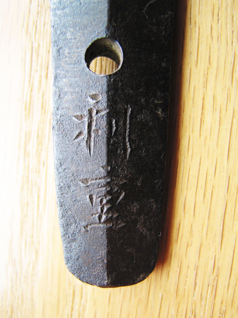

Darcy Posted July 24, 2014 Report Posted July 24, 2014 The ken cuts through illusions. Fudo Myoo carries that sword and a rope with which to bind evil. So he is a deliverer of justice, bringer of wisdom, and the two of these go hand in hand. Putting a suken on a sword invokes Fudo Myoo, so we can see some sympathetic as well as real magic. Whenever you look at it you are reminded of wisdom and justice, of seeing through illusions to the truth, and being motivated by the truth and not falseness. So it has a very real effect in this way, as well as what may be a magical effect. We see the rope sometimes in horimono, the most famous Kinju tanto features it. But the suken is probably the most popular horimono in all its variations. Interestingly there are far more suken horimono than ken that have been handed down. What you have with a ken tanto is a direct manifestation then of a ken, so something that you can hold and have that will keep your spirit aligned with the way of righteousness. Something to contemplate and remember as well as give you this kind of guidance and protection. All of it is to keep you on the path, so indeed it is religious but probably more spiritual. Same way as a christian might have a cross and we'd ask, well what does this thing do, what is it for? It's a symbol of belief, a reminder of a higher calling and higher principles, and a focus of attention in times of need or suffering. It's a talisman. In this case the talisman can also be used to stab someone but hey, different strokes for different folks. They are fairly rare but they are seen going all the way back to Heian and probably before too. There is also a quite amazing Tokubetsu Juyo signed Mitsutada ken. Horimono are common, often just a small hi, but sometimes bonji and sukashi horimono. Mostly they are diamond like in cross section but some are flat. Some of the older ones have tempering only on the upper portion. The oldest seem to be associated with Yamato and you see this attribution as Yamato ko-Ken fairly often on them. There are more variations on shape in the older ones, and the newer ones seem to have less in the way of horimono and start looking a bit more like a yari. Probably that the monks are the customers for the oldest of them helps seal the deal on the religious connotation. There are about 60 or so Juyo ken. This one was recently polished by Ted Tenold.
