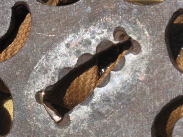

RocklockI Posted June 27, 2014 Report Posted June 27, 2014 Hello ,I just joined the forum and would like to hear opinions on a sword I recently purchased. The story on this was that it was an airforce pilots sword . It has a leather covered saya but the Koshrie is not Gunto. The blade is 23 and 3/8" so it is a short katana or wakiziki . Thank you, Gary Quote

Peter Bleed Posted June 27, 2014 Report Posted June 27, 2014 Gary, Steve is right, this is a nice looking rig. I'll be if you get a couple of easily available books you will read this signature and find it is quite collectible. The important characters are the last two. The ones above that say "Fujiwara." I would NOT recommend submitting it to shinsa til you've done more research. Peter Quote
mdiddy Posted June 27, 2014 Report Posted June 27, 2014 Signed Fujiwara Tomoyuki. Edo-period Bungo smith. Probably a long, Shinto wakizashi. If you search the forum you will find some threads on Tomoyuki and maybe a couple of other collectors interested in his swords. There were a couple generations of Tomoyuki. Looks like the blade is in good condition. Keep it in good condition by taking care of it per some of the recommendations laid out by Grey Doffin in the FAQ/Articles sections. Quote

Peter Bleed Posted June 27, 2014 Report Posted June 27, 2014 Gary, The woods are full folks who will offer help. It seems to have already started for you! My advice is to find some people who share your interest. Contact them. Meet with them. Look at their swords. Show them you swords. Be nice, moderately trusting, and competely honest. Do not sell your sword. It is truly collectible, but it will also provide the basis for chatting with others. I would NOT be in a hurry to buy anything BTW. There are lots of swords. be patient - unntil you come across a Sendai Shinto by Kunikane. Those you should sell to me, cheap! In answer to your question, that line you showed on the mune (back ridge) of your sword is NOT the hamon turn back. It is a conventional line the polisher put there. Good eye, tho. The Tomoyuki line was a group of like a half dozen generations or smiths who made swords in Bungo province in the 16 and early 1700s. They were well respected. You have a real samurai sword there! There are LOTS of books and you have already been given solid advice. Reading John Yumoto won't hurt you a bit. I also think it is worth going to your local library and getting Robinson's Arts of the Japanese Sword - or even his older Primer. He has a very handy chart of the characters you will need to learn. It may seem daunting, but they are arranged in order of stroke count. That chart is really handy!! I hope to see you at one or another of the sword shows. You are off to a good start. Peter Quote

Surfson Posted June 28, 2014 Report Posted June 28, 2014 Looks like a nice blade, and worth some study. Was the handle rewrapped by you or the previous owner? I'm pretty sure that it is a new wrap done by a westerner. Enjoy it - it looks quite nice! Quote

Geraint Posted June 28, 2014 Report Posted June 28, 2014 Hi Gary and welcome. Your sword is a very good find, (though the hilt wrap is not pretty as has been pointed out by Robert). Regarding your question about rankings, have a look at this link, http://www.nihonto.ca/ratings.html This should tell you what you want to know. Enjoy. Quote

Kai-Gunto Posted July 8, 2014 Report Posted July 8, 2014 The ito is very poorly done. If I was You, I would get it rewraped by a someone how know how to do it. And yes , it can be done by a westerner Quote
