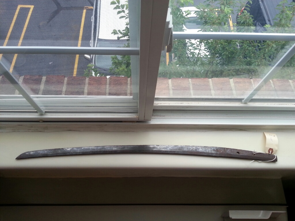

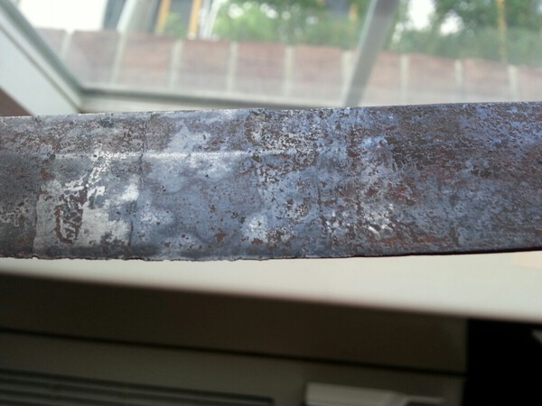

bigjohnshea Posted June 26, 2014 Report Posted June 26, 2014 Hope you are all well. Here a few images of an unpolished sword I have. The first image is just above the Munemachi and you can see two lines of rust running perpendicular to the Ha. One of them seems to originate from a chip in the edge. However there are other lines of rust similar to this in the next picture at the area where the yasurime should be, and they do not originate from chips. In your opinions are any of these hagiri? Thanks for you time. Cheers. Quote
Peter Bleed Posted June 26, 2014 Report Posted June 26, 2014 Those line look to me like the result of having been wrapped with tape or something. I'd bet against a hagiri. Instead the blade has been ruined by the deep rust pits and generally terrible condition. It is a goner IMHO. Peter Quote
hxv Posted June 26, 2014 Report Posted June 26, 2014 John, What does the blade look like on the other side? If they are indeed hagiri, you should see them on the other side, too. Regards, Hoanh Quote
bigjohnshea Posted June 26, 2014 Author Report Posted June 26, 2014 I do not have a photo of the other side with me but I know they are not present on the other side. I had thought of that when inspecting it earlier. The blade is very rusted, this is true. Quote

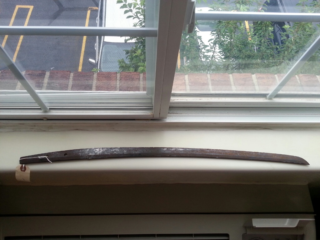

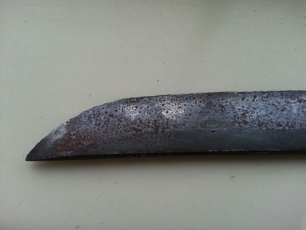

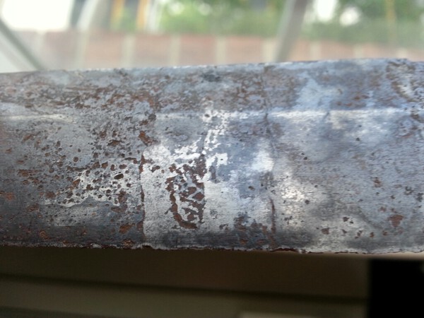

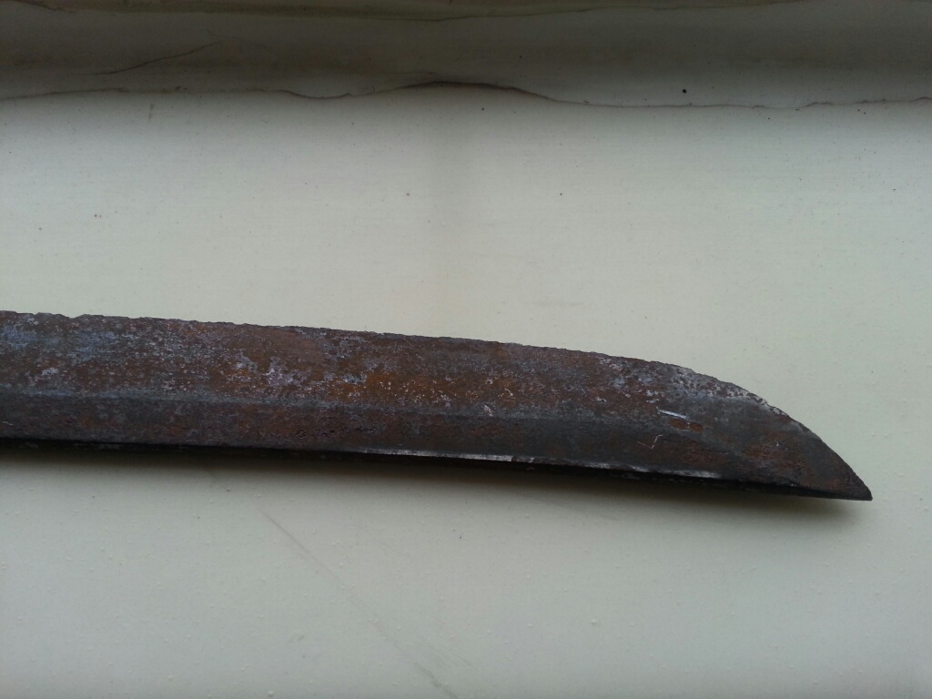

bigjohnshea Posted June 26, 2014 Author Report Posted June 26, 2014 This is just proximal the munemachi. You can actually see the lip of the munemachi at the top of the blade in each photo. I don't think this sword was welded at all. My instinct is that this was a katana made into an osuriage wakizashi. I had a similar katana that was of muromachi origin and this feels and looks the same to me. Here's a few more photos. Quote
bigjohnshea Posted June 26, 2014 Author Report Posted June 26, 2014 As you can see there are similar markings on both sides of the blade at the same region but they are not originating from the same areas of the blade when you look at it closely. I think Peter may be entirely correct. Perhaps it was wrapped with something and maybe used as a tool. This would explain all the chips in the edge but also the lines of rust near the munemachi. Quote
