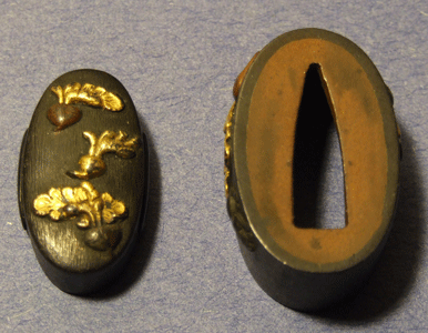

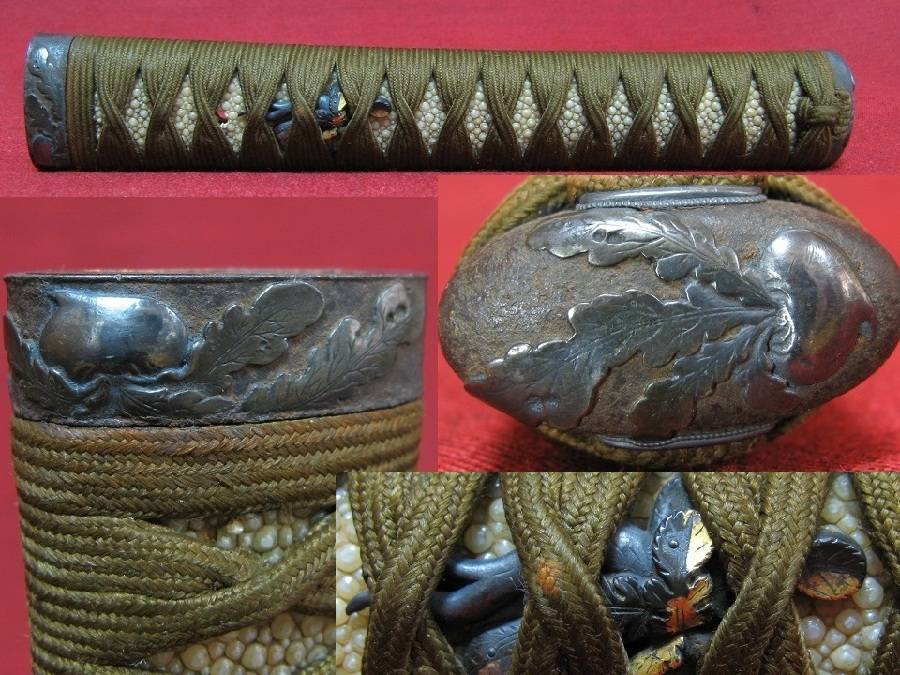

Hey -- I have a tsuka with Daikon F/K and menuki (I'm not 100% sure on the menuki - might be some other root vegetable) and am wondering if anyone has an idea as to the significance of this theme? I know they are part of the New Year's offerings but nothing else. I have seen this theme used on fittings over the years but somewhat rarely.

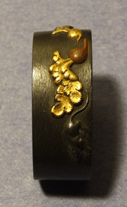

I add a pic of a F/K I have with turnips and mouse. The mouse is not a seasonal motif (I would associate it with fall myself though), but, does represent plenty. J
I Loves Meeses to Pieces... a little (very little) play on an old cartoon line.
That's a very nice F/K! There must be a basic symbology associated with this theme as it is recurring.

The Tsuba-kodôgu gadai-jiten says that as kabu (蕪) and daikon (大根) are - as Guido already pointed out - related, (大根) was sometimes also read kabu. The mouse is regarded as messenger of Daikokuten, one of the Seven Gods of Fortune, and was used as "increasing" or "emphasizing" iconographic element. That means a mouse emphasized the lucky effect/symbolism of Daikokuten and thus the duo was extended by the turnip where kabu has to be understood as play on words, referring to kabu (株) which means "stocks, shares". So Daikokuten, mice, and turnips meant altogether "fortune + prosperity + happiness + profit".
Thus the combination motif of mouse and turnip has to be seen in this context, even without Daikokuten.
So when a motif doesn´t make much sense at a glance, it is always good to check if there is a play on words. For example the combination motif of horse and turnip: A horse jumps (haneru, 跳ねる) and so this "jumping/leaping" goes quasi symbolically over to the turnip, kabu. Kabu ga haneagaru (株が跳ね上がる) means namely "the stock prices are skyrocketing".
