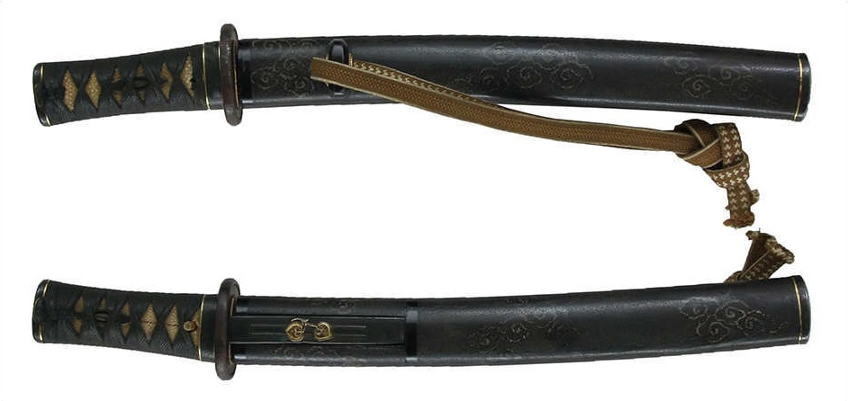

Guido Posted May 28, 2014 Report Posted May 28, 2014 Seeing a koshirae on Aoi Art today (see attachment), I couldn't let the opportunity slip to post it here in the hope that it will put a die-hard urban legend to rest – the all too common misconception that chiisagatana 小さ刀 (often misspelled "chisagatana") stands for a sword slightly shorter than a katana (i.e. wakizashi) but mounted in a katana-sized koshirae. Kind of a make-believe katana, usually explained as a merchant or ninja sword, intended to hide the actual length of the blade. Even some seasoned collectors stick stubbornly to this nonsense . Before the uchigatana came into being, shorter swords mounted differently from tachi were called chiisagatana or koshigatana 腰刀 (hip-sword). Chiisagatana, which literally means "short katana," are tantō or sunnobi-tantō mounted in a similar fashion as a katana. Another term for chiisagatana is tsubagatana 鍔刀 or "sword with tsuba," as opposed to aikuchi (“meeting mouth”), which is a tantō without tsuba. Although the meaning of chiisagatana changed over the course of Nihontō history, this term was used from the Edo period on to describe tantō that had a tsuba and usually tsukamaki as well. This is a typical example: Quote
Curran Posted May 28, 2014 Report Posted May 28, 2014 Guido, Nice little koshirae with a nice blade. Good starter package for someone, thought I would worry about a newbie properly caring for old ito like that. In the Aoi Arts Japanese listing, where is the mention of chiisagatana? At my mediocre level of reading, I would have thought they were discussing the kogatana instead of koshigatana / chiisagatana. The English version doesn't mention it and my Japanese reading doesn't see 腰刀. Quote

Guido Posted May 29, 2014 Author Report Posted May 29, 2014 Brian said: No doubt it will be at least a month before we all forget it, and confuse the term again You're probably right, but now it's on record, and we can rub people's noses into it. \ said: In the Aoi Arts Japanese listing' date=' where is the mention of chiisagatana?[/quote']They usually don't specify, and just write "koshirae". Here's another – papered – example from the e-sword website (http://www.e-sword.jp): Quote
