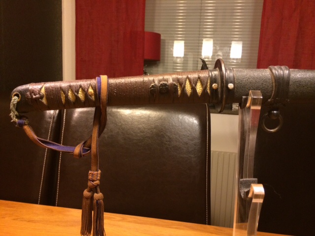

the first saber is a kai-Gunto whit Toyokawa inspection marks stamp but im not sure about it!
the gunto look very good and the blade are sharp and have really good condition .....i think it's anti-rust blade and she is magnetic
the Tsuka look great too but i think its not rayskin under the Tsukaito maybe im wrong!
i know the scabbard miss somes parts like  Semegane Ishizuki... i see the place where they are before
all parts of the Tsuba have the same number #7 i tink its a +
here a link to take a look of the kai-Gunto https://imageshack.com/a/653q/1

Bon jour Eric...comme ca va?
Both your swords are WWII gunto (military swords) and both are mass produced showato...not hand made and not worth spending money on expensive polish and resoration. (in my opinion).
The navy sword is from a naval arsenal factory (circle with anchor stamp).
The Type 3 also is from an army arsenal and was inspected ar Osaka? (I think a "saka" stamp...hard to see, maybe Seki stamp).
You do not show the maker's name, only the date May 1944.
Hope this helps.

hi Stu
thank you for showing me the right book to buy, on the market we have a lot of books and dont know which on to buy but now i know!!!
your opinion is welcome
i dont want to polish all the blade just a window polish to take a look.....and why i will do this?
because on the scabbard i have this sticker telling the sword was traditionnal made ...probably a false information to fool the buyer but to be sure its not a traditionnal blade i need to check this before sell the blade! after all should we not judge each blade by their own merit?
i do not deceive myself, i know the chances are slim to have a traditional made blade
also i found another good website where different picture showing different hamon,hada type
very good information and pictures for a neophyte like me !
http://www.shibuiswords.com/
http://www.shibuiswords.com/learningkantei.htm
http://www.shibuiswords.com/kanteipics.htm
regards
Eric P.
This hand written label stating the blade is a special order, in the usual sense, is incorrect, as is the comment that it was made in the soshu style. This was either done out of ignorance or, more likely, as you mention, dishonestly in an attempt to get more money for the blade.
hi Chris
thanks for your opinion!!
from my neophyte view i was thinking......
the blade was special order from a ww2 soldiers who order a blade traditionnaly made
thats can not be true??
notes that there is no family stamp or anything that identifies this Gunto to any family
and i was thinking the tsuka are (from my neophyte view) quality made whit rayskin for a late war built...so more chance to be quality gunto.....
after a view on the website http://ohmura-study.net/900.html i think im wrong and rayskin tsuka are common use in type 3 gunto
i will remove this wrong label
regards
Eric P.
Hi Eric,
Some further information; it's now well documented that Type 3's were used by IJA Officers and had nothing to do with Marines or Naval Landing Forces. That Marines story still survives due to outdated and incorrect information in old reference books and on the Internet.
Also, here is a link to the site of Moses Becerra that I find useful as a learning tool. You can scroll through hundreds of sword photos in the Sold archive as well as see current offerings. The photos show characteristics in great detail.
http://www.nihontoantiques.com/
Regards,
Stu
Hi Eric
If you look at the locking mechanism, does it have two buttons? From my experience the mounts with two buttons "always" has a traditional blade and the ones with a single button "always" contains a non-traditional blade. From what I see I think yours only has one?
I attach a couple of photos showing two of mine to better illustrate what I mean.
Kind Regards
Daniel
Hello Daniel,
Interesting point you make. I've owned a couple dozen of the Type 3 and handled many more and always found as you say that the versions with two release buttons have been traditionally made swords whereas the single release button types have not. Furthermore the traditionally made examples I have owned have always been star stamped blades although I am aware of others that were not.
Regards,
Stu
I once had a type 3 like the first one in Daniel's thread.
It was a traditional made and had no stamps. The scabbard had some parst of the lacquer falling off. There was skin underneth sewen together. From the scabbard mouth to the hanger there was a metal reinforcement , original to the sword . I think they are all made like this when its the high quality type 3.
hi
thank you all for helping me
Daniel, i have the 1 button version !
i will think about what i will do whit this Gunto
Stephen said ...dont waste my time and money and use it to trade up
i love the war style type 3 Gunto and finding a good type 3 whit traditionnal blade are not easy task and cost more money ...
but now i am a little bit more connoisseur whit your tip and advice
thank you all for helping me!
regards
Eric P.
Hi Eric,
Sorry I have been busy for a while and just saw the rest of the posts on your sword.
His name is Kanesumi or Kanezumi...not Kaneari as the label says (see Kapp & Yoshihara "Modern Japanese Sords and Swordsmiths" page 212)..it is a good book and one you should have (in English).
I see that your very small stamps are "Seki". I feel very certain that your sword (from your new pics) is definitely showato, as members have said.
These 2 small seki stamps do appear on gendaito...I have seen them on date side, usually between "Sho" and "Wa", and also on the mune nearby....but these swords also had the star stamp. From the style of blade and the details of the blade and the nakago, mei etc, I would say gunto-showato.
Do not waste money on polish...it is militaria, not hand made sword.
Regards,
George.
