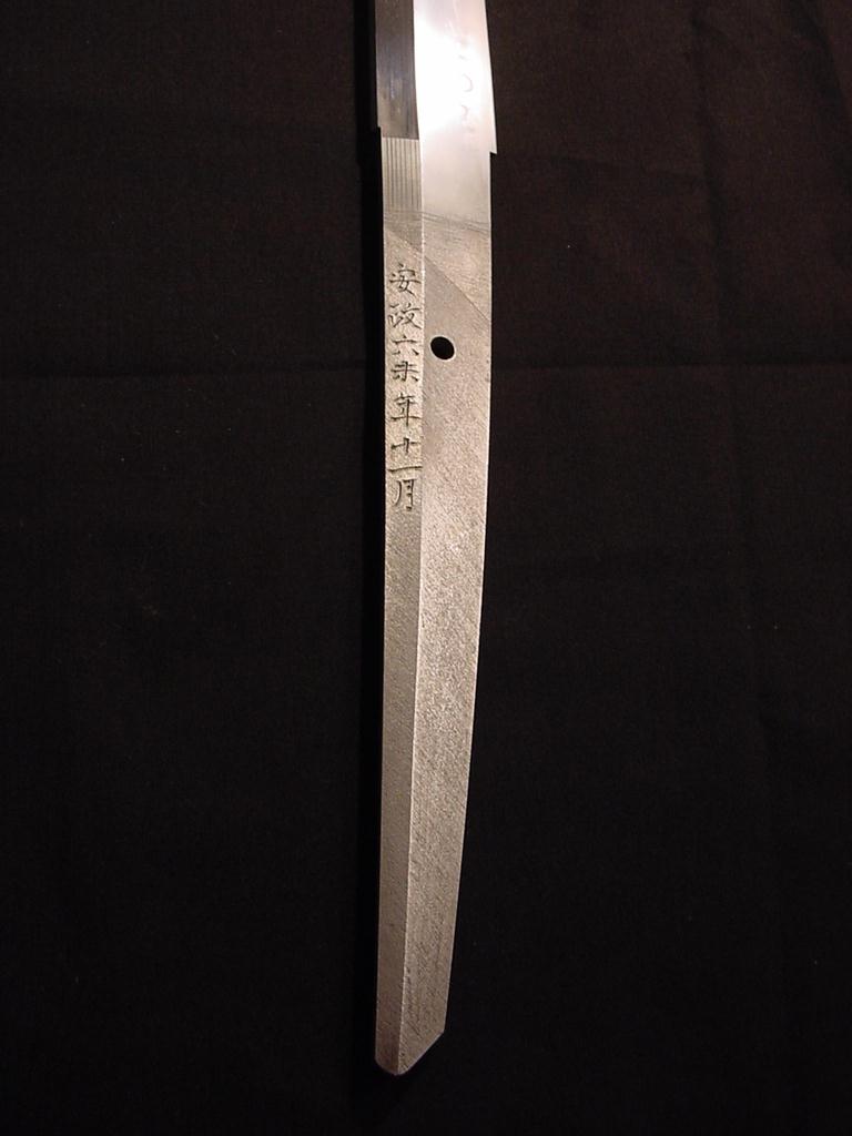

The nakago being no less a part of the studiable parts of the whole sword, it should not be neglected, and effort to maintain it should be made in the interest of lengthening it's life. Who wouldn't want to see magnificent examples of old swords when they were received by the original owner? What could be learned from them? Below is an example of a sword that displays a nearly pristine nakago. You will note that the mei dates this work to November of 1859. This is an absolutely genuine sword with no doubts as to it's provinance. It is a family heirloom that arrived in the U.S. shortly after it was made. When I first saw this sword, I thought it was a gendaito until I read the signature, then I thought it was gimei until I learned it's provinance. The actual blade had some condition issues and it was subsequently repolished......only the second time it had ever been touched on stones. The main reason for it's conditon was that the nakago remained reletively untouched for literally decades with the rest of the blade had been examined. I'm not sure the shiratsuka had ever been removed from the sword until I saw it. It resided (and still does) in a dry climate.
If oiling and wiping promotes the conditional life of the nakago, it's to at least hinder or offset the effect of handling. If the sword is left untouched and in an optimal climate it will maintain as conditions allow. Humidity, ambient temperature and environment will vary of course. I believe that if a sword is maintained, it should be reasonably maintained in it's *entirety* *depending* on the particular demands of those conditions of environment and handling. I think we can all make a judgement between preservation and neglect. If prudent maintenance of the nakago shows that it still is turning color, staining, etc., that to me would just be the natural "tincture of time" that is happening and trying to correct that would then fall into the alteration catagory. One certainly should be careful about wanting to see new things "age". Let's face it, we'll never get to see a new sword's nakago with that lovely velvety patina it will have in 700 years, any more than we'll see a pristine patina free Awataguchi Hisayuki nakago the day it left the forge.
I guess what I'd say is; let time work, but try not to interfere with it by either maintaining when not needed or neglecting maintainance when prudent.
