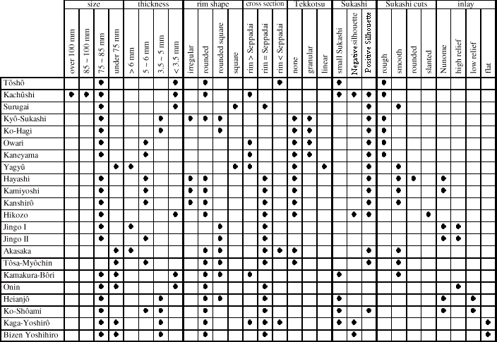

Thierry BERNARD Posted May 9, 2014 Report Posted May 9, 2014 Actually, thickness and relative thickness at the seppadai and mimi are kantei points. John Quote
BMarkhasin Posted May 9, 2014 Report Posted May 9, 2014 Junichi, John has hit the relevant points in his posts. Thickness is variable in any period, and was especially so in the Nambokucho through Muromachi, since this was a time of transition in blade style. You cant point to any one line of reasoning to account for the relative thinness of the plate in some guards (especially kokat and kotosho) . Balance, size, aesthetic, structure, economics etc are intimately linked and all played a role in early guard styles. As to kantei points, it is generally accepted that especially early to mid Muromachi iron guards are thin in the plate (~2 mm), and the kokachushi group had thicker rims to balance the thin web and provide some additional strength. Some of the rims also were ornamental. However there are also examples of thicker iron guards (sans significant sukashi) during this period, so thickness has to be considered along with other attributes. Seppadai shape and style are also kantei points, but not directly related to thickness. I have seen very thick Muromachi guards, very thin Kamakura period guards and everything in between. As to soft-metal examples, it cant be confidently stated that a thin plate equates to an earlier period. I would actually gravitate towards the opposite situation - early periods are characterized by relatively thicker soft-metal guards. Sorry for not providing any clear resolution to your inquiry, but you shouldn't expect a neat/decisive answer to such a complex topic. Best Regards, Boris. Quote
kaigunair Posted May 9, 2014 Author Report Posted May 9, 2014 Thanks Boris, John, and Thierry. Theirry, that's a really great table. Was that one you compiled? Thanks John and Boris for explaining the subject in detail. Thickness and age does seem more complicated now. Most of the reference books/multi-volumes go something like aoi-shaped dolmounds tsuba --> tachi kanagushi--> ko-tosho /ko-katsushi/kagamishi, then split with a onin --> heianjo -->Yoshiro or early sukashi-->nobuie/kaneiye etc. Are there any books that focus on pre-edo tsuba & fittings (excluding ko-mino/ko-goto)? I have a small book on kagamishi tsuba by sasano; some of the examples there, if I recall correctly, don't seem to be kagamishi. Uchigatana no koshirae provides some good pictures of early tsuba in situ. Are there more books like that one? Lots to think about. Quote

Thierry BERNARD Posted May 10, 2014 Report Posted May 10, 2014 Theirry, that's a really great table. Was that one you compiled? The chart is the one published by Robert Burawoy in the January, 1997 issue of the "Bulletin" of the Association Fanco-Japonaise, Paris. 1 Quote

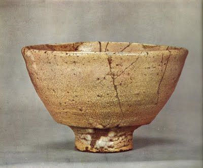

Marius Posted May 12, 2014 Report Posted May 12, 2014 Pete, In the light of the history of the Kizaemon bowl your theory sounds pretty plausible Or have you stumbled upon any sources? Quote
Pete Klein Posted May 12, 2014 Report Posted May 12, 2014 Marius -- I came to this idea while studying Nobuie tsuba several years ago. Nobuie were made about the time of Nobunaga Oda who was a student of Rikyu. Study of Rikyu, wabi cha and a bit of logic. There has to be a reason these survived and this makes sense. In a humid country such as Japan for steel tsuba to survive over five hundred years requires conservation and the most likely to do this would be those of higher rank who have the means to store what they appreciate. BTW -- a picture of that bowl used to be my avatar. Quote
