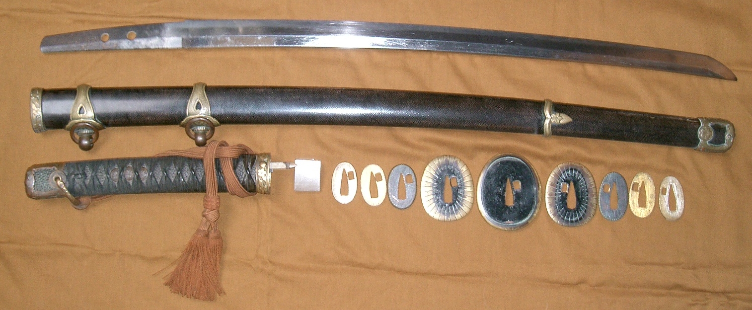

Thank you so far for input Gabriel. I can guarantee it is 100% authentic as I have a pic of my great uncle in the military hospital at Honolulu holding the same sword as I have in my possession, and it has been safely guarded since it was acquired. Here are a couple more pics. I am being as discreet as possible as it is a priceless heirloom and my most prized possession. Can never be too careful. :)

From what we can see so far this is a kaigunto with the rather attractive lacquered same saya, unusual, and a combat cover. The blade is likely to have a small stamp in the nakago somewhere near the signature, pictures of that and the blade flat on so that we can see it all would also be useful.

New pics!!! There is a marking above the signature....and there's another piece of signature under the rust!!!! I can't really Make the rusted part out, but you can definitely see some strikes. Also a pic of the tip, and of the hamon. And the full blade
It's a nice naval officer's sword. The showa stamp above the signature means that it is an arsenal blade and most likely not hand forged. The mounts appear to be very well preserved, and I would estimate its value between $1000 and $1500 or so.

If you have done some research you will have noted that stainless steel blades have a completely different appearance on the nakago, (the magnet test is fine but some stainless is magnetic and you don't need it to see this.) It is not uncommon to find normal steel blades in kaigunto, though probably less common to find the stainless ones in shingunto mounts.
As to the date, as there is none on the sword all you can really assume is that it was made in or before 1943, the pattern was introduced in late 1937.
The lacquered same saya is not common, most are plain black, some have a different lacquered fish skin but yours has the full deal. It also has a combat cover which is slightly unusual, though given that you know where the sword was captured this makes sense.
It's a nice example and deserves to be looked after quite apart from your own important family history.

Keep it in the family,the saya is a beauty,and it's high quality fish skin.
Congrats on your sword,I was told there was 1 naval sword to every 10 army swords made.
Get the history altogether, and medals documents.
You will have a stunning display.
And you have a naval sword knot, getting harder to come by, especially now the Chinese are so adept at fakes.

Regarding the history, it's possible it's a marines sword, there are numerous search pages, search ija marines,and images and, where your family member fought,see what you can find.
Seki blades are never nice to kanji readers as they are always chippy,and not we'll signed(some exceptions before I get hung are),still a piece of history with a tangible story,congrats!

I like it,even if it is undocumented,don't be downhearted, many documented smiths have little to nothing written about them.
Seki was a hub for swords in the war,and many were mass produced.
But to have one that was used, and a story proving this is as good as any untraditional made blade,that is documented.
There are provincial smiths, that made,beautiful blades, but we're never documented,as they didn't have selling skills, or were family village smiths,some say they made blades better than many documented smiths.
