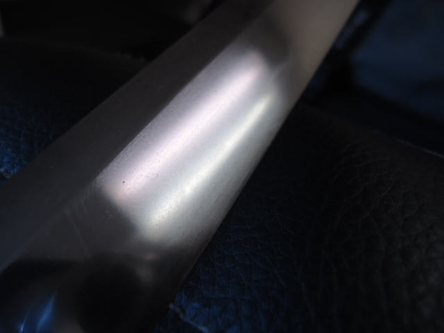

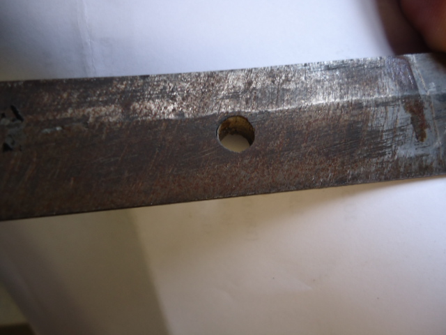

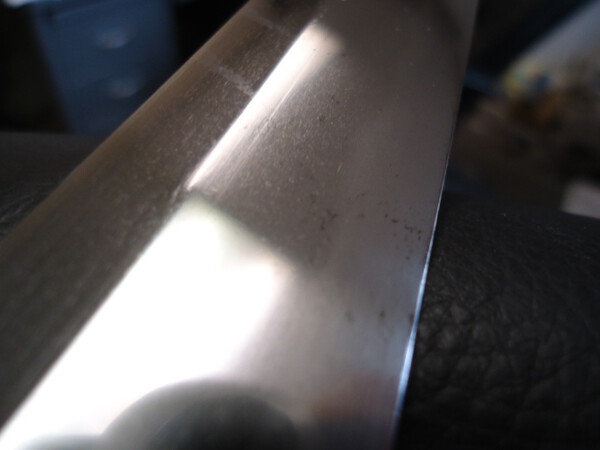

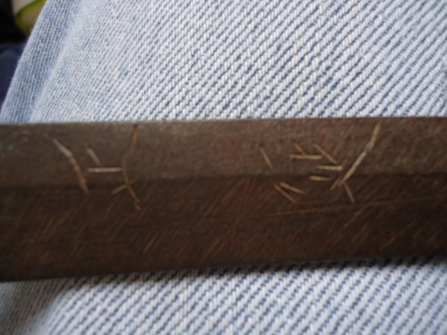

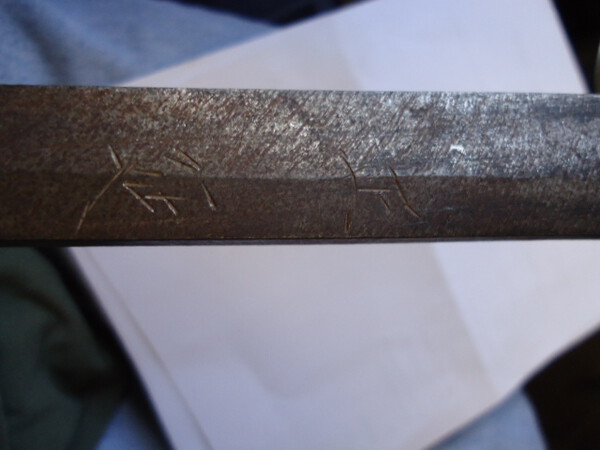

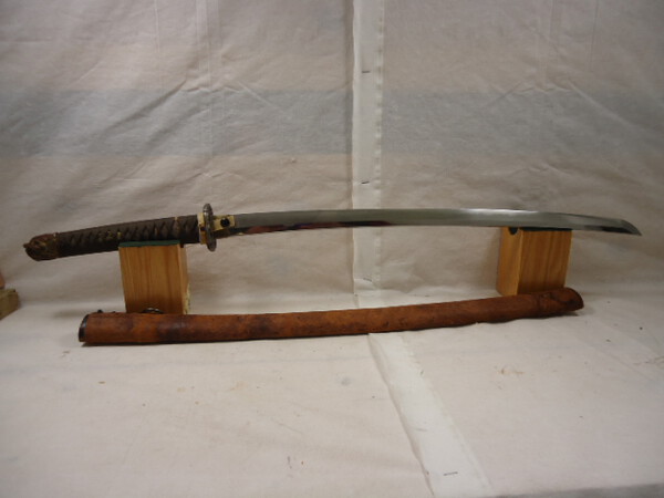

I recently acquired a WWII vintage sword and I'd like to learn some more about it. It is out of polish, but not in very bad shape overall. My main question- is it traditional (Gendaito) or is it a mass-produced junk blade? Also I'd like to know the maker if possible. The mei is only 2 characters as shown, it's the only markings on the tang, there's nothing else. Any and all opinions, good or bad, will be much appreciated! And I apologize in advance for the quality of the pictures, I have a heck of a time trying to capture the temper line. My eyes see it fine, it's just the camera... Thanks,
Kory
Hi Kory,

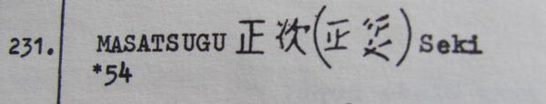

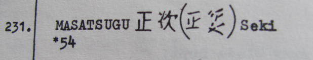

Possibly Masatsugu. Seems to match a signature in one of Fuller & Gregory's books of a smith who signed Watanabe Masatsugu. That blade had the Seki arsenal stamp. Judging from what I can see of the blade and the chippiness of the signature I would call this non-traditionally made Showa-To. Not junk but not a treasure either.
Grey

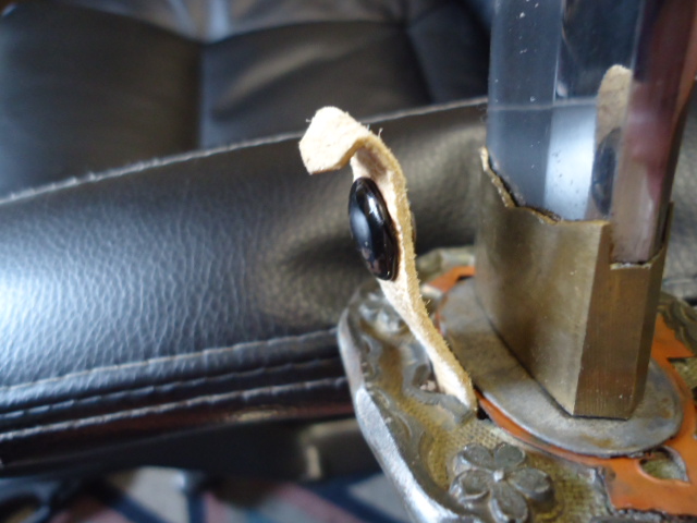

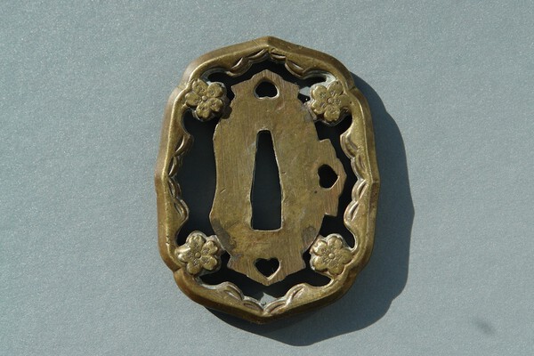

Hey George

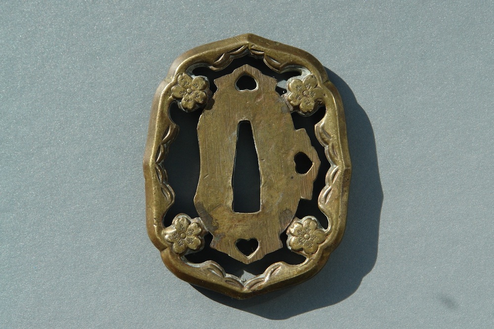

If you pick up on this, isn't that tsuba the one we discussed, one fitted for the leather and press stud fastening?

MasaNobu ...based on previous guidance, but I defer to those that have the books!
Unless my eyes deceive me, this is identical to a Showato I picked up very early in my collecting journey...discussed in the attached thread. Not a traditionally made sword...not Gendaito. The board cautioned me on the price and saved me from making a big mistake financially. As you'll see from the thread attached, mine is in a civilian koshirae. As Grey said, not junk for more of a historical artifact of the WW2 period and valued as such (generally less than $1,000)...sometimes significantly less ;) .
I find it interesting that this smith did not seem to have any arsenal stamps, although I believe he was a Seki smith. Not sure if that means he was just before the War time arsenal stamping mandate or for some reason did not meet military standards (which I doubt). I did not find any interesting information on this smith.
Ben M.
Yes, I think Masanobu also. (Watanabe Masanobu (Watanabe Seiichi) registered as a Seki kaji on April 7 1941).
About the tsuba...as Dr Fox says, it is a rare type for sure as it is the sukashi gunto type but with a hole for the leather press-stud strap to pass through (the first? I have seen...unless the one Dr Fox and I discussed is the first?). Having said that, it is of no great significance, just a rare WWII fittings variation, of value/interest to militaria collectors.
I don't know if this has a Seki stamp, but looks probably showato IMHO.

Thank you all very much for the replies and opinions. I bought the sword under the initial assumption it was wartime/non traditional construction, but I held out that sliver of hope that maybe the blade would turn out to be made in the traditional way. There is no arsenal stamp or any kind of military stamp on the tang, just the two characters shown. That had me wondering... This was no Ebay purchase or anything like that, rather it came from a WWII vet's family directly.
My eyes are not as good as they used to be so it is inconclusive to me as to whether I can see any grain pattern in the metal. The temper line looks better in person than I can capture in pictures, though there's just something different about it compared with the limited number of true nihonto blades I've personally seen. I thought maybe because it is out of polish, but most likely because the blade was mass produced.
I'll try to post some additional pictures a little later of the fittings including the tsuba and saya. It does have a leather snap attachment which goes through the tsuba and connects to a snap on the saya. The saya is wood wrapped in leather, not metal by the way.

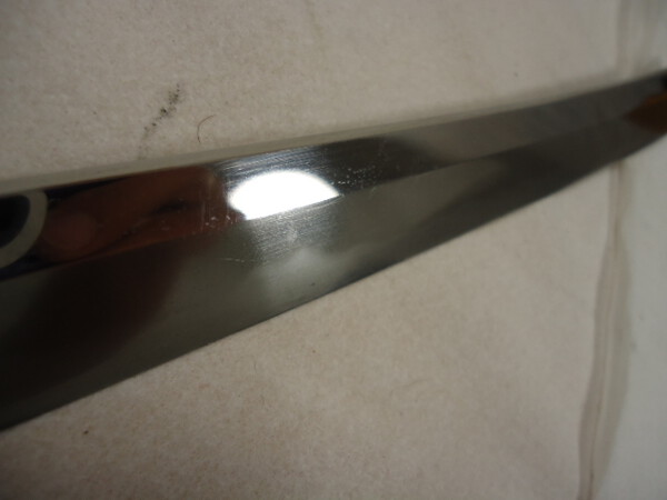

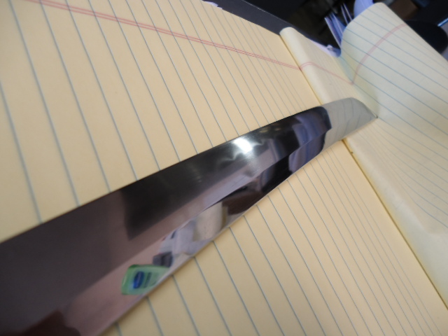

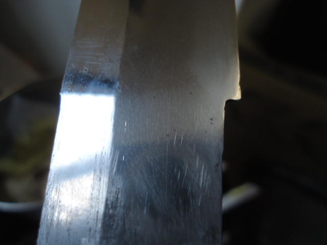

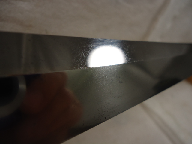

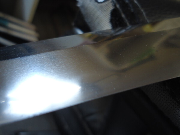

Kory: Perhaps a few more close up pictures of the jihada and hamon.
Ben M.

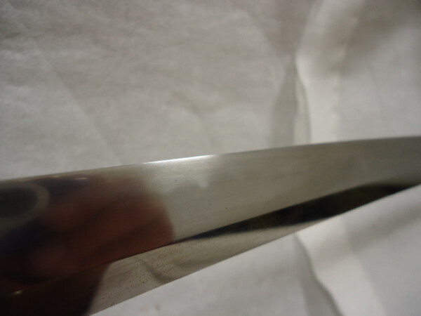

Here are a few more pictures. I will try to take some better quality pictures of the blade soon and post asap.
About the maker- I read on a Japanese sword index website that there is a "Hizen kuni Masatsugu" which is known to have made gendaito of WWII vintage. Apparently this maker made blades which were papered by NTHK and/or NBTHK. Same maker? I have no clue...

Hmmm...Grey, that does look to be the same mei shown in F & G #54, but I would say that it is a mis-trans of Nobu.
About the lack of stamp. The use of showa and seki stamps overlapped c.1940-42. The sho stamp was first, 1938?. It was a govt. mark and the seki stamp was an Swordmakers Assoc. mark, c.1940-41? signifying that the sword met the govt standards and those of the members of the Seki Sword Assoc which was set up around 1941 to make affordable, reliable war swords.
I would say that maybe the 3 swords were made before Masanobu joined into, and was registered into, the Seki Kaji group in 1941.
The rare gunto tsuba and the civilian mounts (these appear to be showa) suggest these were private order, and privately mounted...one to suit a military customer and one maybe for an iai student...just guessing though.

Hi George
On close up it can be seen the tsuba is another type to mine, it is not sukashi! It seems pierced only to accept the press stud.
The mei is so poorly cut that it could be a mis-trans of Miss Piggy. Who knows?

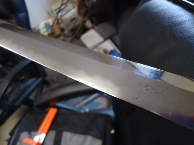

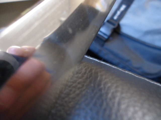

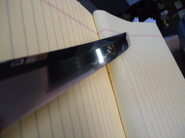

I'm still not quite sure what to think about this blade. Here's some more pictures, hopefully they show something more definitive to one of you guys who has much more knowledge than I. No arsenal stamp on tang, I do see tight grain, temper line is inconclusive to my untrained eyes. Is it oil quenched? Is the blade machine-made? The blade is out of polish and/or of wartime quality polish so I don't think that helps things much. On this board I realize the WWII era blades seem to be generally looked down upon and all are considered pretty much worthless/non-art unless they are signed by a famous well-known maker. Being that this blade is not by a famous or well-known maker, I hope I'm not wasting my time or anyone else's here.
I may consider getting a finish polish done on it, that is if I decide to keep it. I don't really care how much it is worth, nor would the polishing cost really matter, it would be simply for a better looking display piece. Or if the blade is indeed trash, and the more rare through-tsuba snap thing makes it more desirable to a militaria collector, perhaps I'll flip it to one of them so I can acquire more Allach porcelain which has been the focus of my latest collecting spurt. Thoughts?
