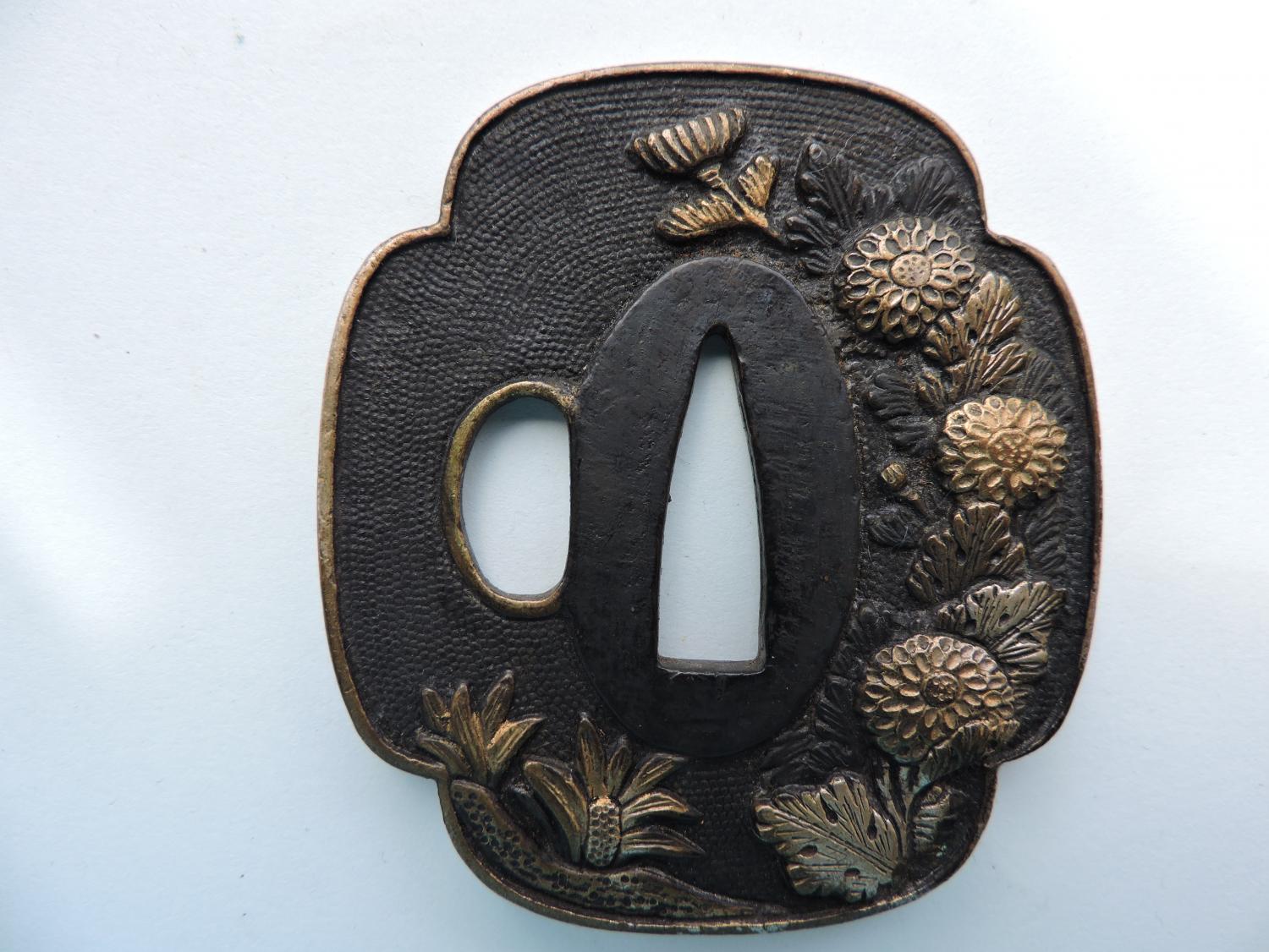

kaigunair Posted April 20, 2014 Report Posted April 20, 2014 :D Came across this listing with NBTHK papers to Kyo-kanagushi: http://tsuba.jyuluck-do.com/TU10481.html Some pics from the listing: Quote
kaigunair Posted April 20, 2014 Author Report Posted April 20, 2014 And thought, "boy, that looks alot like the tsuba that came with a koshirae I picked up a while ago..." Pics of my tsuba: Quote

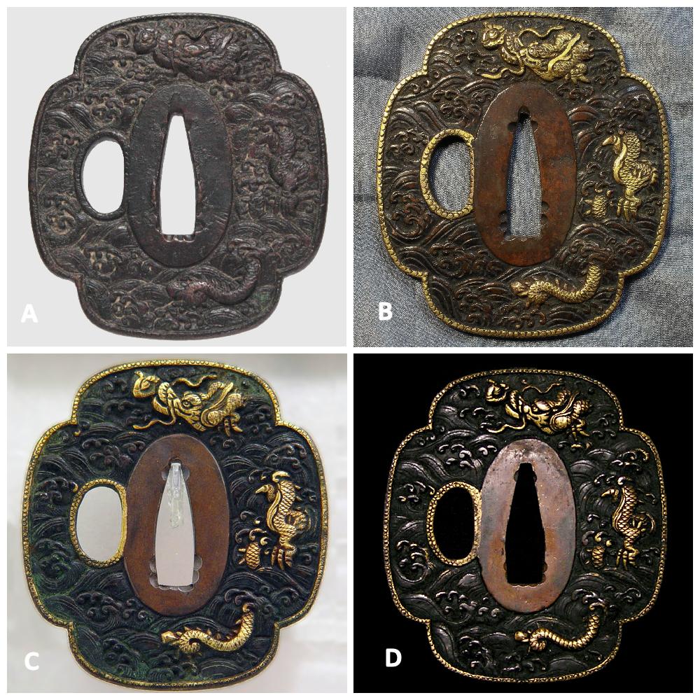

MauroP Posted April 22, 2014 Report Posted April 22, 2014 Please see the following image I have already submitted to INTK forum (http://www.intk-token.it/forum/index.ph ... topic=8273): Tsuba A is mine, previously in W.M. Hawley’s collection. Tsuba B belongs to a fellow Italian collector. Tsuba C (surprisingly described as "Jakushi style") is from http://www.silk-road.us/kinko1.html. Tsuba D is the same one posted here from http://tsuba.jyuluck-do.com/TU10481.html. This kind of tsuba is obviously a shiiremono (仕入物), probably obtained from molded pieces and subsequently refined by handmade chiseling, since kebori carving is differently represented. Bye, Mauro Quote
kaigunair Posted April 22, 2014 Author Report Posted April 22, 2014 :D shiiremono? Even though the NBTHK paper clearly states kyo kanagushi? Multiple near identical copies alone would not mean low quality mass production item. And example A is in pretty poor condition. I can provide macro shots of any area of my example for side by side comparison shots to rule out kyo kanagushi and confirm shiiremono/hamamono as well as construction techniques. My, what an interesting thread this just became... Quote
MauroP Posted April 22, 2014 Report Posted April 22, 2014 Hi Junichi, well, shiiremono means mass production, and mass production usually imply lower quality in comparison to unique or small-series pieces. Anyway shiiremono do not means fake tsuba. After all Kyō-Kanagushi is not really a school (with a shodai, pupils, definite generations and so on) but rather a classification of a style, so ours tsuba may be legitimate pieces of Kyō-Kanagushi tradition and shiiremono as well (i.e. lower level Kyō-Kanagushi pieces). That's the way I see it. Bye, Mauro Quote
Marius Posted April 22, 2014 Report Posted April 22, 2014 No need to look at any origami with this piece. Clearly a shiiremono and Mauro's explanation is spot-on. Quality matters. Quote
MauroP Posted April 22, 2014 Report Posted April 22, 2014 Quality matters, but seldom I can afford it... Hi, Mauro 1 Quote
Soshin Posted April 22, 2014 Report Posted April 22, 2014 Hi Everyone, I reminder back six months or a year ago that Pete K. did a ranking of different Kinko attribution based on a quaily scale and Kyō-Kanagushi was at the bottom. Generally speaking NBTHK does not paper shiiremono with that said the Kyō-Kanagushi attribution is a low one. Quote

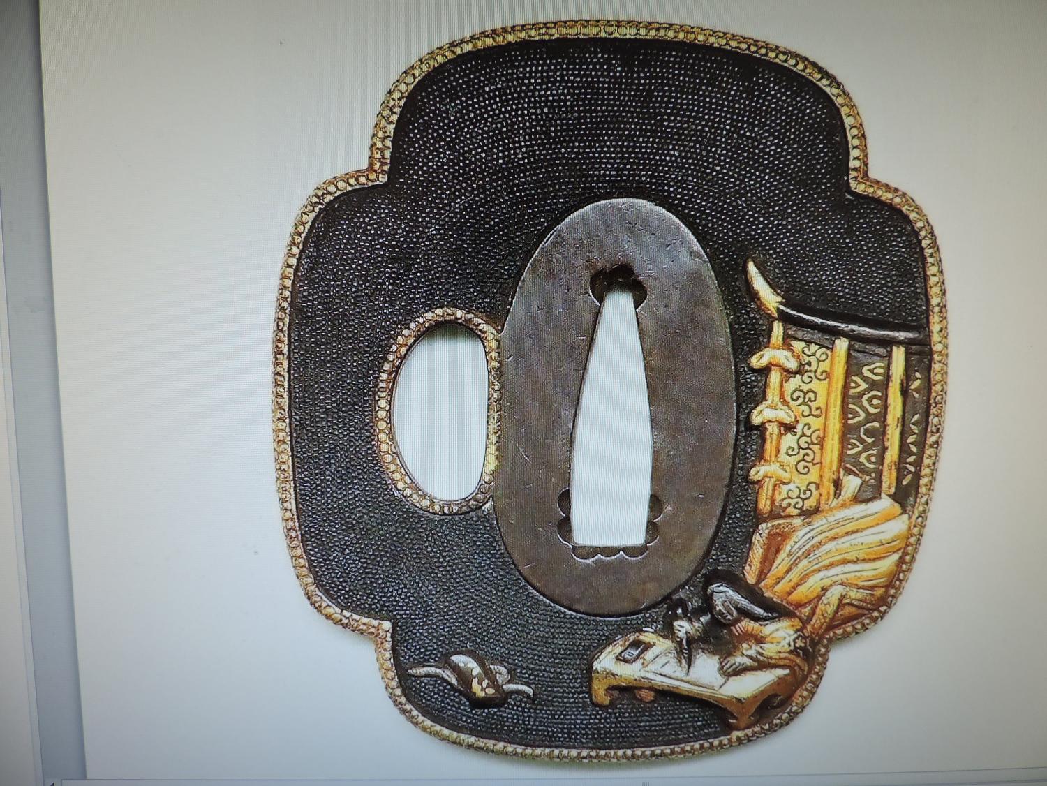

kaigunair Posted April 22, 2014 Author Report Posted April 22, 2014 here's another example, dragon looks identical (well, this one is a female), but with a completely different background! Mauro, does this fit into your construction theory? Or is this just a style/motif that was done profusely by this group? Quote

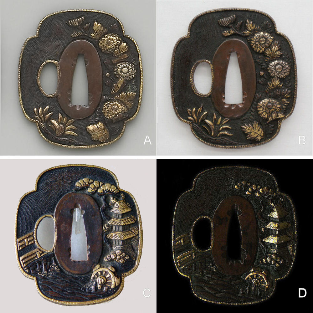

MauroP Posted April 22, 2014 Report Posted April 22, 2014 I'm not so confident about the sex of the dragon (considering the moustaches he/she is wearing...) I don’t think it’s just a matter of very popular motif; the serialism of production was the rule for this kind of low level tōsōgu. See a couple of more examples here below: A from: http://www.bonhams.com/auctions/14043/lot/6092/ B from: http://www.aoijapan.com/tsuba-mumei-chrysanthemum C from: http://www.silk-road.us/shakudo3.html D from: http://www.ricecracker.com/inventory/94 ... agoda.html Note the characteristic disposition of chisel marks around nakago-ana, which probably configure as a tagane-mei (鏨銘). The different pieces are variably refined and patinated (for instance I think my tsuba received a shakudō-like patination from its origin and never got golden gilding), but all share the same overall dimensions. Bye, Mauro Quote
kaigunair Posted April 23, 2014 Author Report Posted April 23, 2014 moustashes...or whiskers. With dragons, it's all in the tail. I think it's more important to nail down the construction techniques in order to support or disprove the NBTHK certification. You had mentioned these were cast, which would be a good indicator of shiiremono vs kyo kanagushi. does the new dragon example, with a completely different background support this? Would also be good to get close ups of your example; it is relatively unfinished compared to all the others, so we would want to rule out yours being a cast copy of one of the others. Quote
kaigunair Posted April 23, 2014 Author Report Posted April 23, 2014 More thoughts: Thanks for the additional examples Mauro. From the additional pictures of the "flower" and the "building" theme, one might make an observation that A appears to be a possible copy (maybe cast + finishing) of B. Similarly, D is a cast copy of C. There is a funny outline on A, and the details don't seem a crisp. Mauro: how well defined is the edge work on your example? It seems to lack any depth/definition of the punch marks compared to the others, but that might just be the photo.... I think I missed your earlier post where you posit it might that the tsubas are both kyo-kanagushi and shiiremono. It does make me wonder whether the NBTHK does or does not paper "shiiremono" since it is a term that can have different definitions. But I'm pretty sure they wouldn't want to paper a cast copy type tsuba. If all these tsubas were made from casts that were later "refined", then I feel the NBTHK papering would have been done in error. If these were merely a style of tsuba and properly labeled kyo-kanagushi, then the NBTHK papers are ok. Now if some are cast and some are not, that too would be an interesting development. I can see a production/workshop/"atelier" set up where a standard base plate was made and possibly the "nanako" (very loosely used) edge work was added. Then the plate was given to someone to carve out the background as well as the dragon. It might be that the dragons/flowers/pagoda are made separately and inlayed onto the base tsuba vs carved from the ground, before being sent to a person to do the ground work (but doesn't seem like it in my example). This would explain the consistency of the backgrounds, as well as the examples with a completely different background. For a higher quality example, it would also be similar to the use of subcontractors by the goto for the ground work (yoshioka, yasuda, nomura). If the only thing "cast" in this example was the base tsuba shape, which for kinko is nothing significant, then the papers would be ok. But if the other elements like the edge work are part of the cast, or if the dragon/flower/pagoda are stamped/pressed/cast pieces and inlayed into the base tsuba, then I would feel the papers were given in error. We would also want to make sure we're not dealing with two different "workshops" here: one workshop that made low quality (but carved) kyo-kanagushi, and another that made even lower quality cast copies of these for export (i.e. the real shiiremono). So while these are far from any goto works, it does seem like they might have some value to add about our understanding of late period tosogu production, as well as papering criteria. Quote

MauroP Posted April 23, 2014 Report Posted April 23, 2014 Hi Junichi, I’m planning to take better pics of my tsuba, but I’m afraid it will take me some days. The nanako finishing on my tsuba is possibly worse than the other tsuba posted, but I think it’s just the wearing of usage. Telling the truth, the finishing of the borders in any of the tsuba posted here can hardly be defined nanako, since the round chisel marks fail to form the characteristic dome-shaped lumps. Prove (or disprove) the construction technique could be very hard. Casting soft metal tsuba was a common practice since Muromachi period (e.g. Kagamishi tsuba), so why not using similar approach for mass production in late Edo? Moreover in none of such tsuba we can find true inlays, since the golden coloring was probably obtained by amalgam/mercury gilding (as in most of sanmai tsuba - 三枚鐔). Bye, Mauro PS - about "paperable" and “non-paperable" tsuba: I deserve high regards to shinsa origami, but after all it’s just a (very) educated opinion written in good Japanese… Quote

MauroP Posted April 25, 2014 Report Posted April 25, 2014 Here are some high resolution pictures of my tsuba, as required by Junichi: https://www.dropbox.com/sh/7hh9tfc706g0 ... hi%20tsuba Quote
kaigunair Posted April 28, 2014 Author Report Posted April 28, 2014 Hi Mauro, Thanks for the hi res pics. Still not sure about the rim and the weathering of the surface makes it really hard to tell if the details were cast or carved, at least to me. Been a very busy weekend, but a nice one for tsuba studies as the club set up at a local sakura matsuri. Hence the delayed response. I'm not sure we'll get any additional forward momentum on this without the help of more experienced eyes. But thank you so much for adding a lot to the thread and lots of good questions to ponder about construction and papering. Grazie mille! Quote
