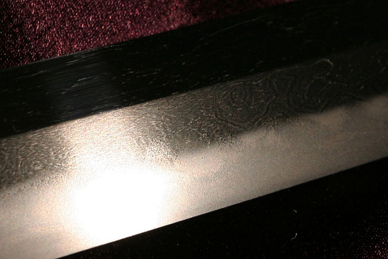

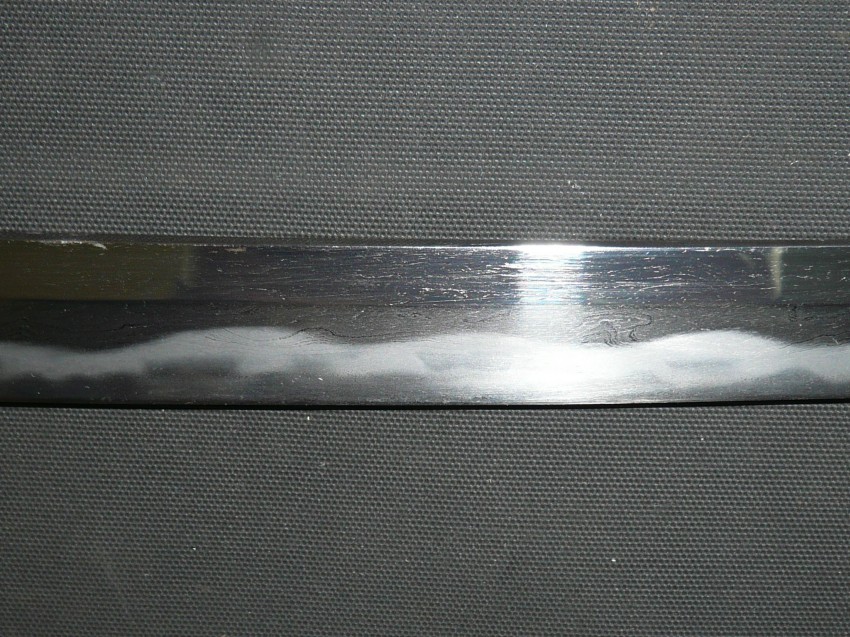

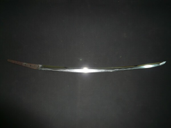

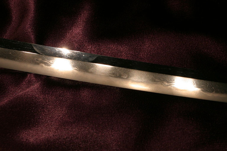

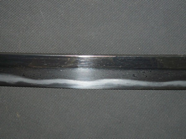

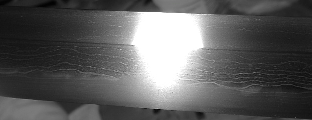

My mentor has just acquired a most interesting tachi, & we spent three hours this evening trying to puzzle out school & smith.
The sugata is Nanbokucho, overall length is 95 cm, hacho 68.1 cm, sori 1.5 cm, blade width at machi 3.0 cm, iori-mune. The omote hamon is yahazu-midare, & ura hamon is gunome-midare. There is literally a river of chikei running uninterrupted the entire length of the blade, with sungashi & inazuma, nie-deki, with sumigane & uzumaki. The fukura seems a little flat. The nakago is ubu, with two mekugi-ana, & with tachi mei that neither of us can read because of really nasty rust.
I'm including a number of photos, & would appreciate any comments & ideas on categorizing this remarkable blade.

Fools rush in, they say so here goes.
Nambokucho sugata but 68 cms and ubu? The chikei immediately makes one think of Norishige, but there were others who produced it too. Have a look at this, http://www.nbthk-ab.org/Kantei/kantei1_answer.htm However this one is almost the same nagasa but o suriage. For a Norishige ko dachi check this one out, the images are little use but might be worth an e mail to the owner, http://www3.telus.net/sword/sword/index ... 0items.htm
On the other hand this chikei seems pretty strong and rather too overt. I have seen something like this in shinshinto so the possibility that this is utsushi mono suggest itself so have a look at this, viewtopic.php?f=4&t=18327&p=164196
Probably no help at all but I enjoyed looking at the sword so thank you anyway.
All the best.
Awful polish, habuchi is not visible, hadori finish is very sloppy. From what I can see hamon seems nioi-based, not exactly typical for earlier blades. Not chikei, but layers, probably exposed by acid.
This came from daimyou54eb on eBay - he is known to carry rather low-end items, but occasionally also good stuff (I recall a story about a good Hizen sword bought from him). But that is not a kantei point :glee:
Interesting puzzle indeed, but in the current state of polish I would not jump to any conclusions. Do I see the remnant of a signature below the lower mekugi ana?
I agree it is not Chikei. I think it is other steel mixed in. I have it on my 1912 Enju katana when they were experimenting with steels I think.
Interesting sword though, think it would polish up nicely. Nice sugata.
Brian
I would call this Hadatatsu/Hadamono.
P.S.: No disrespect, Ken, but if your "mentor" bought this sword from one of the most notorious eBay sellers, and even doesn't know what it is, it might be time to look for another mentor ... :doubt:
Harsh, but fair.
Nah, my twin is still securely locked up - I really didn't mean to be harsh, but there are quite a few self-proclaimed "sensei" (just ask the Canadian and Ohio forumites, e.g.) who are/were able to fool people for decades.
Hi Ken,
Sorry to pile-on :badgrin: , am in the Shinshinto copy camp. As for the nakago I'd say a fairly sketchy attempt to fake age is what we're looking at. Regardless, a good sword to bring up for topic to put a good dose of cynicism into the minds of all those wanting nihonto.
The strong black chikei like lines can be seen with retempers. Also the indistinct habuchi, inconsistent and hajimi looking yakiba, the otherwise glassy and faded looking hada, the blistery and dry looking nakago.
Not saying it's absolute, and the polish certainly isn't helping matters, but those are my observations from the images.
