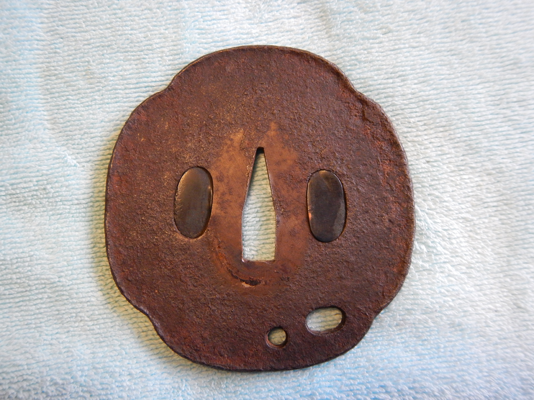

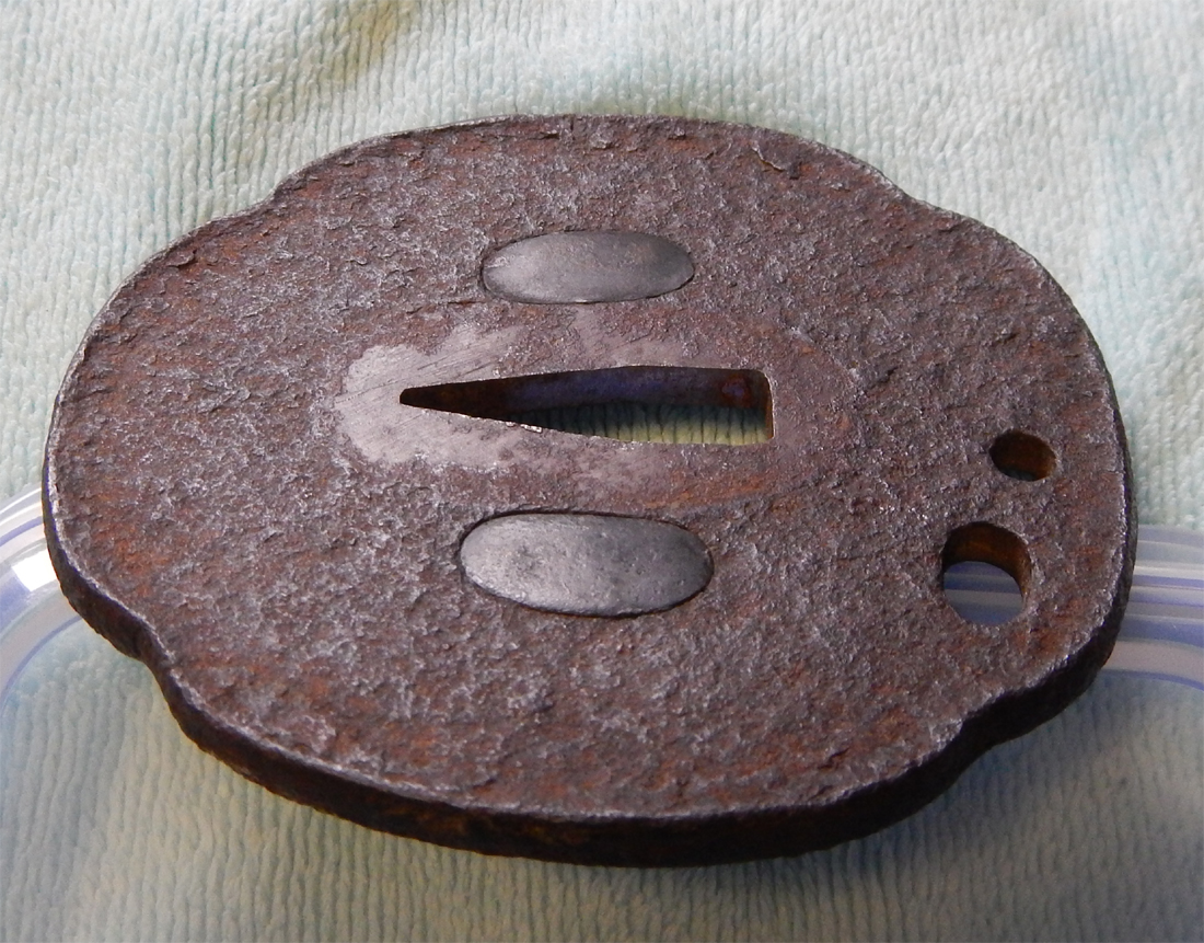

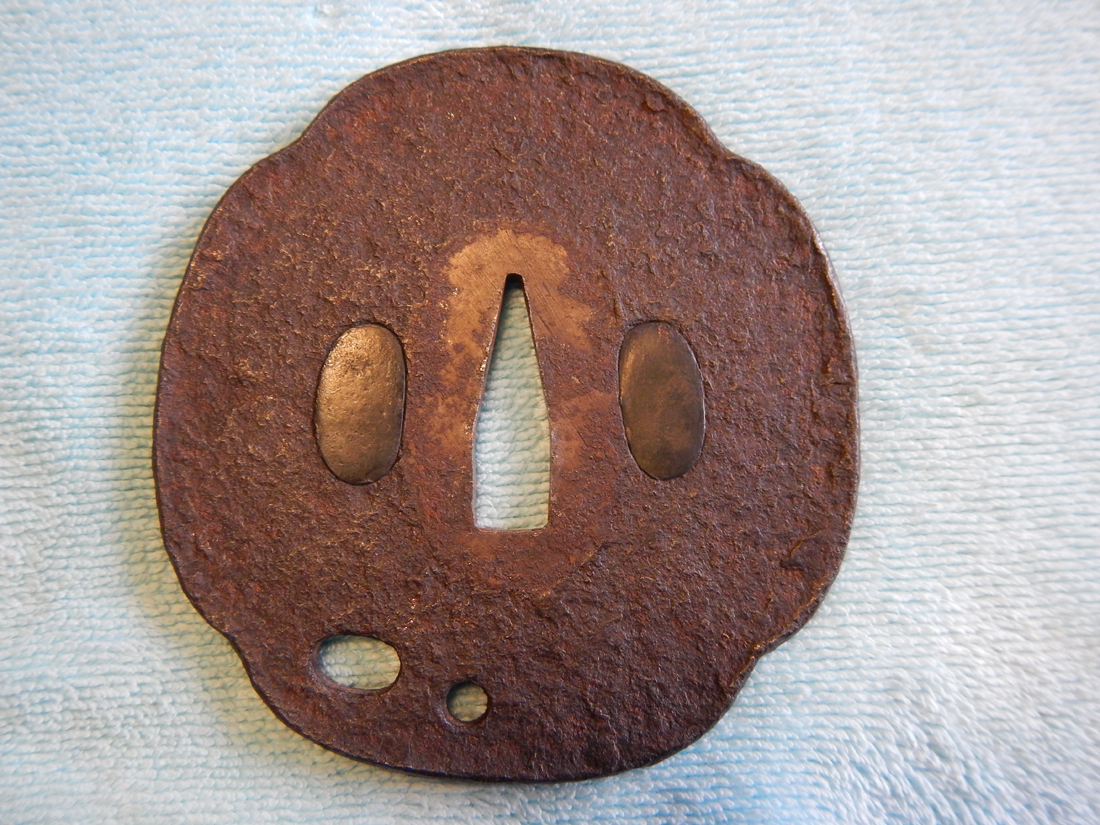

Hi all, It's been a while since i posted but I have been sitting on the side trying to learn from the wealth of experience on this forum, enough of that.
I'm looking for information, thoughts on the Tsuba below. I acquired the piece attached to a nice little Katana by a ShinShinto smith by the name of Inaba Toshizane. I am hoping that the piece is authentic, and not just an after thought.
Any comments would be greatly appreciated.
Regards and best
Chriso :dunno:

Hi Chriso.
Would love to see some pictures of the Inaba sword as I have an interest in them. The tsuba is certainly genuine in that it is Japanese, not reproduction. Looking at the surface it seems that the rust on the seppa dai is much shallower than the rest of the tsuba, could be that this area was protected by the seppa but the fact that there seems little rust inside the two piercings suggests that perhaps this was made at the same time as your sword but deliberately finished to look much older. I had the same suggestion made about a tsuba from a sword from the same province and age as yours which is what made me think of it.
What is the rest of the koshirae like?
Have fun.
Hi Chriso,
The overall design is referred to as mu-mon (無紋) "no design". The small holes are not part of a design they are called udenuki-ana. It is where a leather wrist cord (udenuki 腕抜) was used. I have the same thing on my tsuba of my Budo training katana. I generally notice that one hole is larger than the other.
Guys, thanks very much for your input. Geraint, I'll takse some pickies of the sword for you in the next couple of days and post them in the Nihonto section.
Is anyone prepared to attempt a school or time on the tsuba?
Regards and thanks
Chris o
Hi Chris O.,
I think your tsuba dates to the later part of Edo Period about the late 18th to early to mid 19th century. In terms of school or group I would say your tsuba was likely made by a late Edo Period Tosho (swordsmith). This is just my interpretation of the information provided.
Many thanks for your replies, and an apology to Geraint. I've inadvertently posted the info regarding the Toshizane Sword in the General Nihonto, old timers problems.
Chris O :bang:
