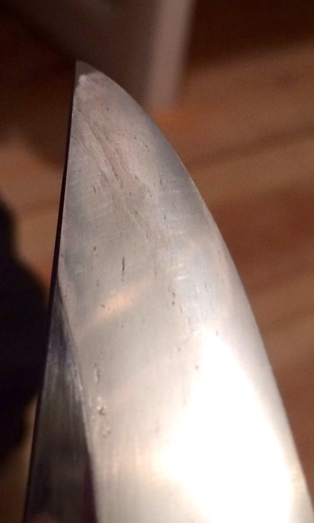

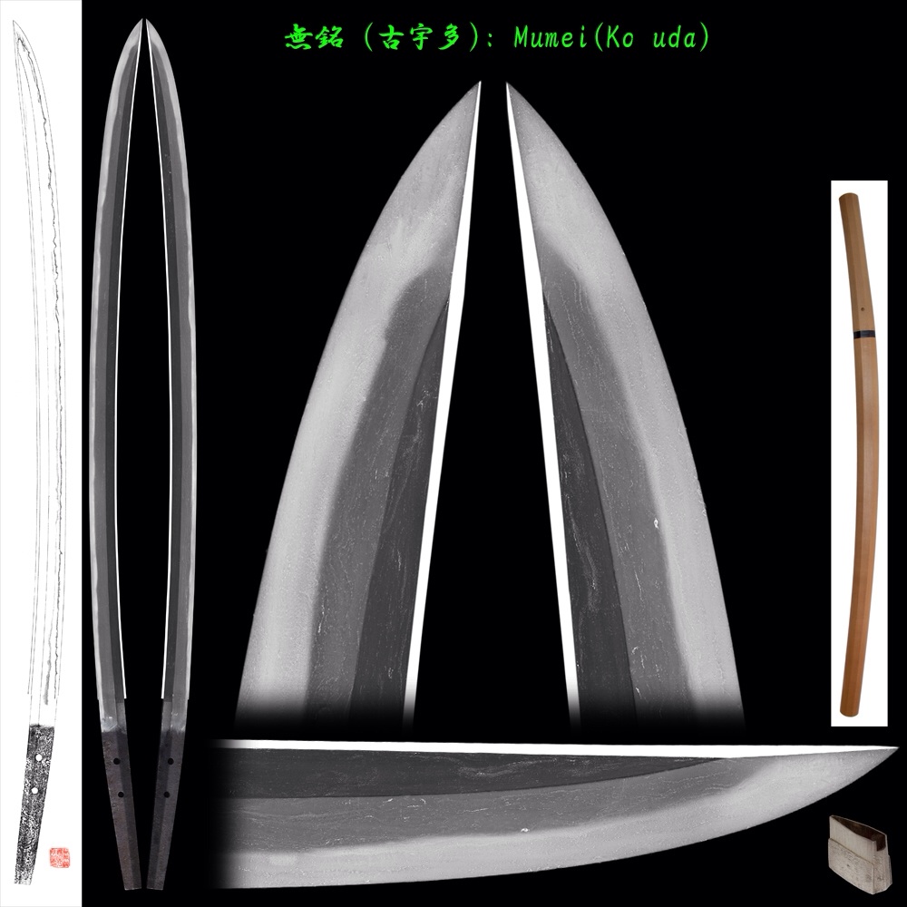

Marius Posted March 23, 2014 Report Posted March 23, 2014 There are two kinds of naginata naoshi I have encountered - the first one has a yokote, which delineates a huuuge kissaki, the other one has no yokote. As far as the kissaki in blades wher a yokote has been done by the polisher, the surface of the kissaki is a continuation of the blade, so that the yokote is just a line, and not a change of angle. I wonder what the reason might be for either of these polishes? Attached are two pics from Aoi Art. Both swords are from the same school - ko-Uda. Quote
Guido Posted March 23, 2014 Report Posted March 23, 2014 ..., the surface of the kissaki is a continuation of the blade, so that the yokote is just a line, and not a change of angle.Most swords don't have an abrupt "change of angle" at the Yokoto - the Yokote is usually placed where the Koshinogi starts to narrow down. However, putting a Yokote on a Nagamaki (-naoshi) looks a little awkward in my personal opinion, I guess it's up to the taste of the owner and/or polisher if one is done or not. Quote
Marius Posted March 23, 2014 Author Report Posted March 23, 2014 Most swords don't have an abrupt "change of angle" at the Yokoto - the Yokote is usually placed where the Koshinogi starts to narrow down. However, putting a Yokote on a Nagamaki (-naoshi) looks a little awkward in my personal opinion, I guess it's up to the taste of the owner and/or polisher if one is done or not. Thank you Guido :-) I also thought this might be a matter of taste. I have seen a Hokke nagamaki where I wish the polisher hadn't made a yokote. But since I loked at the blade and seen almost no change in angle after the yokote, I guess it should be easy to remove it in the course of the next polish... http://www.nihontocraft.com/Mihara_naoshi.htm (good sword, problematic polish) Quote
nihonto1001 Posted March 23, 2014 Report Posted March 23, 2014 http://www.nihontocraft.com/Mihara_naoshi.htm Is that a turn-back in the boshi (the second picture of the kissaki)? Quote
Marius Posted March 23, 2014 Author Report Posted March 23, 2014 Yes it does, and on the ura the boshi is pointed with hakkake. You can't see it in the pics attaced, but I am posting it so show the hakkake. This sword's polish s.cks royally Quote
seattle1 Posted March 23, 2014 Report Posted March 23, 2014 Hello: I think it might be deeper than just the aesthetics of a yokote line looking pleasing or less pleasing, as the yokote line divides, in the usual use of stones on a blade with a yokote line, the movement of the polishing stone from with the axis of the blade to perpendicular to the axis above the yokote. I would guess, and it is only a guess, that the visual effects on the surface of a blade with or without a yokote in the kissaki area will look somewhat different depending on the underlying stone direction. It might be that appearance of stone usage rather than the yokote as such which determines the choice of yokote or no yokote. Arnold F. Quote

nagamaki - Franco Posted March 23, 2014 Report Posted March 23, 2014 It is my understanding (and I'm certain someone will check it out as it should be), in papering, adding a yokote line to a naginata naoshi is that the NBTHK would then define it as a "katana" or "wakizashi", where if the yokote is not added it will be classified as a naginata naoshi. http://japantrip.tripod.com/Japan/osafune2.html Quote

Eric H Posted March 25, 2014 Report Posted March 25, 2014 And when a new owner/polisher go ahead and add a yokote where there never was one how does that change things in the eyes of the NBTHK? Naginata or Nagamaki that have been reshaped are papered as naginata naoshi or nagamaki naoshi regardless of their size as Katana or Wakizashi. Generally the part of the kaeri is removed and thus becoming a yakizume boshi...the occasionally added yokote by the polisher gives the blade a special effect and is perhaps an indicator to identify at a first glance that it is a „naoshi“ blade. That said in the eyes of the NBTHK this is no issue, it‘s merely an aesthetic value by polisher or owner. Eric Quote
