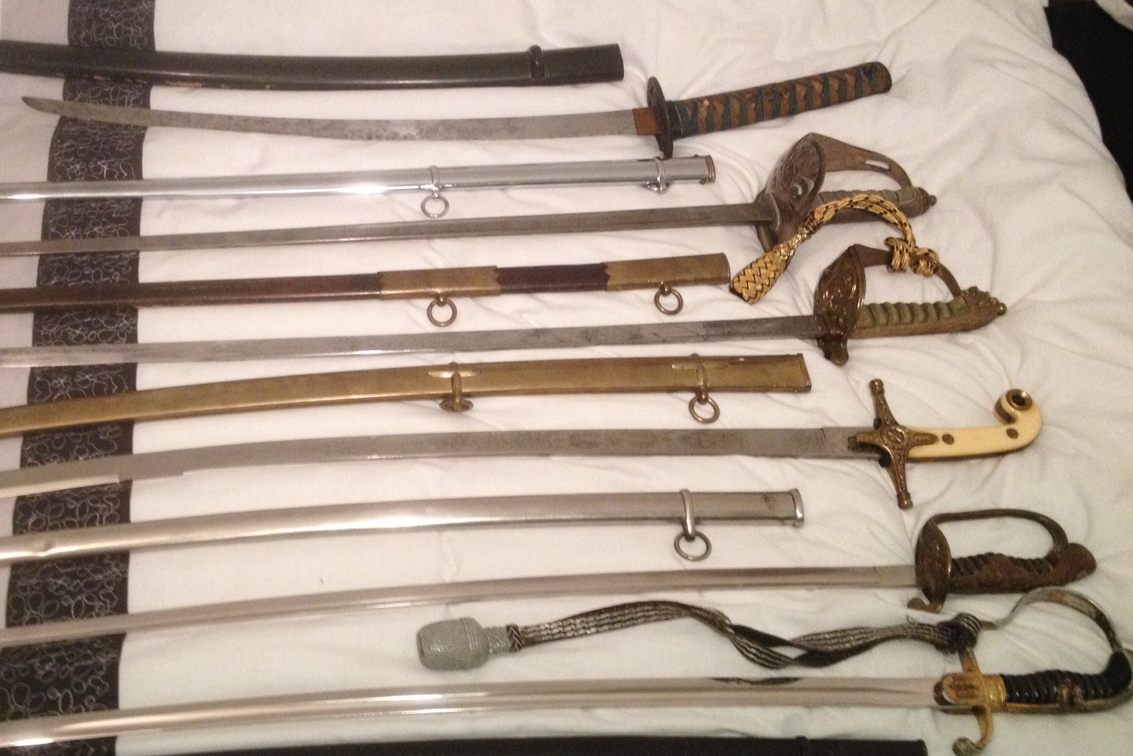

I have included the only picture that I currently have of her (alongside a sabre collection - I apologise to the nihonto purists)

I also forgot to add that I also believe it to be a chisaikatana, as it has the length of a katana, but the blade it self is much shorter than the saya. Though I suppose it's also possibly a mismatch...
