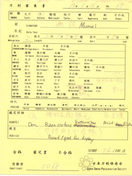

Alex A Posted March 6, 2014 Report Posted March 6, 2014 Is it possible to get an o-suriage blade such as this papered?, a blade with so much taken off, im unfamiliar with what they will accept, a bit curious. Quote
paulb Posted March 6, 2014 Report Posted March 6, 2014 Hi Alex Provided there is sufficient detail visible to indicate what it is and it is in good enough condition it can receive a paper. If it were shinto the highest level of paper would be tokubetsu hozon, as a koto blade it could go higher depending on condition. Regards Paul Quote
Stephen Posted March 6, 2014 Report Posted March 6, 2014 this passed at 74, but later recided because of hagire, so yes they do paper overly cut short nakagos Quote
nihonto1001 Posted March 7, 2014 Author Report Posted March 7, 2014 Hi Stephen: Strange they missed the hagire. I once bought a NTHK papered osuriage Kanabo Masatsugu Wakizashi that had a hagire, from a Japanese Dealer. I returned the sword to the dealer and it later turned up in Australia. The new owner was trying to sell it, unaware of the hagire. IE., until I notified him. Quote

Stephen Posted March 7, 2014 Report Posted March 7, 2014 It would have gone unseen if I had not pointed it out to Chris, not me to try that, but they did pass it at first as very good study blade but when politics come down too it guess they did not want to start a trend on passing blades with hagire and i fully understood that, btw it did have a battle scar on the mune just above it, its what caused it in my mind....water under the bridge. Quote
