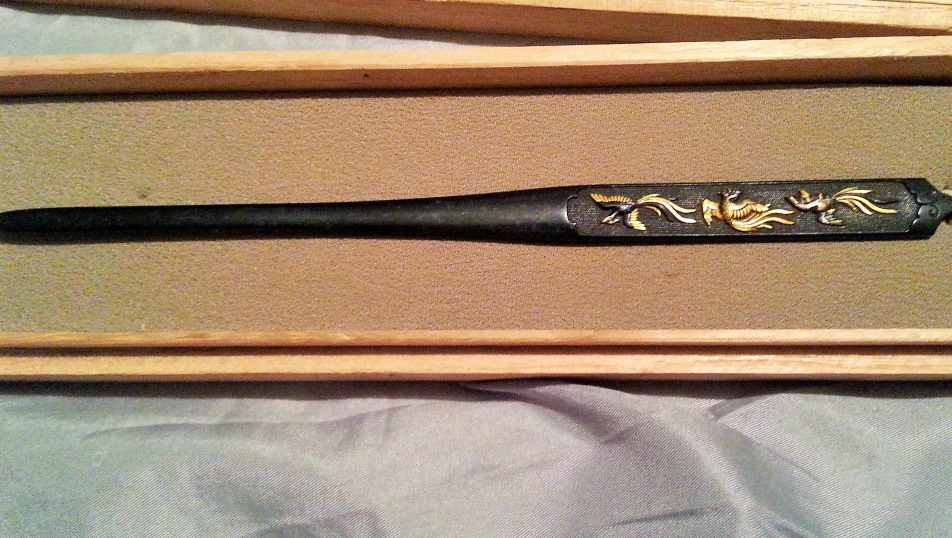

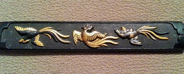

raven2 Posted March 2, 2014 Report Posted March 2, 2014 Here are the new pieces I picked up at the show. I am really at sea about the kinko. If anyone has any ideas on it, I would be glad to hear them. At first glance, the iron tsuba is nothing special, but the surface has been nicely worked with hammer and punch, the hitsu ana has been lined, the omote has what I believe is a hot stamp at about 2:00 and the kiku has fine carving and is still in good shape. The kogai is my first one, but I love the ho ho birds and I think it is pretty well done. Quote

ROKUJURO Posted March 2, 2014 Report Posted March 2, 2014 Fred, Hohoho, what a nice HOO bird! I like this phoenix KOGAI, looks well made! The dragon TSUBA looks, hum, unusual to my old eyes. What is the material? Could it be a recent production? The SEPPA DAI seems to be untouched while the NAKAGO ANA has TAGANE marks from fitting it to a blade. The iron TOSHO style TSUBA was certainly a nice one, but the surface was in my opinion not treated with hammer and punch but with heavy corrosion. The flower is UME no HANA (round petals), and what you see as a hot stamp was probably carefully chiselled out. But others with more competence may see this differently. Quote

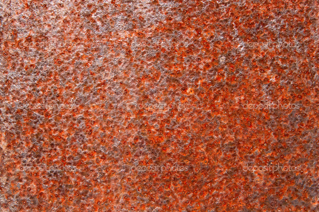

Ford Hallam Posted March 4, 2014 Report Posted March 4, 2014 Actually David, it's not at all regular. Examine the ura, top left quadrant, and you'll notice it's significantly less coarse than the rest of the surface. But why would you expect natural corrosion to be irregular anyway? This is merely a consequence of specific situations and conditions. If you leave steel to rust long enough, and it can take as little as a couple of months, it results in a perfectly even and convincing 'ishime-ji' ground. Now imagine scrubbing the loose surface rust off the example posted below and developing a nice dark magnetite based patina. In my opinion a great number of early Tosho and Katchushi guards exhibit exactly this finish. I think there is far too much talk of hammer/punch marks and effects of forging etc. that's based on what people imagine and not on actual empirical evidence. Just as an example here's an image of exactly that, an evenly textured steel plate' Note the very clear indents, which might understandably be mistaken for punch marks under different conditions. This is a feature of steel corrosion. Obviously this example has advanced to a stage where the surface has been completely covered but it's a gradual process that starts out as isolated points being attacked and gradually develops like a rash. here's an example of an extreme degree of corrosion. It shows well the sort of textural development that severe corrosion results in. This is a micropictograph that shows how pitting starts. What you can see, the overall 'stonewall' appearance of the surface, is the grain boundaries of the crystals of the steel. Corrosion begins at these boundaries, typically where three or more 'islands' intersect, resulting in tiny voids. The patterns and character of this sort of corrosion can tell us a lot about the structure and nature of the steel. Some of which would probably be counter-intuitive to those who have no background in metallurgy or practical metalwork. Quote

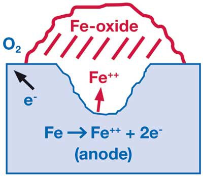

Ford Hallam Posted March 4, 2014 Report Posted March 4, 2014 You're welcome Mariusz Always happy to help explain technical aspects to those who care to learn. And here's a helpful diagram Quote

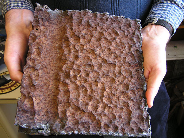

Ken-Hawaii Posted March 26, 2014 Report Posted March 26, 2014 Quote It shows well the sort of textural development that severe corrosion results in. As an aside, that surface looks a whole lot like several meteorites I have. But I guess ablation is rather an advanced form of "corrosion".... Ken Quote
