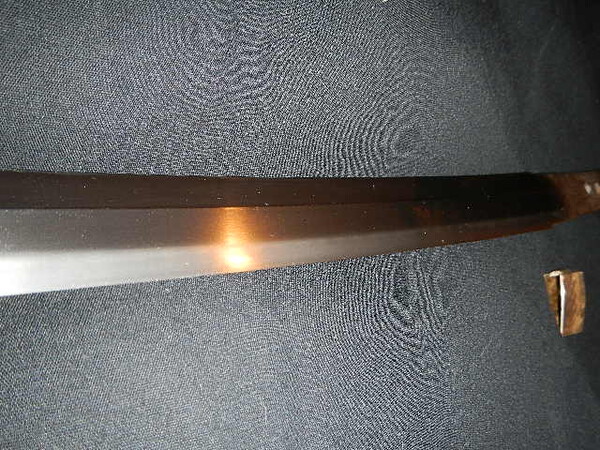

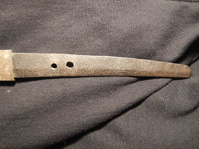

obiwanknabbe Posted February 27, 2014 Report Posted February 27, 2014 Hi everyone, I respectfully ask the community for some assistance on a translation here. It is rather badly corroded in spots but I have done my best to highlight the mei that remains. I think It begins with Jitsu ????? Tsuki ??? Dai ????Moto/Mori? The rest is beyond me. The blade from what I can tell, is a Tachi in rather spectacular condition. The Nagasa is 27 1/4 inches (69.215 cm). The Sori is approximately 2 inchs (5.08 cm). The mei is cut on the nagako so that the edge would be facing down if the signature were to face out (tachi mei?). It has a rather tight gunome hamon which i tried to pick up in the pictures and the hada appears to be very very tight itame. The seppa are all well fitted. Some appear to be made of silver. The habaki also appears to be silver and is in cat scratch motif. So a few questions. First, any idea who this smith is? 2nd, This blade belongs to a friend of mine, who wishes to sell it, but he and I have no idea what a reasonable price should be. Fair ballpark figures? 3rd, Any idea what the carvings on the top of the tsuba say? TAME ???? Was this the owners name or an assembly mark? 4th, Am i correct in concluding that the Mon on the tsuka is that of the Ito samurai clan? Thanks again for all you guys do. Kurt.k Quote
k morita Posted February 27, 2014 Report Posted February 27, 2014 Hi, Maybe gimei. 伯耆國大原真守作 (Hōki no kuni,Ōhara Sanemori saku). Quote
cabowen Posted February 27, 2014 Report Posted February 27, 2014 scratched kanji on the guard might be the owner's name, Shiroi Sanemitsu 白井真光 Quote

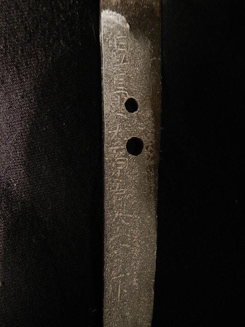

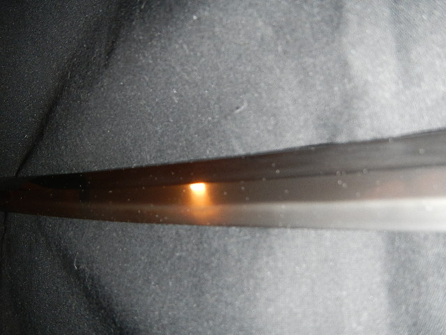

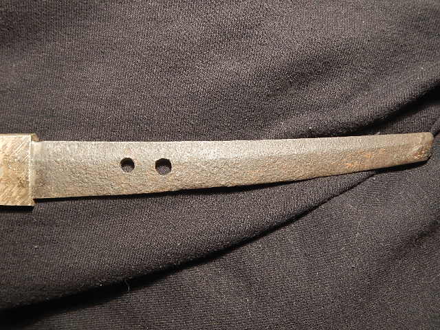

obiwanknabbe Posted February 27, 2014 Author Report Posted February 27, 2014 You guys are the best! Is gimei common on blades of this age? The Nagako on this is really old looking. Here are some pics without the chalk powder. Perhaps this will help. Even if it is Gimei, its is likely really old gimei. Can you gentlemen suggest what he should be asking for it? There are zero flaws. Kurt.k Quote
runagmc Posted February 27, 2014 Report Posted February 27, 2014 Kurt, just so you know, rusting a new nakago is not difficult... so, it's not always an accurate way to gauge age, especially if a person doesn't have lots of experience in recognizing all the factors which can point to a 1000-year-old sword... OR... a newer sword which has been purposely "aged"... False aging is often done purposely to decieve... just like false signatures... On the plus side, the sugata looks nice and the polish looks OK (although the hadori isn't doing the sword any favors, IMO)... Quote

obiwanknabbe Posted February 27, 2014 Author Report Posted February 27, 2014 mariuszk, Your correct, the sori is 2cm, not 2 inchs. Yesterday was a long day. As for "hadamono", what exactly do you mean? Hada is visible in hand, just hard to photograph. Its very tightly packed. I don't have an SLR camera so I have a hard time getting it to focus on reflective material. Looking really close at it in natural sunlight, i am noticing some very tiny evidence of Nie Deki along the hamon (at least to my novice eyes). The surface is a little cloudy so it makes being certain difficult. I found this article lat night and some of what it said seems to apply. Honestly there were some terms that im not quite sure how to relate to the sword in question. http://www.touken.or.jp/english/translation/630.htm. Should I just buy this off of him? He wants it gone (as the $ is needed elsewhere) and I have a few spare bucks (not something I get to say often) and i like it. Assuming its Gimei. Whats fair? Kurt.k Quote
