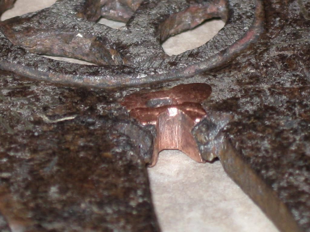

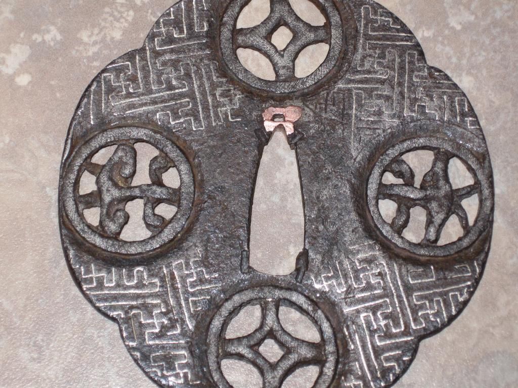

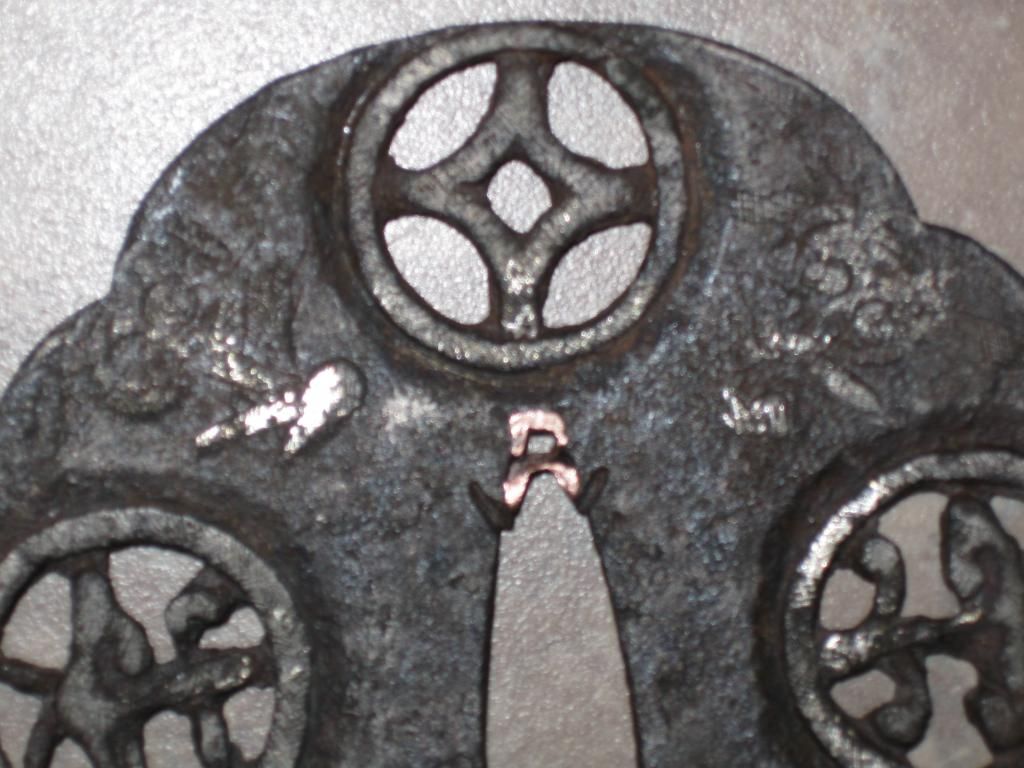

I found this at a curio shop while vacationing with my wife over the weekend in a completely unlikely spot. I bought as a memento of the trip and not a serious investment. It is quite rough, is it real? I saw the sekigane and took a chance. Any info would be very interesting! Thank you!

Sorry for the poor pics, my camera does bad close-ups.

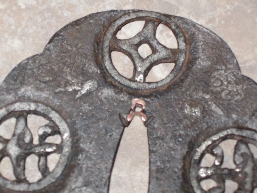

IMHO it certainly could be an authentic tsuba compared to many I have seen 0 may look better with a light cleaning to remove some of the dust and surface junk BUT not with anything caustic or abrasive. It may appear thin compared to what one would expect but hard to tell from the picture.
There are Many experts who will give you a much better idea than I .
It's an authentic Edo-period tsuba, but in poor condition. It looks like it has been in a fire, but it could just be the photos...
Hoanh

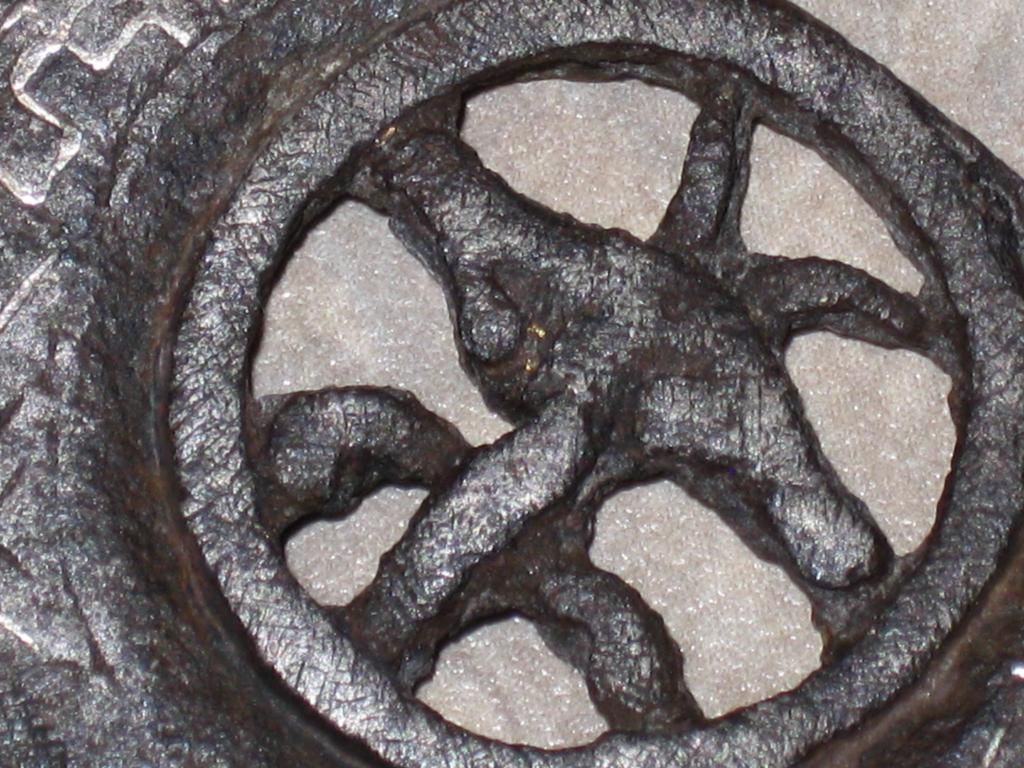

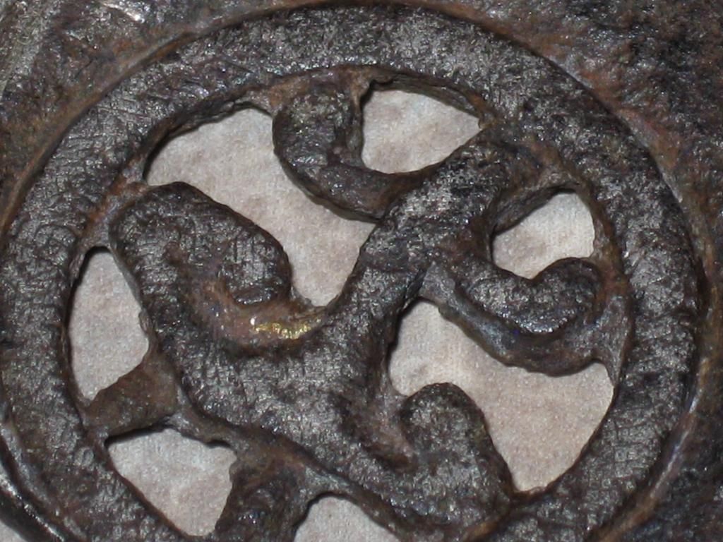

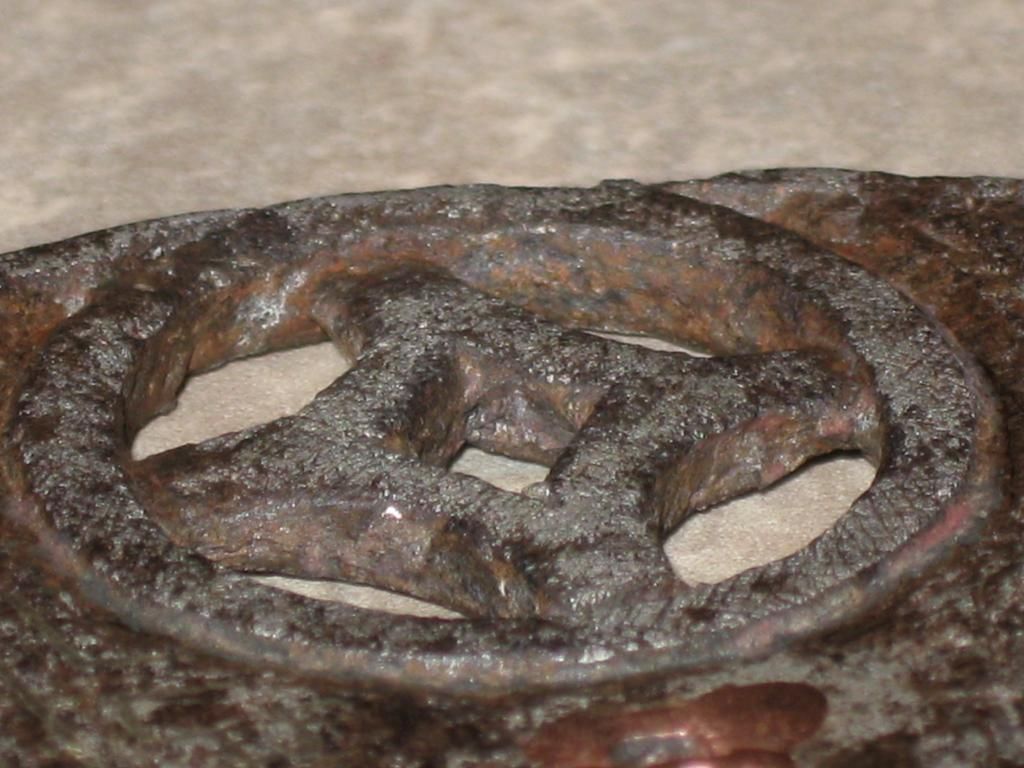

Jim,
we should have stayed with the out-of-focus-photos :glee: because now it's clear that at least the MON are cast. However, there is a chance that the basic TSUBA plate might be an authentic one, having been 'upgraded'. I don't think the TSUBA's value was in fact increased by that measure, so depending on what you paid, it remains probably a souvenir, not an investment.

There is too much work for this to be modern, or a repro.
The mon do look added later. I would say an honest old tsuba that had the mon added later. But still a perfectly representative example of a genuine tsuba, and a lot better than some of the junk we see. I don't think you have anything to regret here. Some nice inlay and a tsuba with a few hundred years on it.

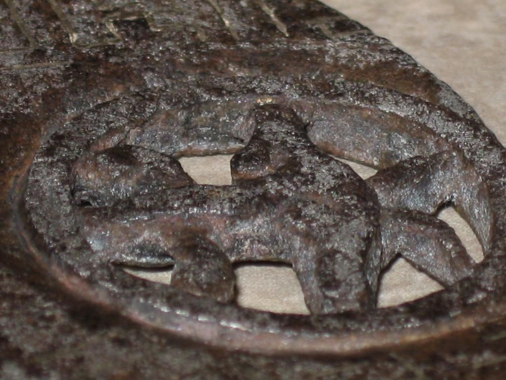

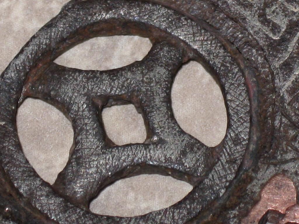

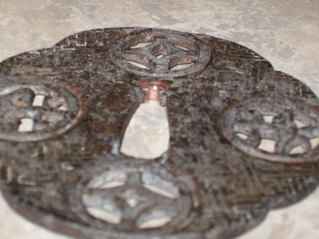

I looked carefully at the tsuba today and decided that it was grime inside the mons which made it look cast. I borrowed a camera from work which works better and cleaned it up more.
Jim Duell
