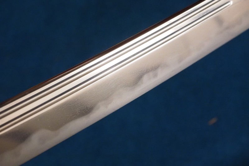

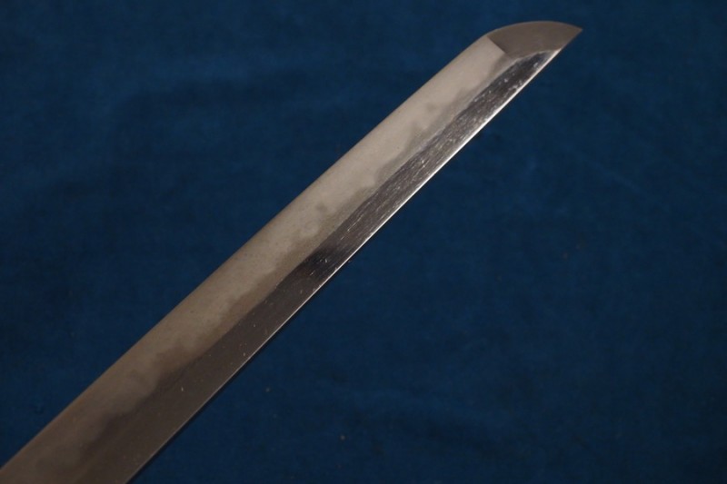

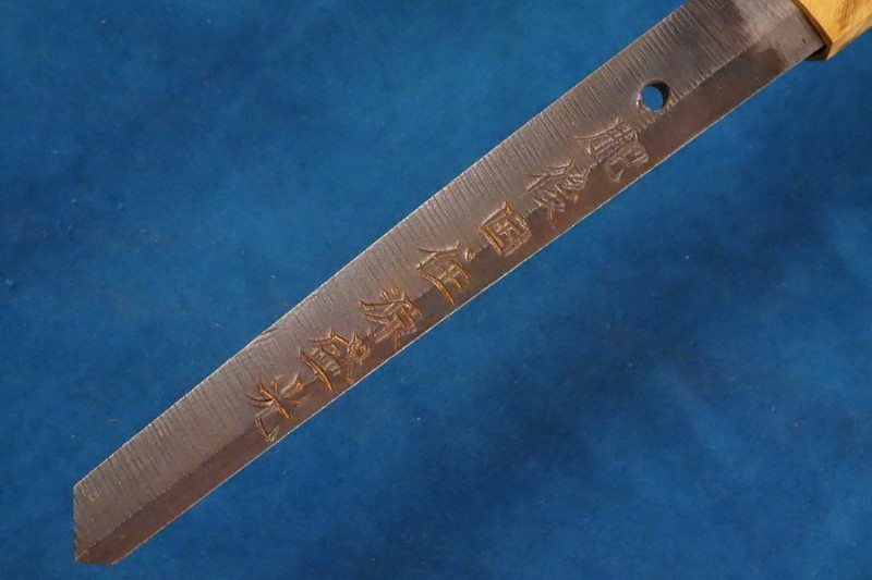

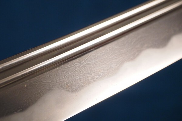

Forgive my ignorance if I am using the wrong term. The owner thinks this blade is Edo period, but I think it is a post WWII Gendai blade or a fake. I think the date is Showa but my Japanese is limited to looking up characters on the web. If I read it right, smiths name is MORI MITSU. The hada aqnd hamon look pretty good but I am not so sure....what do you gentlemen think?
Regards
Sean

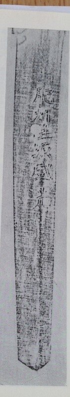

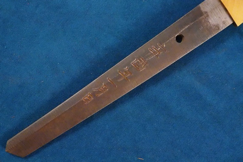

Yes Showa period, Higo no Kuni Minamoto Morimitsu, Terada Yoshimitsu from Kumamoto born 1910 worked from 1926 to 1989. John
Oh, I forgot Kanoto Tori nen, 1981 or 1921, so, must be 1981 J
