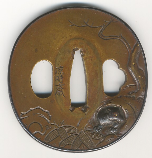

Hello,
another tsuba i just purchased. Kanjis in signature look like being KIYO (Kei?) HARU + Kakihan.
But I do not see any Kiyo Haru with such kanjis in Haynes nor in Shosankenshu or in Markus Sesko's Genealogy.
Does someone has ideas on school ? Thank you for help.
Bruno -
A lot of folks will be away from their computers on the way to Tampa. Think about how signatures work. They follow basic rules. For three character signatures on swords one expects to see "saku" or "tsukuru" as the the third kanji and the first two by elimination are the smiths name. On fittings this is a good place to start, but we also have to add the frequent use of kao. Sometimes three characters are actually two kanji with a kao. Unlike in swords, fittings artists often use "art names", inspired by the practice of lay-priests and scholars. These names are often rendered with Chinese readings. A common character used is 齋(SAI)  denoting an old man or scholar. I think your three characters are;
涼晴齋

Hi NMB friends,
10 years later I still do not have any real answer to this signature translation... 涼晴齋 is definitively not Kiyo Haru Sai but should someone can help me, I would  highly appreciate.
Thank you for your help
