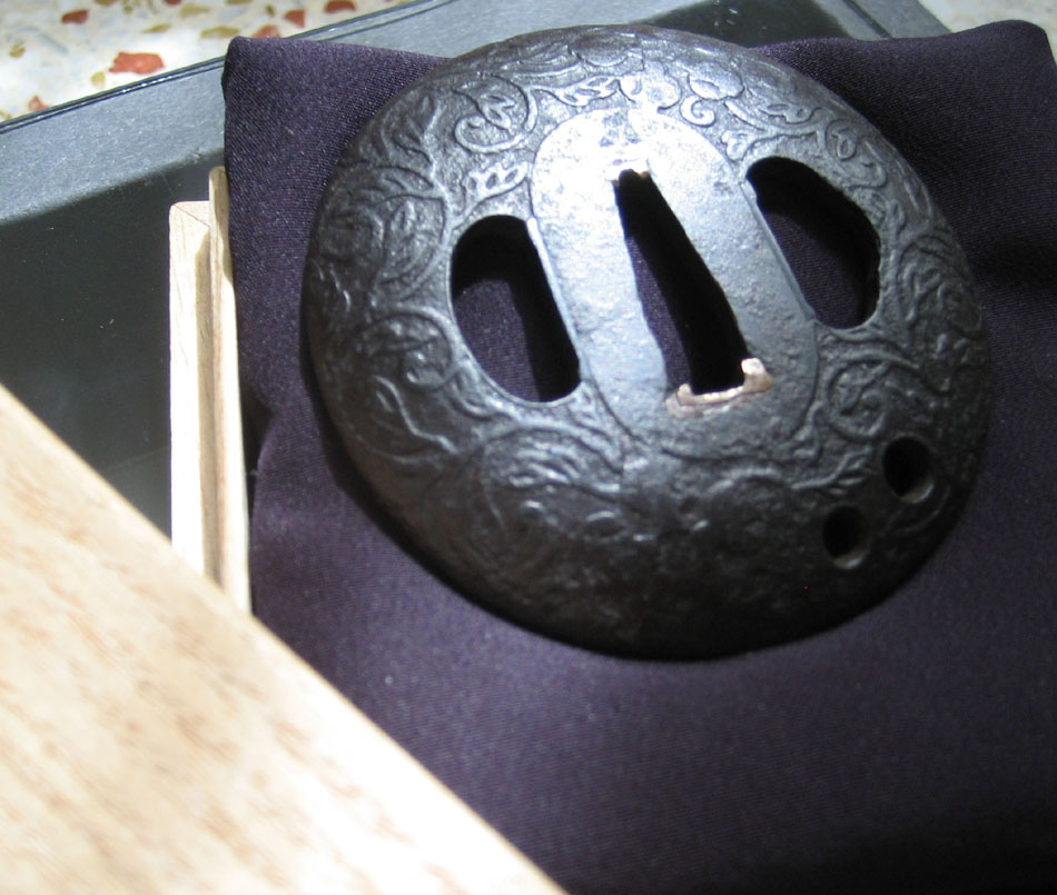

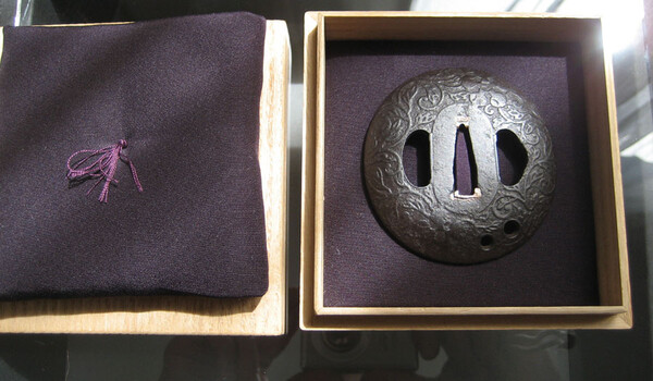

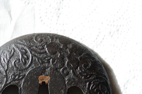

Jean Posted February 16, 2014 Report Posted February 16, 2014 Is it a style (does not look western style)? Is it the steel? Are all cupped tsuba Namban and why? Is namban word used only for western influence?... A picture of a tsuba I recently got with its description, is it namban: Waterwheel mon and Vines design. 7.25cm x 6.95cm x 0.9cm in bowl depth. This guard is cupped in the European style, but made to be work cup down over the saya. The kozuka and kogai ana are set with thin very fine shakudo inserts. The design has been done by use of lacquer and acid to create an acid relief design of Vine tendrils and two mon of 5 cup circular waterwheels. The workmanship is phenomenally crisp and so is its state of preservation. Family mon on it, which is almost unheard of for Hizen. The iron is also much better than 99% of Namban tsuba, In hand, the iron felt very similar to Yagami work Quote
Peter Bleed Posted February 16, 2014 Report Posted February 16, 2014 Jean, As a recovering Namban collector, let me thank you for asking what I think is an interesting question. Of the options you provided, I would have to say it is a “style”, but that description doesn’t help us understand the category we consider “Nanban.” I have come to the conclusion that is best to think of Namban as a FAD that swept across Japan in the late 18th century. At that time, Japanese fashion-setters decided that there were a series of motifs that looked exotic and, therefore, fashionable. These included things like beaded mimi, fancy seppa-dai, maybe a couple of Latin (looking) letters, and other designs that did not look “Japanese.” Rich guys could buy well-crafted examples of this stuff, and then the masses would buy cranked out versions the same stuff. Namban was marketing device that satisfied that fashion interest. Skilled kinko masters may have responded to the fad with master works. Those might be collectible, but at base Namban is the Middle Edo period version of Hello Kitty. Peter Quote

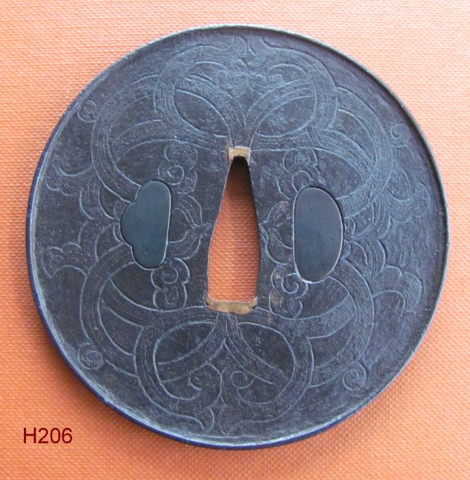

Jean Posted February 16, 2014 Author Report Posted February 16, 2014 Thanks Curran for posting these pictures, but apart this tsuba, can anyone answer my other questions, which could be sum up like: - are all the tsuba featuring south Barbarian design are namban? (I just realize that this was the basic question to ask) - if not, what are the features of a namban tsuba or what makes a tsuba a namban one? Quote

Jean Posted February 17, 2014 Author Report Posted February 17, 2014 So John, what do you think of the tsuba I have posted: Pro-namban: cupped, vines designs Cons-namban: hitsu ana with shakudo inserts contemporanous, waterwheel mon, lacquer and etching work. Quote

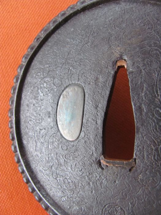

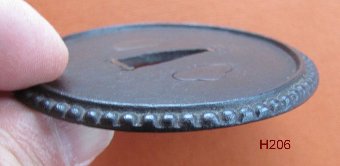

Lance Posted February 17, 2014 Report Posted February 17, 2014 I've often seen these tsuba with this type of relief and cupped shape referred to as Hizen tsuba rather than Namban (although Hizen tsuba term can sometimes be synonymous with Namban) quick link and pics of another example for reference from another member's site, hope he doesn't mind. http://www.legacyswords.com/fs_ant_tsuba7.htm Regards, Lance Quote

Jean Posted February 17, 2014 Author Report Posted February 17, 2014 Very interesting tsuba posted by Lance from Ted T. site. Both sides are decorated unlike mine. Quote
Curran Posted February 17, 2014 Report Posted February 17, 2014 I was logging on to thank Lance for posting the link. It was good to see the NBTHK papers for the set to Hizen. The similarity to Jean's is considerable. The Tenold one needs some rust control / preservation, but the iron on these can be a devil to work carefully. Probably best to just give it the horse hair brushing now and then. Seeing it with matching f/k also supports my gut instinct belief that these might have been ordered sets to do personal en-quite koshirae. I suspect there is a matching f/k for Jean's out there in the world, possibly in its own box. Hopefully in the same state of preservation. Jean's is remarkable because the state of preservation is extremely high. It is so clean and well cared for that, that you could eat off it. One of the recent changes with NBTHK seems to be stricter standards on condition. From 2013: in addition to making Tokubetsu Hozon mandatory for Juyo submissions and raising fees a bit, they also seem to be saying now that they will not paper unsigned fittings unless state of preservation is at least "X". Ie. things that could have gotten Tokubetsu Hozon in the 1990s now won't make Hozon if not preserved to some arbitrary standard. I saw an example of this over the weekend that stunned me a bit. Quote

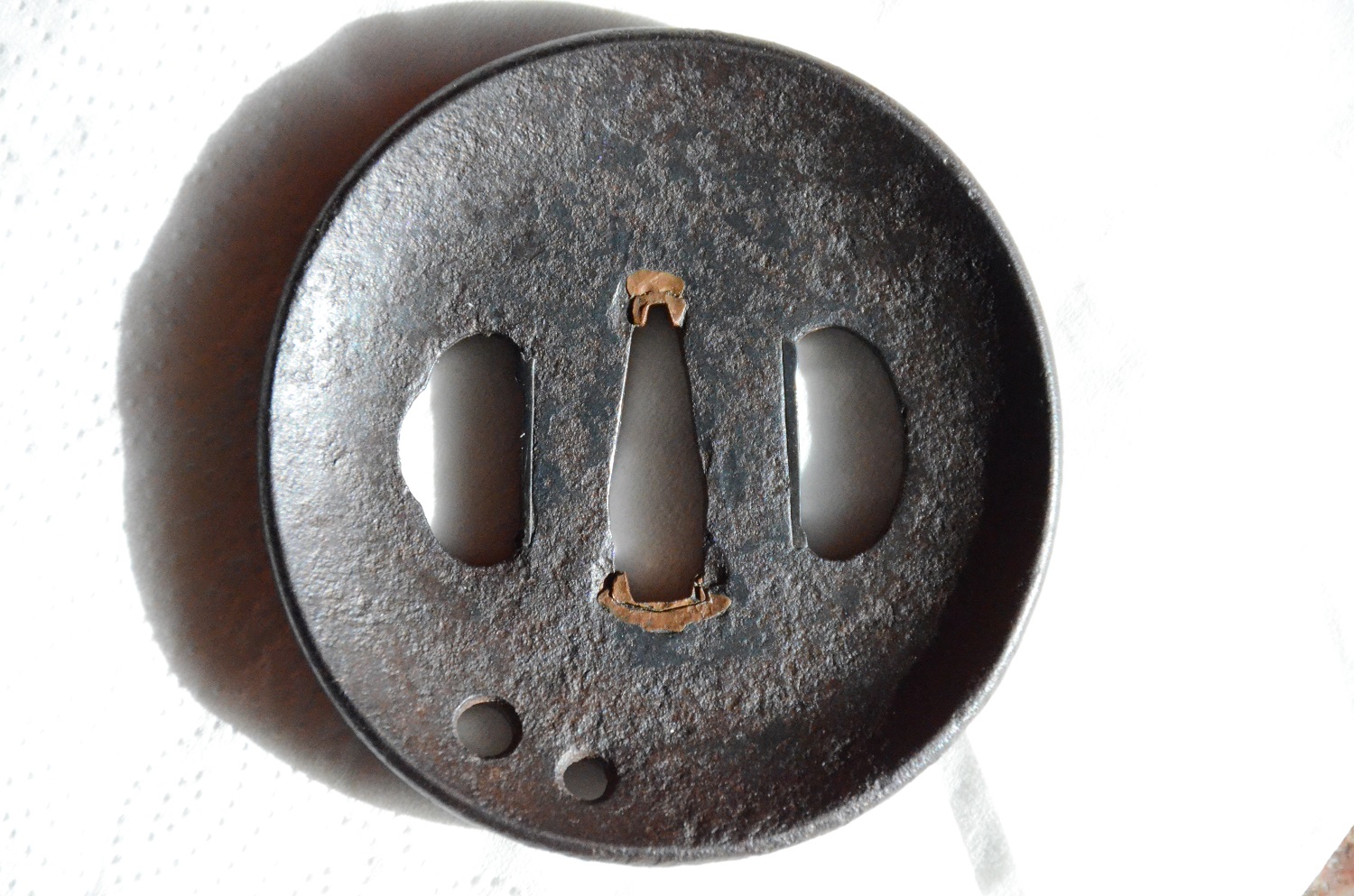

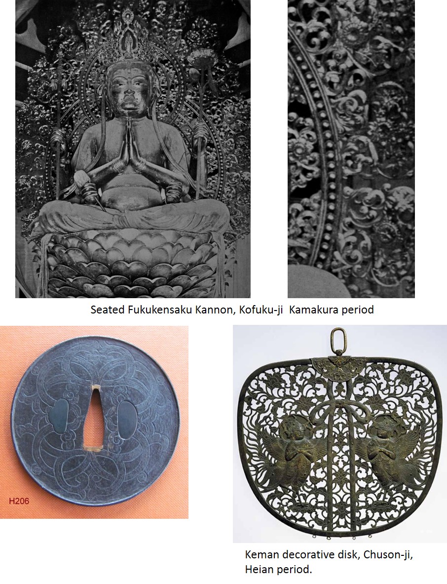

hxv Posted February 18, 2014 Report Posted February 18, 2014 Gentlemen, Going by the thread's thesis "What are namban tsuba," may I ask your take on the following tsuba, which was originally for sale on Grey's website? I hope Grey does not mind my using his pictures for educational purposes. Your candid thoughts are much appreciated. Regards, Hoanh Quote
Peter Bleed Posted February 18, 2014 Report Posted February 18, 2014 This remains an interesting thread. I continue to be convinced that MOST of what are counted as "Namban tsuba" are mish-mash creations of stock motifs that reflect the Rampeki or "Hollandamania" of the late 18th century. That fad was a popular phenomenon of mass culture. As Ford points out, there was another - earlier - interest in foreign materials that occurred in the earliest Edo period among the Daimyo elite. Christian motifs showed up at that time, but INHO European sword fittings were rarely copied into Japan at this time. Namban portrayals of this era show European carrying swepthilt rapier. Bilobed and cup guards that inform many "Namban tsuba" date from the 18th century. There were, of course, Continental military campaigns going on as the Momoyama era was passing, so I think it is not surprising that "Chinese" guards were repurposed by Japanese soldiers. All of those things get conflated as "Namban." I hope we can continue this conversation in Tampa. Peter Quote

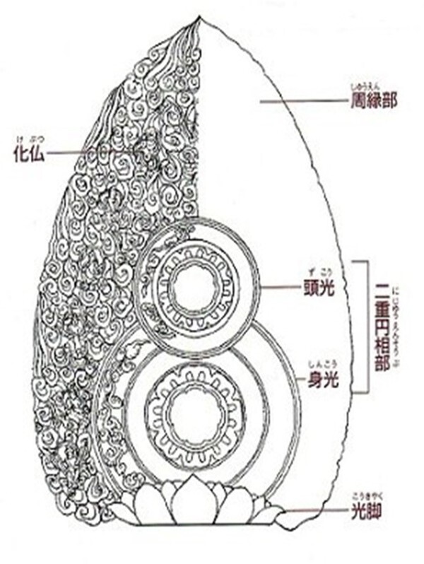

Henry Wilson Posted February 19, 2014 Report Posted February 19, 2014 Hi Hoanh Interesting tsuba. Some candid thoughts below. I notice a passing similarity to the double ring halo 二重円相光 seen on many Buddhist statues starting from around the end of the Nara period. The double round halo, represents the light emitted by the Buddha, as emphasized by the rays surrounding the lotus cushion on which the head and body rests. This tsuba seems perfectly round and the execution of the beads and the vine style carving brings to mind detail of statues such as the Dainichi Nyorai in Enjo-ji in Nara. Incidently, the halo also reminds me of old mirrors and some Kagamishi tsuba. However the beads on the tsuba are probably rosary beads called nenju 念珠 and are used for Buddhist prayer and invocation. They are usually associated with a chant called 'shoumyou nenbutsu‘ The number and shape of the beads varies in different representations of it and are usually found as attributes to the Thousand-armed Kannon and other Buddhist deities. If we look at the Seated Fukukensaku Kannon in Kofuku-ji in Nara, there is a similarity between the halo and the vine work seen on the other tsuba. Vine work is believed to have arrived in China with Buddhism via the Silk Road and is very commonly seen in Buddhist art work. During the Tang dynasty, floral patterns set on vines quickly became a popular motif and the weaving of the vine represents an unbroken and never-ending wish as well as completeness. Experts differ on the origin of the vine. Some believe it originated from the Greeks, a style developed by their architects and it travelled from the Mediterranean via central Asia. Others believe that a honeysuckle vine pattern entered China via India. It probably entered Japan along with Buddhism and there is also stylistically a similarity to some Ezo fittings which could have originated in the Kyoto (Kinai) area, but that is another story. I hope this information helps and is of interest. Quote
Soshin Posted February 19, 2014 Report Posted February 19, 2014 Hi Hoanh Interesting tsuba. Some candid thoughts below. I notice a passing similarity to the double ring halo 二重円相光 seen on many Buddhist statues starting from around the end of the Nara period. The double round halo, represents the light emitted by the Buddha, as emphasized by the rays surrounding the lotus cushion on which the head and body rests. This tsuba seems perfectly round and the execution of the beads and the vine style carving brings to mind detail of statues such as the Dainichi Nyorai in Enjo-ji in Nara. Incidently, the halo also reminds me of old mirrors and some Kagamishi tsuba. However the beads on the tsuba are probably rosary beads called nenju 念珠 and are used for Buddhist prayer and invocation. They are usually associated with a chant called 'shoumyou nenbutsu‘ The number and shape of the beads varies in different representations of it and are usually found as attributes to the Thousand-armed Kannon and other Buddhist deities. Hi Henry W., Very interesting write up about the tsuba Hoanh posted. Only one minor point I can think of given my knowledge and that is Kannon is not a Buddhist deity (ten 天) but a Buddhist enlightenment being (bosatsu 菩薩). The double ring halo I don't see around images of Buddhist deities or the Buddhist demigods (Ashura 阿修羅). I was more than a bit upset to see this tsuba sold so quickly off of Grey's website before I was able to purchase it myself. Does makes me wonder who the new owner is as these type of early Nanban style tsuba with interesting Buddhist symbology don't come along often for sale. Quote
Henry Wilson Posted February 19, 2014 Report Posted February 19, 2014 Thanks David. Call it a holy slip of the toungue... Quote
