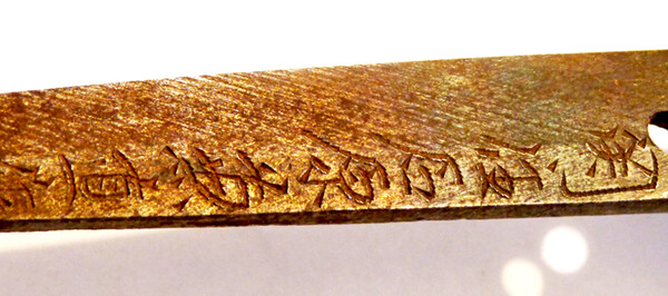

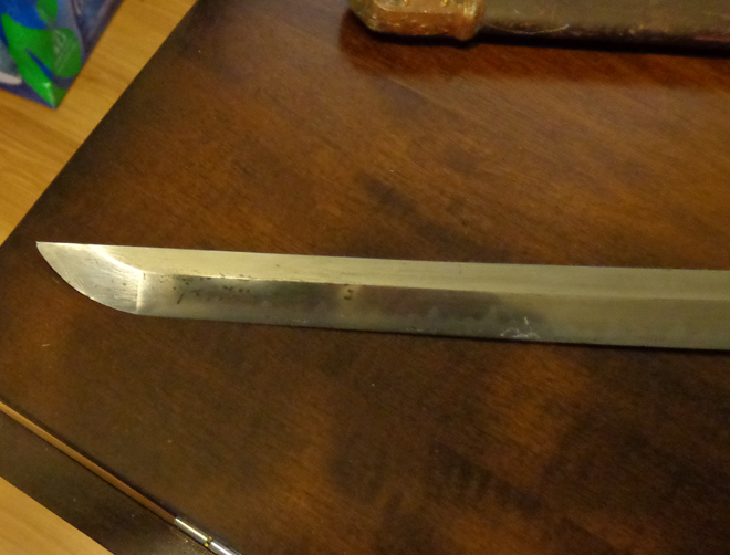

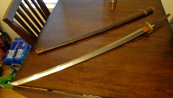

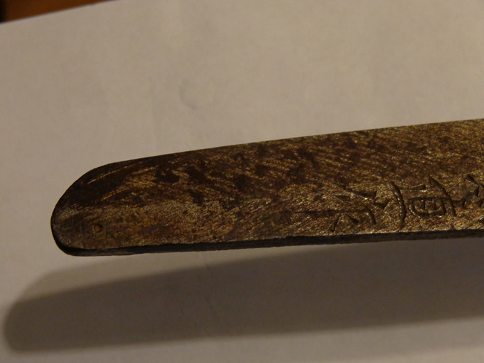

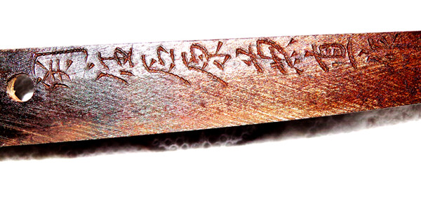

I was guided here by some folks who said, "if they don't know, no one will". A pal of mine has this sword which he inherited from a Grandfather which was acquired in WWII. He is very interested in getting it identified; specifically, what does the markings on the tang say or translate to. Basically, all the info he can get on the this sword. He suspects it isn't militay issue and is under the impression that it may be a "familiy sword". If thats the case, he'd like to return it (though research seems to show that this is next to impossible to do...but worth a try). So long story short...any ideas on the make (maker) of this sword?
The signature translates to 'Seki ju Ishihara Kanenao Saku'. It is not an older family blade, but did belong to a Japanese officer. It was made during the war era by a swordsmith in Seki, an area responsible for many of the swords supplied to Japanese officers. Typically, these swords were of lower quality, however they were handmade.
