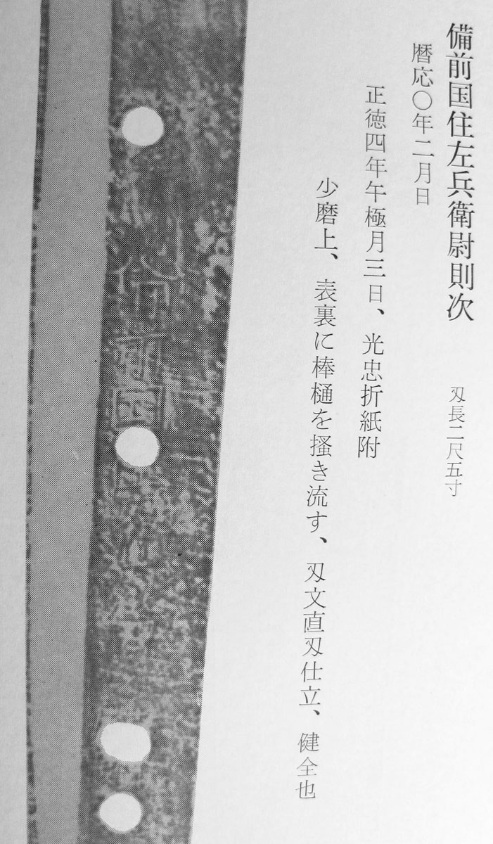

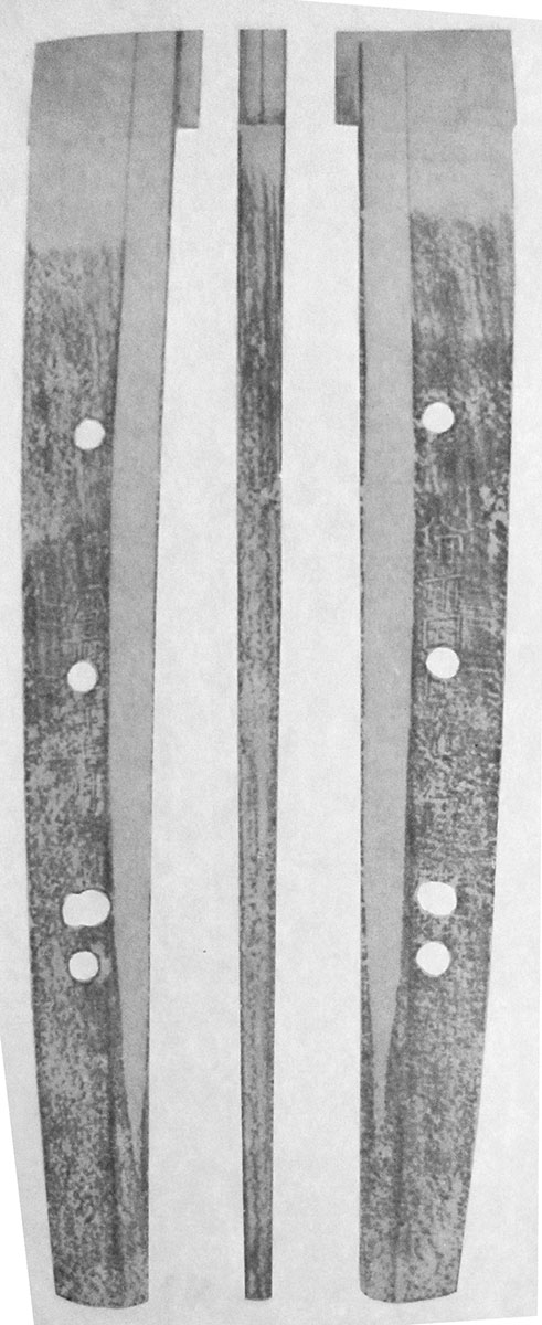

Grey Doffin Posted January 23, 2014 Report Posted January 23, 2014 It isn't unusual at all that an unknown smith would be chosen for gimei. If you choose to do a gimei of Bizen Nagamitsu your customers will be wary and they'll have many oshigata to compare with. Choose Nagatsugu and guards will be down and few oshigata for comparison will be available. Once the sun is out, Gabriel, I'll send you the photos you asked for. Grey Quote
Gabriel L Posted January 23, 2014 Author Report Posted January 23, 2014 Thank you Grey, both for the comments and for the image from the Bizen Den Taikan, which I am attaching below (with minor image editing for clarity). Quote
